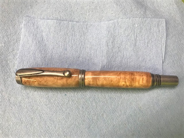

Today my shop is at 51% humidity and I noticed a difference in how the Gluboost was to apply. First since the shop was also warm it flowed much easier so I had to be careful to not apply too much. It seemed to take longer to dry so I waited longer between coats. What is the best temperature and humidity to apply Gluboost?

Thanks, as I was working with it I noticed a difference in viscosity and drying time compared to winter time in my heated, dry shop, so I wondered what the parameters were when using Gluboost. I was happy with the finish. Thanks for the information, my shop can exceed Jr. George Antique Finish Mystery Wood.jpg the 50 % humidity if I don't have the air on.
