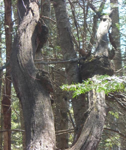

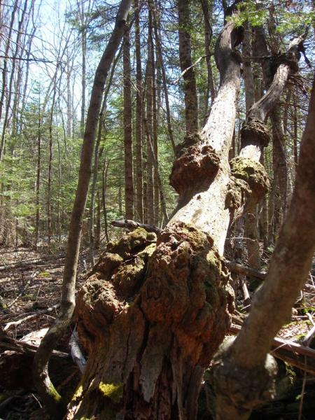

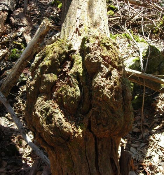

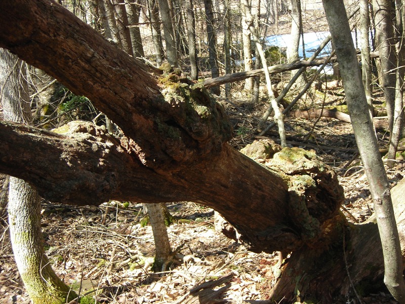

Well here are the pics. The biggest burl is a little over 24" in diameter (this is the one on the lower trunk. As you can see there are 7 more burls on the tree. Most are about 12" is diameter so the cactus juice while it is a great product I am sure, will not work in this situation. I did take a hand saw to it and it is pretty solid, however I would feel more comfortable trying to soak them in a hardening solution. I would like to try to keep them as whole as possible as I am looking to turn a few more lamps this year.
Thanks for the help so far, keep them coming!

The important thing here is the tree is far from green. As you see in the pics, it is a downed tree, any moisture that is currently in it is due to the melting snow from this past winter.

Well, well, what have we got here...! yummies, yummies...!:eek::biggrin:
Before I saw the pics, and reading your OP I though to myself, how big is this fellows' backyard...??? chezzz it has to be of considerable size for him to need to mark a trail back to the spot...!:eek::wink:
What a nice little "jungle" you got there mate, I would be in paradise, in there...!:wink: shame that I'm so far away...!:frown::mad::)
Now, and from what I see and what you said, the wood is old, wet and full of moss/fungi that will influence what's going to happen in a near future with it.
Apart from being cut from the tree, those burls need to be cut properly to give you as much chance as possible to make it usable when the time is right. There are a few different things that you could do to them, some more complicated and expensive others more doable and at this stage/moment, if I was there or if they were mine, I would do the following;
*- Cut the burls that are pretty much all around the tree with about 3" of wood/trunk on either side of the burl.
*- Any burls that are to one side of the tree, do the same thing, cut them as is the burl was all around with the same cut distance from the burl.
*- Take them to a cement slab area and water pressure wash them to remove dirt, moss and surface fungi.
*- The logs that have burl on one side, slice the log in half or so, removing the non burled wood.
*- Put them under cover for 24 to 48 hours.
*- Now that most of the water used to clean them has gone, use so exterior acrylic paint (any colour) to seal the full burled logs (both end grains), and the half logs with the burl still attached, paint the ends of the half log and the exposed wood from the log ripping in half. In general all fresh cut exposed wood should be sealed (painted).
*- Store them in a dry and away from weather location, this will allow the water inside the wood to slowly dry off, and reducing dramatically the rotten process some more advanced areas of decomposition my have. The wood that is still solid, will lose the excess water and will preserve well...!:wink:
Any possible stabilization or wood hardening work will be better done and achieved when you are ready to use each individual piece as is a good chance they will all have different decomposition and other stages, including pieces that will probably be needing no repair at all.
At this time, various processes and methods can be used but at this time, I would worry about preserving what you've got from further damage and what I suggested to you are the exact steps I would be taken in the wood/burls was/were mine...!:wink:

George, I own 3 acres of land with 2 acres of them forest. Surrounding me are 4 neighbors and forest...so I am not kidding in my signature that I am deep in the Maine woods. :biggrin: Oddly enough those burls were about 75 - 80 feet from the house, but it was dense enough for me to throw a couple of tags so I can spot it easily. I will leave you an open invite George, ya ever decide to travel half way around the globe you are welcome to come and play.:rolleyes::biggrin:
But that is great info, thanks a bunch! Tuesday I will be out playing and taking care of those. Stinks that my chain saw is still on loan for today and tomorrow it is going to rain:frown:
Loved the pictures!
After doing time in Maine(Lebanon) for my first 18years, I decided a much warmer climate was in order.... My hats off to you for digging in all that snow and swatting those black flies!!!
Any idea what kind of tree that used to be? Looks to be completely rotten....hope not, but it looks bad. Seemed to be the same problem I'd run into when looking for interesting wood while on vacation at the folks place..... The deep-dark-jungle-of-Maine eats trees pretty fast.
Scott (might be gone already....good luck) B

Thankfully the snow is mostly gone (although you saw a little in the last pic :redface:) and the black flies are not out...yet. But there is a lot of standing water around the property and I have a feeling they will be bad this year :frown::frown:
If I was to make a guess I am thinking this could be either maple or oak just because those are the species around it.

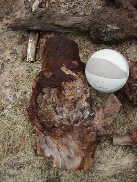

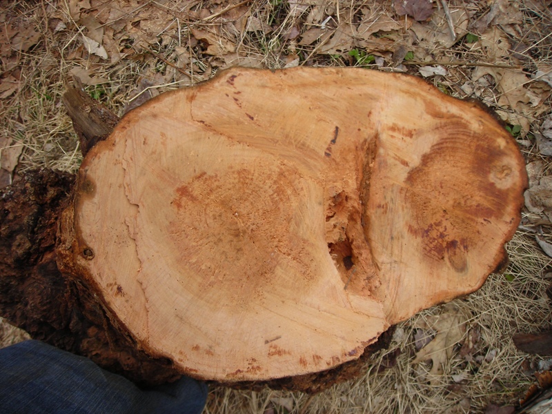

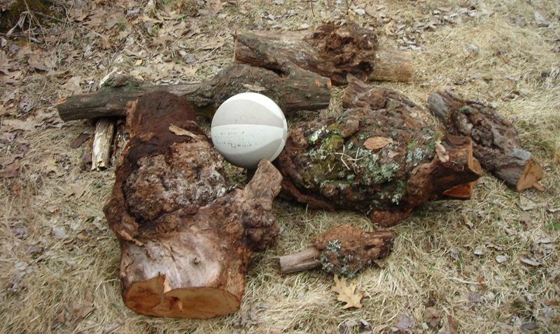

Was out playing after work!!
So as soon as I got home I decided to take the bow saw and lop off a few of the burls. I think I under stated the size, the biggest in this group measured as 46" around!!:eek: As you can see in the photos I put a basketball in there for reference.
Most of them seem like they are still good, the wood was nice and dry and hard. A couple was waterlogged, however I think once the water is out I think they could be salvaged.
Here are some eye candy.

robutacion
Aug 6, 2009
6,514
Australia - SA Adelaide Hills
Like I said, get a water pressure gun and clean all that moss, dirt and other stuff living in there, and let them dry for a day or so then paint those exposed fresh cut surfaces, you want the water that is inside the burl/wood (not from the washing) to come out SLOWLY, otherwise the wood may crack/stress a lot more with more cell separation than what you could have. Prevention, prevention...!
Even those pieces that you say/think are too far gone, are perfectly usable and in many cases will have colors and other things happening in the wood that are a lot more important as character and uniqueness than anything else you may have or see so, protect those pieces as if they were "treasures"...!:wink:
Get them all out of the humid jungle, and get to work mate...! actually, you already are and cutting all those pieces with a bow saw, you are either a strong fellow or you are totally mad...!:eek::wink::biggrin:
