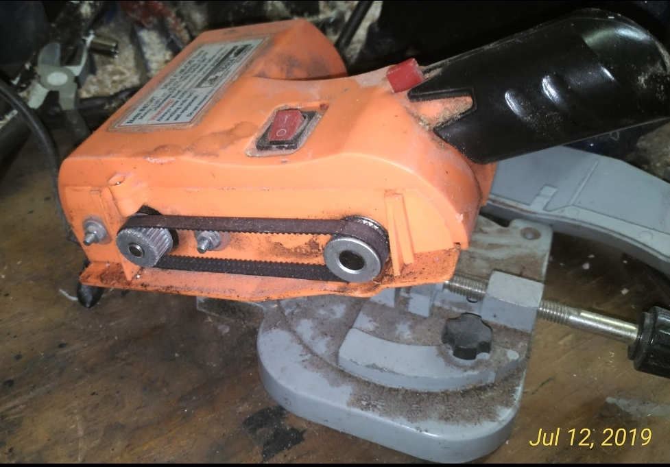

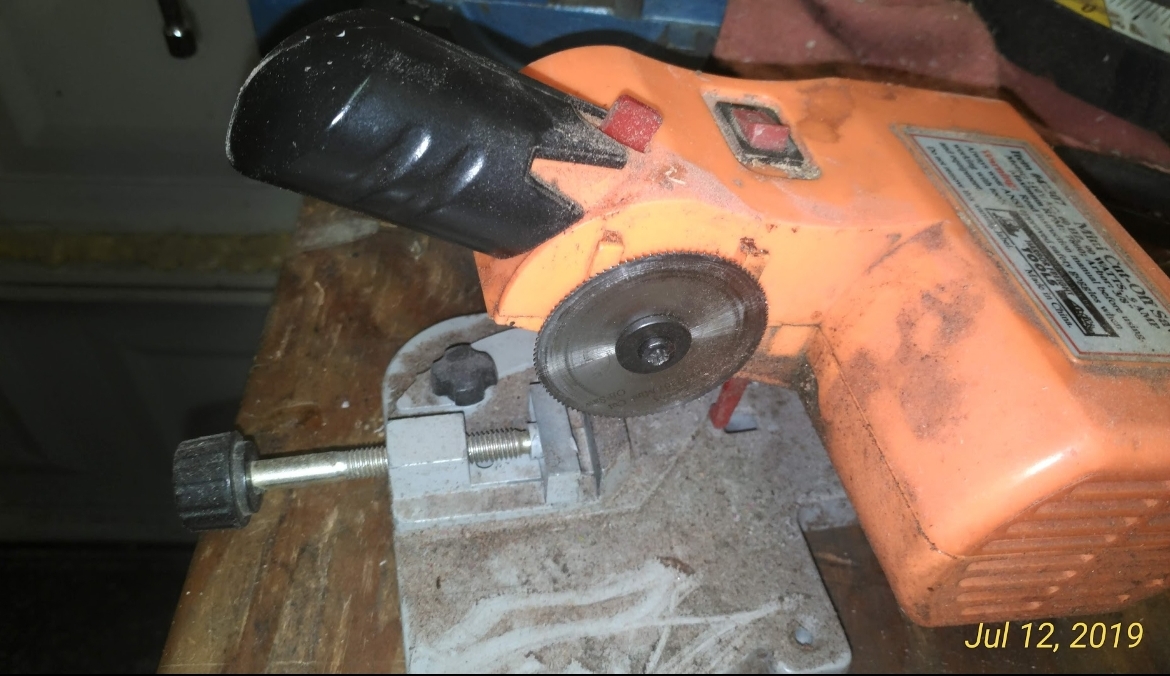

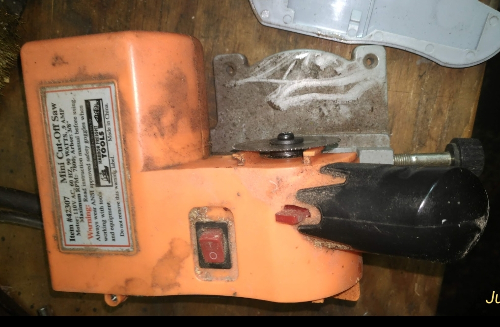

I have one of the mini harbor freight chop saws #42307. I'm hoping someone here could share with me how to remove the mini round cutting blade.. I have removed the cover over the blade, the cover on the opposite side where the belt & pulley are. There is a single screw holding the blade on but I have been unable to get it to budge even after multiple wd40 soaks. Without being certain if its right or left hand threading I'm abit afraid to torque down more than I already have, which was probably too much anyway. And I can't find anywhere to lock the blade to keep it from spinning so I've been using vice grips to hold the blade.
