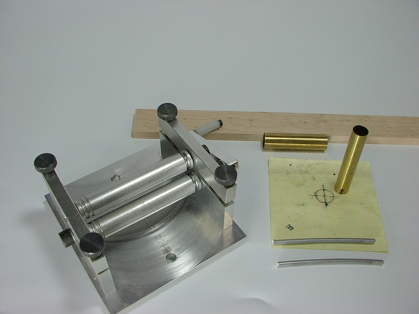

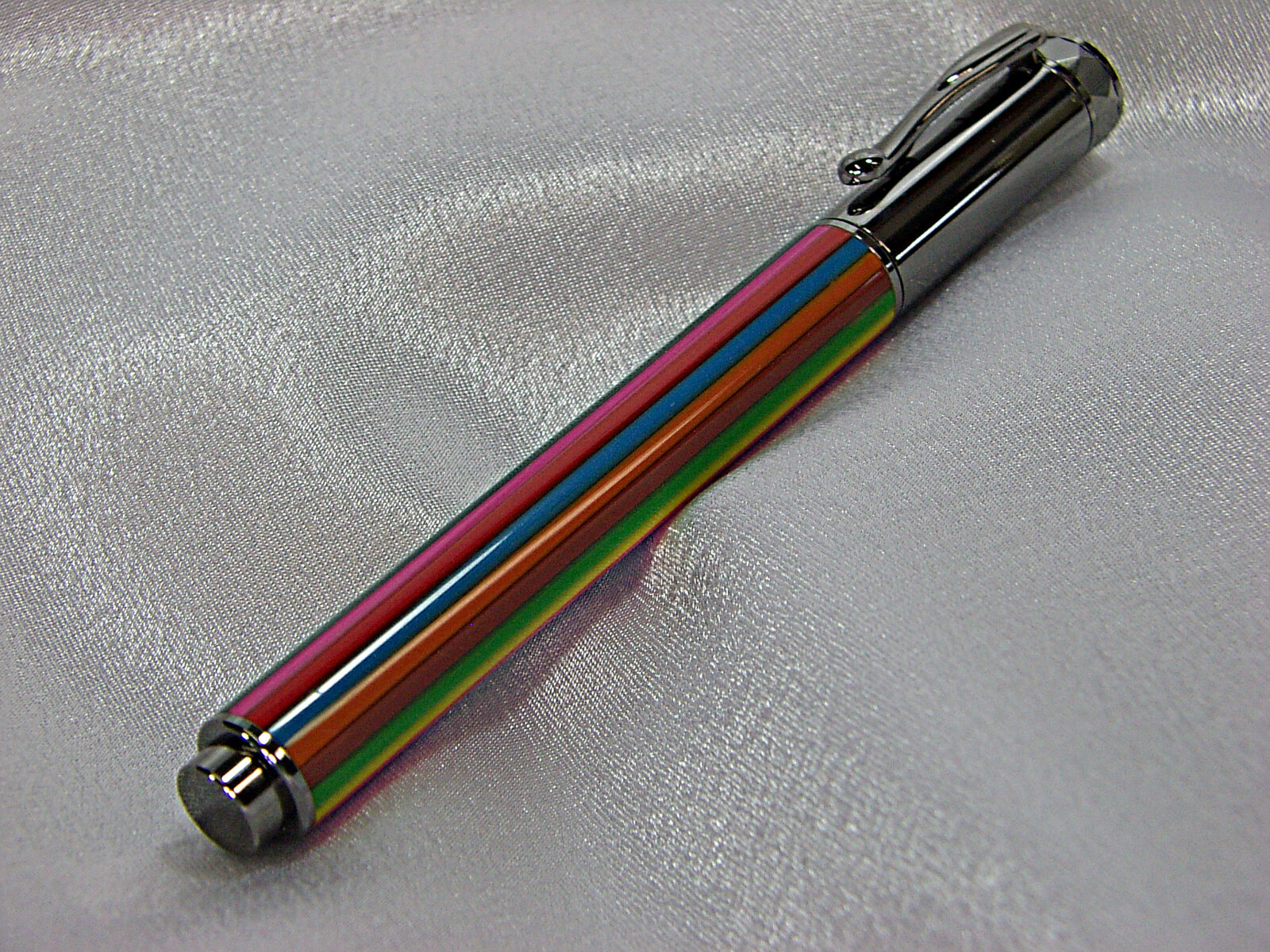

Being you want to do this length wise I will show you a quick way I mark tubes when I need a reference line down the lentgth of the tube. This can easily be used for this purpose. This is the crude version and I have since just made a jig that consists of 2 pieces of aluminum offset from each other and held together with some double stick tape. I do not have a photo of that but it is the same principle as the wood version I show in the photo. The wood needs to be true dimensioned. Thus the reason I switched to the aluminum. Just lay the tube ( transfer punch) next to the wood. I use double stick tape on the back of the wood or my other jig to hold it firmly to the table. Now push against the wood with the punch and use a scribe or a knife or a nail and run it down the length of the punch. You may have to do that a couple times but do not move the punch as it rests against the wood or aluminum. You will get a nice sharp clean line. Now paint the line. When I do tubes I just use a sharpie. I used this method when I made this colored pencil lead pen. I need to have the first lead straight. The all others pushed against the first and they all were now straight.
There are a couple other jigs in this photo for other types of tube configurations.
