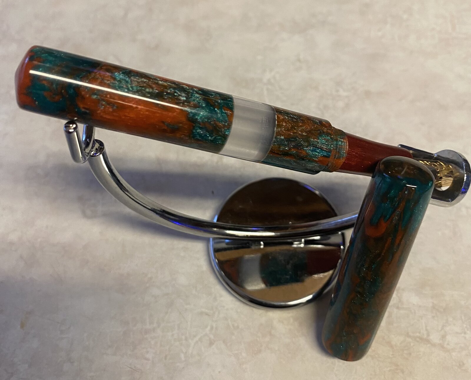

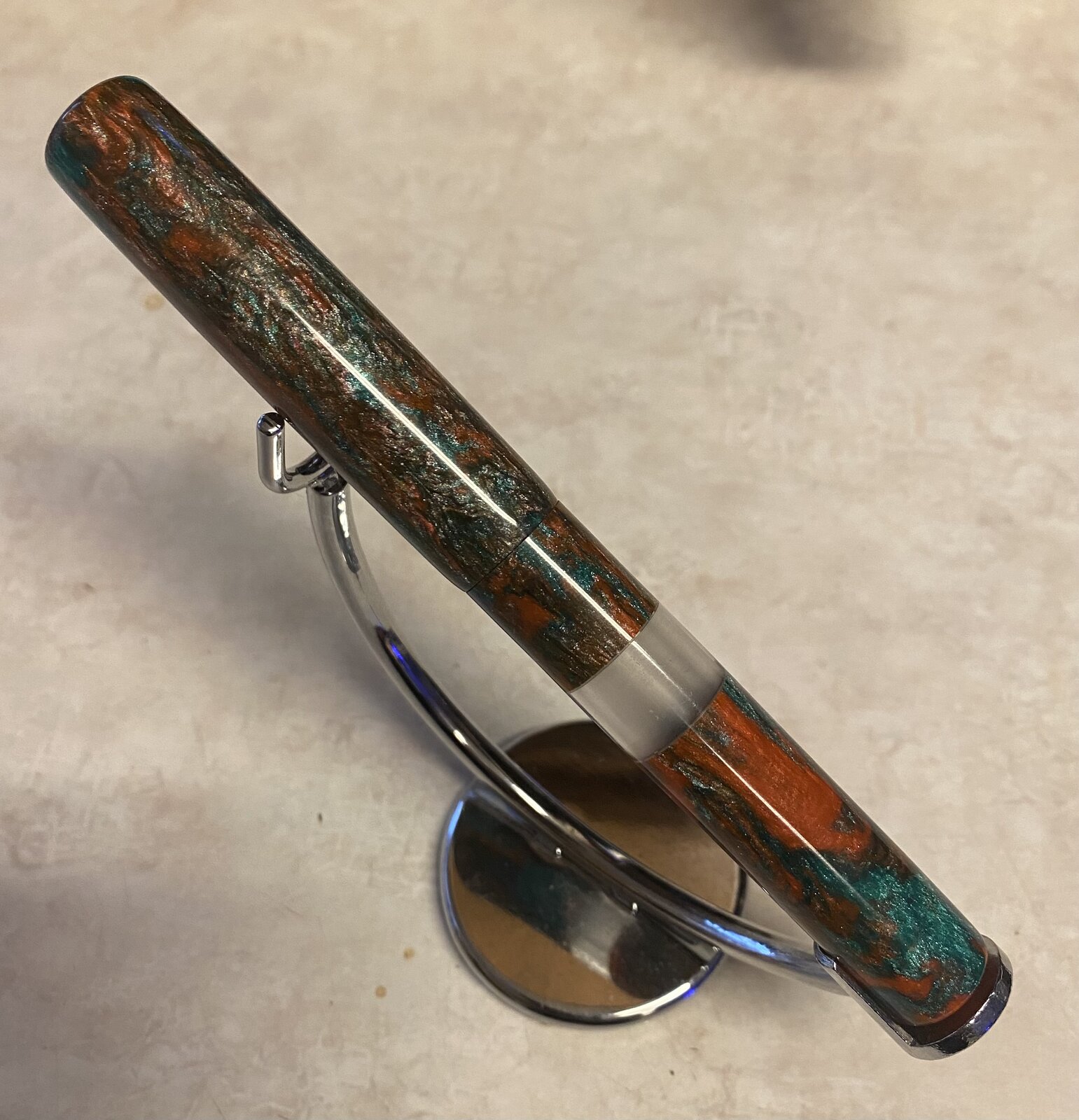

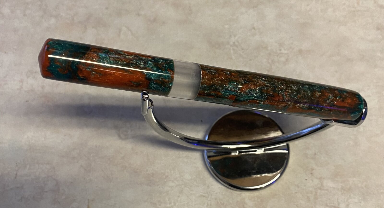

Thanks everyone for your advice. I need to work on polishing the inside.
I've had success with small diameter polishing bobs with 1/8" shanks. You can buy assortments from Amazon for cheap. I made a mandrel to hold them and use polishing compound.
