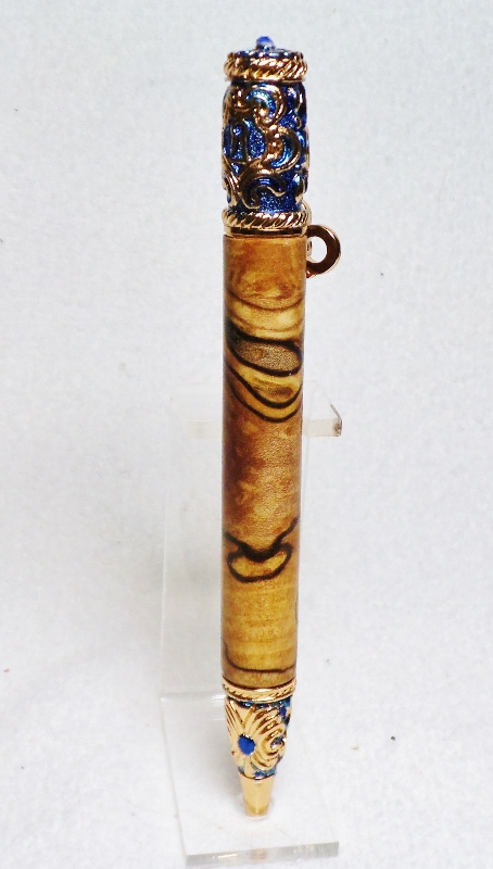

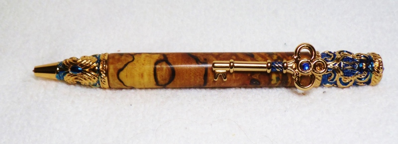

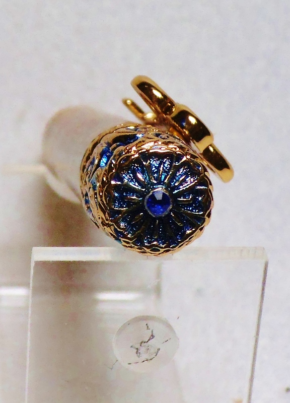

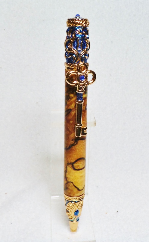

I needed a few upcomming birthday gifts for this month and wanted something a little different for the receiver's special tastes. This was one is for the Grandaughter who likes all things creapy. The basic kit is a PSI Skeketon Key in 24Kt Gold. The blank is a end cut Spalted Oak with CA finish. After putting the pen together, I liked the detail of the castings, but I was unhappy with the Large amount of Gold plateing. The antique Pewter and Antique Copper in these kits have black backgrounds, and it makes the design stand out. I used my 4 hair Sable brush and a little blue Alcohol dye to transfer the background color. I also added several Swarovski crystals to the top and key center. It didn't take much to turn a good kit into a one of a kind gift. To some of our newer members, don't always be satisfied with what you receive in the package !! Jim S

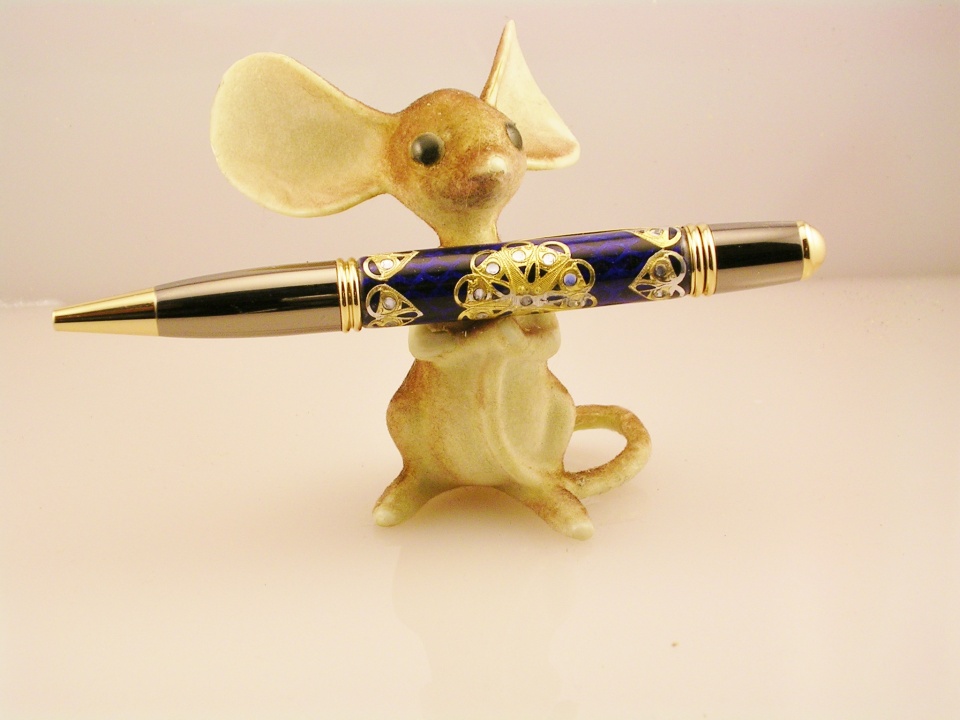

Thanks Bob. I do a lot of ornaments, candels, invitations, and anything that will stand still long enough for glue to dry on, so I order crystals in larger amounts of 1-5 or 10 gross packages ( that's one color one size per package) from Shine Art USA. There are a LARGE number of sizes, colors, and shapes just in crystals alone. My last order was over 11,000 in only two sizes and 4 colors to finish 2 ornaments I am working on. One ornament has over 1200 crystals alone. For anyone who only needs a few crystals, I would go to JoAnn's, Hobby Lobby, Michel's, or any craft or sewing center to buy small packages. Colors, sizes, and styles will be quite limited however. What you want to look for are flat back non hot fix crystals. Size is measured in MMs. Here is a photo of a pen I did several years ago using crystals and Gold. Jim S
