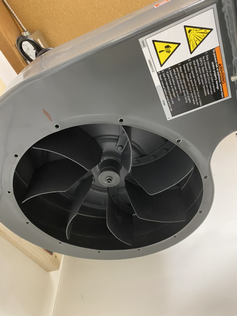

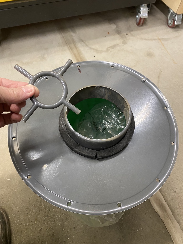

I removed the fitting at the entrance to the impeller and there is just a cross shaped guard there. There was a small amount of ribbon collected there but not enough to noticeably reduce air flow. I will check it periodically going forward.

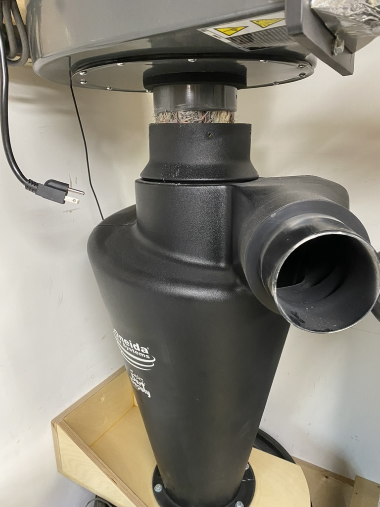

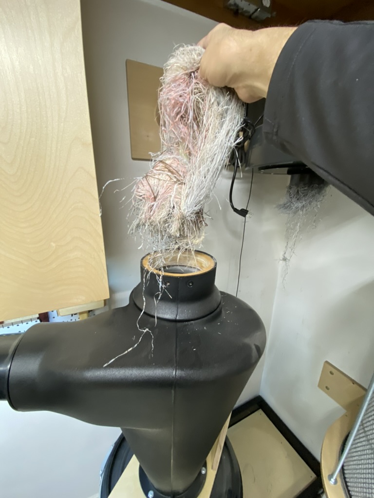

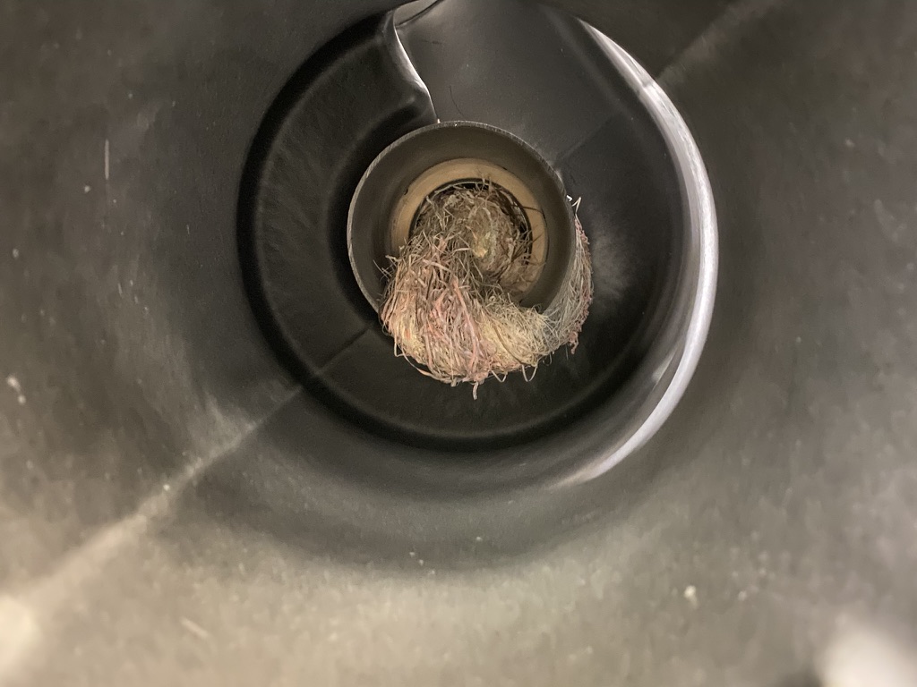

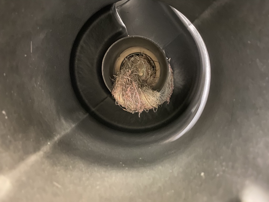

If you turn a lot of synthetics (alumilite, acrylic, ebonite, etc...) you will eventually have an issue. When I did the upgrade of my impeller (to the full size Rikon) I removed that cross shaped metal guard. In the stock Harbor Freight setup, you could get your hand in there, but in mine, you cannot because the Super Dust Deputy is in the way.
Here is what it looked like when I removed the Super Dust Deputy to access and change the impeller. As you can see, it was completely choked with ribbons of swarf.
03DECA6D-19D5-419F-A277-E6DD97C4C640_1_105_c.jpeg 6526A917-E349-432E-B88A-116495AE89A4_1_105_c.jpeg 94F1F2E8-268F-405E-9AB0-F93FD84DC535_1_105_c.jpeg

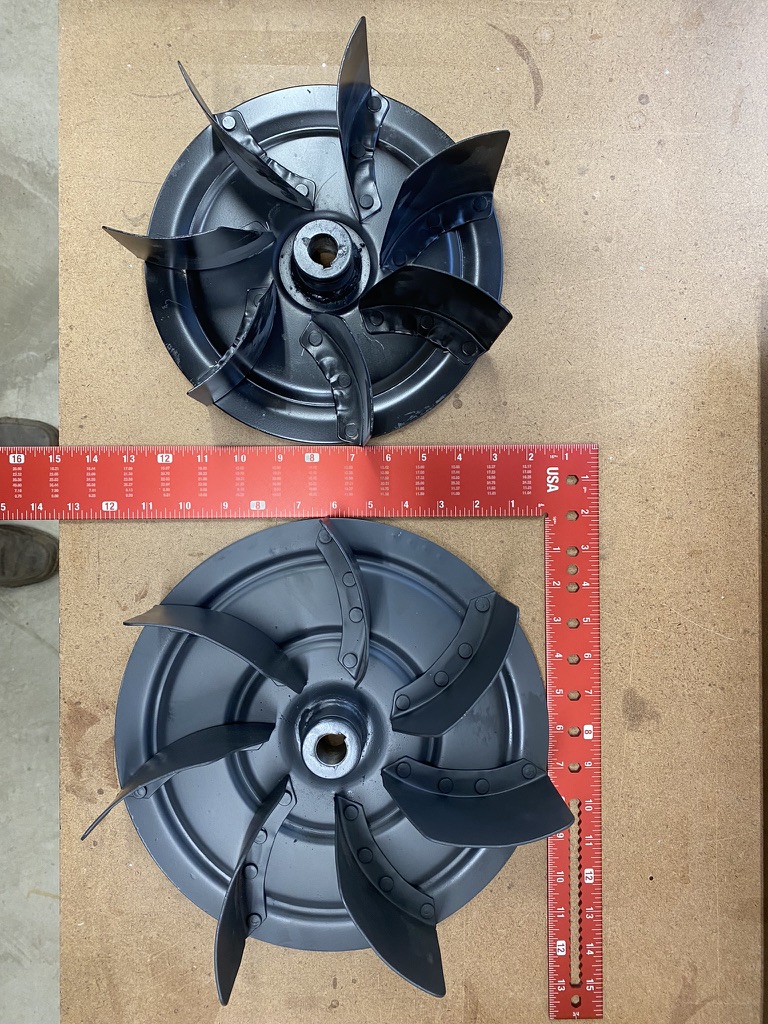

Here is a photo of what I removed...

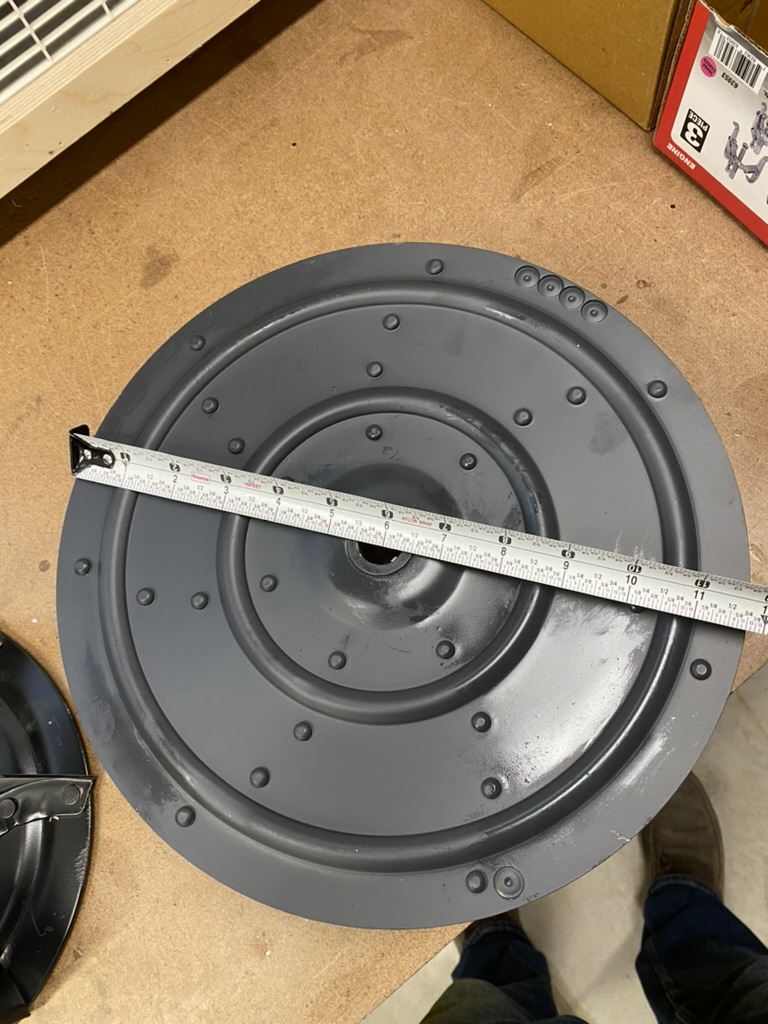

Here is a comparison of the two impellers. Note how small the stock Harbor Freight is compared to the Rikon which is 11.75" and it fits (barely).
1F79BE0F-12B5-4B8E-B167-A0DF1B6DFC04_1_105_c.jpeg 79B9DF2C-7D69-47A7-B59D-AC92F47B83A5_1_105_c.jpeg 93611D5A-094E-4D5C-ABB9-EE8F3F247687_1_105_c.jpeg
Hope this helps.
Yes, thank you. It seems the bigger impeller would pull more current? Load the motor more?
I have the DC plugged into a separate circuit from the other power tools. It is 20 amp, it is also where I connect the welder when I use it. The table saw draws almost 15 amps and so does the DC, so they have to be separate. So I am sure it would be OK if the DC drew more current.
Mike
Mike
Yes, it will definitely cause the motor to draw more current and more inrush current. I have not measured it but it works fine for me. I do have it on a 20 amp circuit which is also separate from the other circuit(s) that I have my tools on. The table saw is another tool with higher inrush current, and then obviously more current is drawn when you load it up like if you are cutting something like 8/4 Hickory (ask me how I know...).

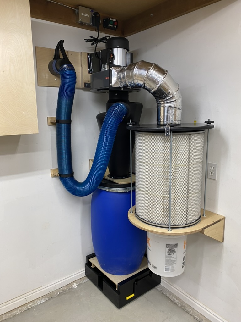

Can you post a picture of your dust collector setup? It looks like it might take up less space than the stock HF unit. Either way, I need better filtration. I don't have COPD or anything and have never smoked but my lung function is slightly impaired and I don't need to make it worse.
The DC has really helped, but it could be better.

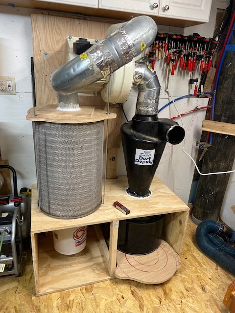

Yes, of course... :cool:
Let me know if you have an questions.
I've got a Jet DC and also modified it similar to @d_bondi. I believe we both used the Wynn Engineering filters in the redesign. My shop is pretty compact and in the garage, but I heat it with a smaller heat pump in the winter and reverse it to AC in the summer. When the DC was outside my shop space, I couldn't keep the temps right when the DC was running, as it was sucking all the conditioned air out of the shop. The configuration shrunk it down in footprint and allowed me to put it in the shop behind the lathe, so a little noisier, but better with temps. Suction also increased as I eliminated the long run of piping between the shop and the DC.

Thanks for the pictures Kevin and Dave. That doesn't look much if any smaller than what I have. The dust deputy is smaller than the separator device on the HF DC. I will have to look into this upgrade.

Your welcome! As David said, any questions, just ask. Correct on the footprint - my original Jet 1200 DC came on a rolling steel tray with a metal cyclonic seperator on 3 steel legs attached to the rolling tray. The original bags were attached over and under the separator, with the blower sitting to the side of the bag stack on the base tray, very similar to the HF DC. It had a flex pipe between the blower and the bag stack. The footprint of the modified DC vs the stock factory unit is pretty similar - but with lots of performance gains with the upgrades in similar space.
The original separator was behind the blower impeller, meaning that everything sucked into the DC banged around in the impeller blade prior to being sent to the separator and dust bags. The current setup fixed that and does the separation before the blower inside the Super Dust Deputy - eliminating the large object baffle that David had issues with in the original machine that was needed to keep really bad stuff out of the impeller. Since the separator is a standalone entity, vs in the bag stack, it takes some floor space. The big gain is the reduced wear and tear on the blower impeller and the major reduction in the size of the dust capture (now 1 micron or less). Just changing the efficiency of the bags does not get you any help for the blower - you need the external pre-separation action of the cyclonic Super Dust Deputy before feeding the input air into the blower impeller. Lots of folks change the upper bag to a 1 - 3 micron filter bag and the lower bag to a plastic one to keep costs down and reduce the bad dust still coming out of the DC - but it doesn't do as good a job as the Wynn filter combined with a Dust Deputy.

Ditto on everything that Kevin noted.
In my case, my dust collector components are all wall mounted in a corner that would otherwise have been difficult to optimize the use of space in, so a win-win for me.
