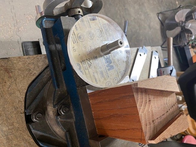

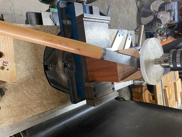

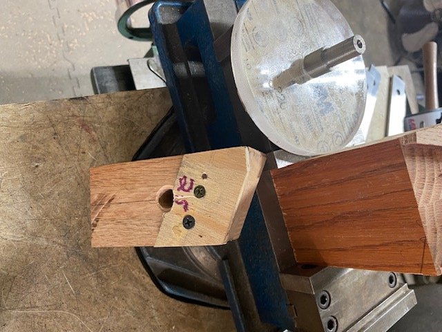

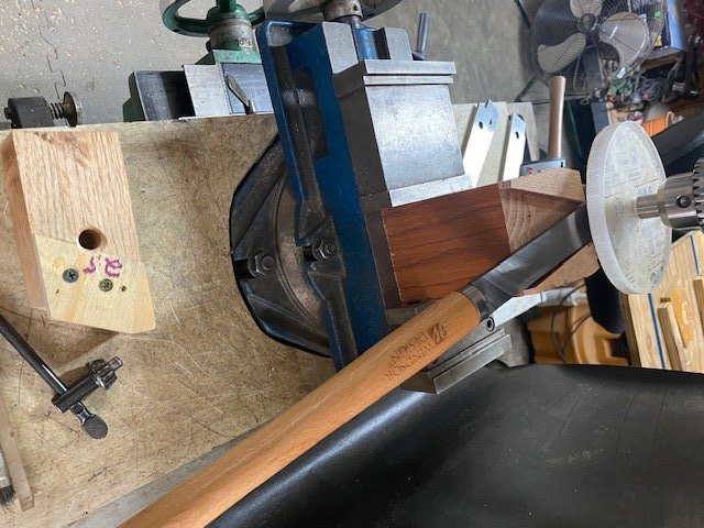

This is a little jig copied from Taylor Tools made for chisels but I adapted to sharpen a skew also. Pretty easy build.

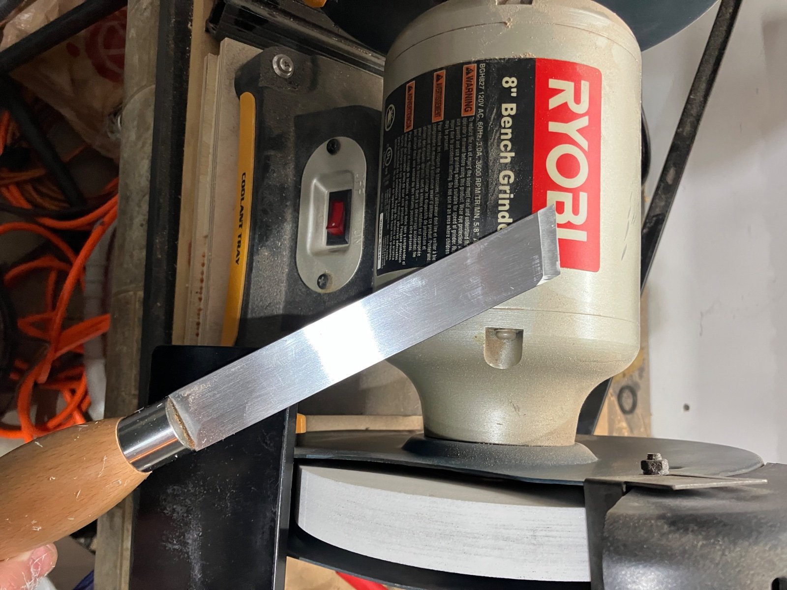

I did some careful measurements yesterday evening before getting started. The bevel was already right on at my desired 22° (it came that way from the factory, guess Crytotek has done their research on commonly-recommended skew bevels). What's more, when I drew a point between the edge of the toe and the shoulder, that skew angle was already dead on at 20° as well, which I had independently decided to use when I ground it to a straight profile. It just had a radius between those two points instead of a straight line, obviously.
I marked the 20° line across the steel and ground away the smallest amount of radius that resulted in a straight line between the toe and shoulder. Then set my platform to match the 22° bevel angle and got to work with my coarse wheel, taking short passes on either side and checking frequently to make sure I was keeping the grinds even on both sides so I didn't end up with an off-center cutting edge, or one bevel larger than the other.
As I worked, I also paused to dunk the tool in ice water every few seconds and wipe off with a towel. Never built up enough heat to discolor anything or even make the steel uncomfortably warm to the touch, so I think I kept it in the "safe zone" by working patiently.
I should be able to put the finishing touches on this evening - just need to do the last fraction of a millimeter of grinding with the fine wheel, and then hone with my 1200 grit diamond card.
All in all the process was far simpler and less intimidating than I worried it would be. Hopefully I can post before/after pics tonight.
