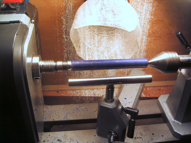

My lathe is at the end of a bench. I have a piece of plywood attached to a big chunk of Mahogany scrap that acts as a weight to keep it from tipping over. I cut a hole in it for the hose to come through and made a makeshift "hood" from an old plastic jug. (the whole thing is kind of makeshift really...:biggrin: )
I can move it back and forth to get the hose where I want it.

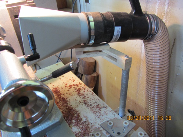

I have a hood that I picked up somewhere. I mounted it on a little articulating arm that I made. I can move it from side to side, in and out, i can raise and lower the post it is on.
