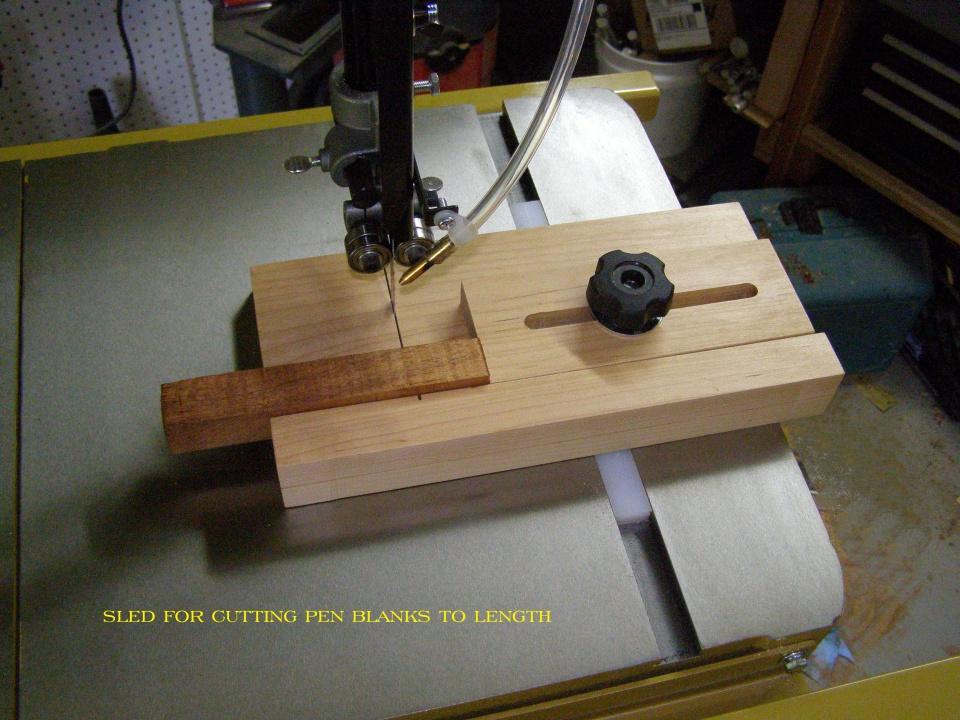

This is the method I use for cutting blanks to length. Smoothness and kerf depend on blade being used. Fine cut is really no concern as I use barrel trimmer after tube is glued in. Good luck.
Ben

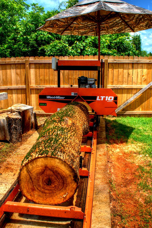

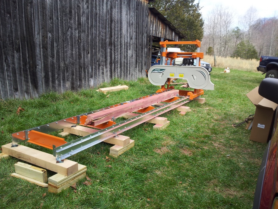

WoodMizer LT10G10.....
Then I move down to the tiny 12" upright bandsaw....for roughing the length.
Then I move to the Makita miter....for the final cut, stack them by the hundreds into the shed for drying...and wait.
Then let them go cheaper then anyone on the 'net!
Scott (doin' all the work for ya) B
