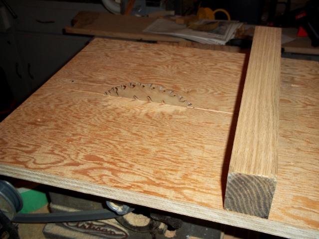

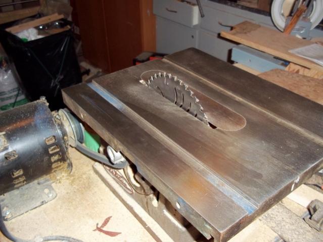

lucky enough to have found this mini table saw and made a sled for it.

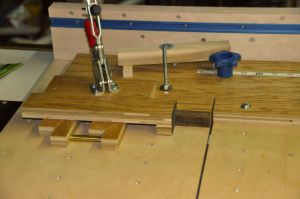

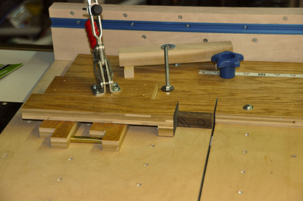

For segmenting I use my table saw with a series of jigs to make all the cuts as repeatable as possible. The jigs hold the wood, keep the blank aligned for the cut and most importantly my fingers out of the way. The devil is in the details as they say and in segmenting making every cut exactly like the last keeps all the lines and all the inserted segments exactly as they should be. My blade of choice is a 1/16" carbide blade that gives perfect cuts with no tear out. I set the cut to end 1/16" short of cutting the blank through. This keeps the blank from shifting when gluing the inserts. You just need to start out with a square blank and keep the blank square.
