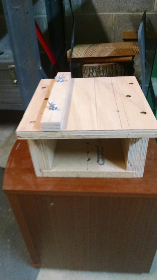

I hit the edges with a diamond file and that seems to help. As I mentioned, the wood is very hard on the Janka scale. The ebony is round so I'm going to drill it on the lathe in my pen jaws. I made a disk sander with scrap plywood and will try that. Made it after the disaster I mentioned earlier.
