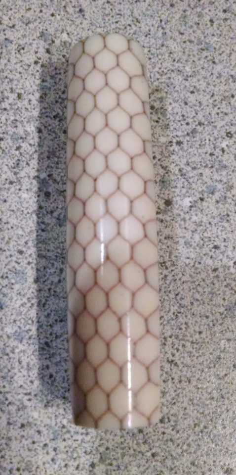

And here it is. This is one of my off white blanks.
It is a sierra blank
What I did was:
. Cut the blank in half
. I drilled it on my lathe
. Epoxied the tube in and waited 2 days
. Took blank corners down on lathe to get close to round
. Finished the blank with my turning tool
. gave it a final sand and polish
There it is...
we're you rounding it from square with the skew?
No, I had sanded round and then started using the skew but it still chipped enough to make the blank unusable, so I than started experimenting with other tools.
