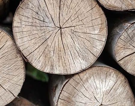

Holly is found of cracking, and quickly. Before anything else, split the logs in two or more. If you don't, they will split where they want, usually a little bit everywhere, like here, and it will be unusable.

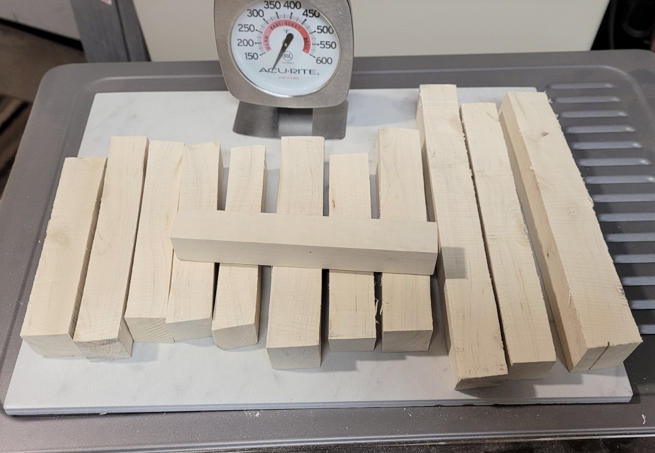

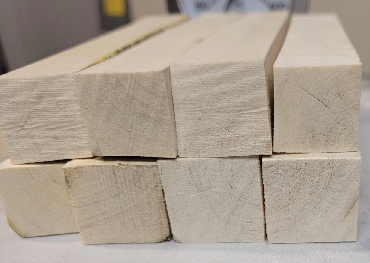

I picked up a suggestion about drying in a toaster oven in another post. My wife bought a nice one with a convection fan to use for poly clay and this seemed like the easiest thing to try first. I wanted to test out the new bandsaw blade anyway, so I cut up one of the three pieces and gave it a go. Here are the results after about 1.5 hrs in a convection toaster oven at 225. The lighting wasn't that good, but the pics show the results pretty well. It's definitely whiter than it looks in the pictures.
The blank laying across the top (second pic) was purchased, and is a little lighter and clearer, but the newly dried ones do have a pretty nice creamy tone overall. It did check a little on the ends. Obviously, I don't know what it looks like inside. They will be sitting for a while before I get around to testing them out to finish adjusting to ambient moisture.

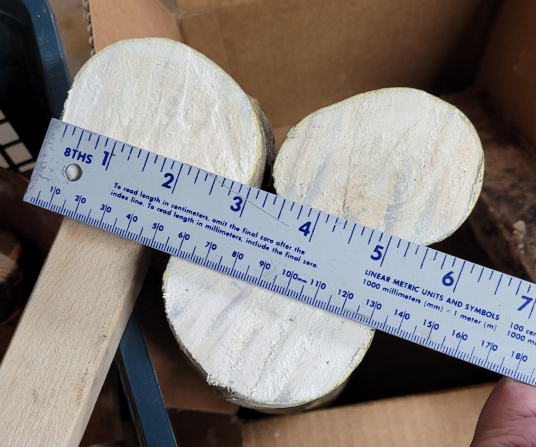

This is what I started with. They are 16-18 in long.
Cut and dried 1.5 hrs at 225 F in a convection toaster oven.
Some checking/splitting on the end grain.
