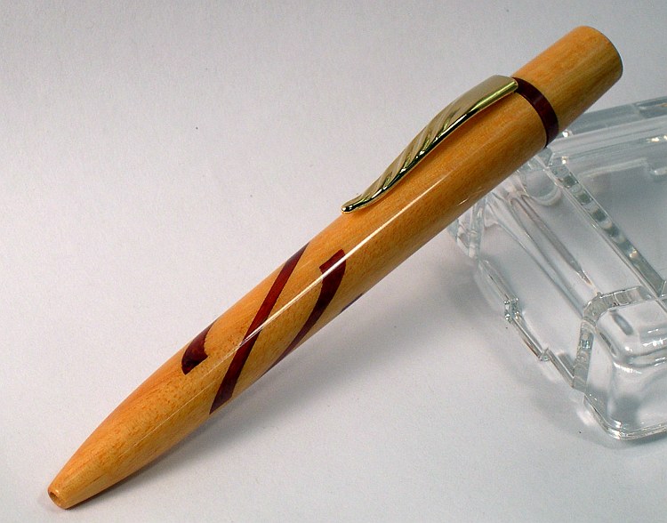

This kit was modified to have a true one piece barrel, finial operated, and recessed clip.
Osage Orange with Paduk accents and CA finish.
Dedicated to all the wonderful people here at the IAP from whom I have learned so much!

Does it HAVE to be an ultra??? It LOOKS like you could have made it with any cigar kit (cheaper), or am I missing something internal??
Just a FWIW!!
Thanks for any info you care to provide!!

Yes any cigar kit works. The size of the recessing for the clip is actually the same for the 2 clips (I dry fit a standard cigar clip to check).
I went with the ultra becasue I like the clip better, the pattern in the clip echos the "spirals" in the body, and the shape of the clip echos the shape of the barrel.
I like the ultra clip, but I think the rest of the ultra kit is too busy. I wish I could buy just the ultra clip - then I would go kitless for this design.
