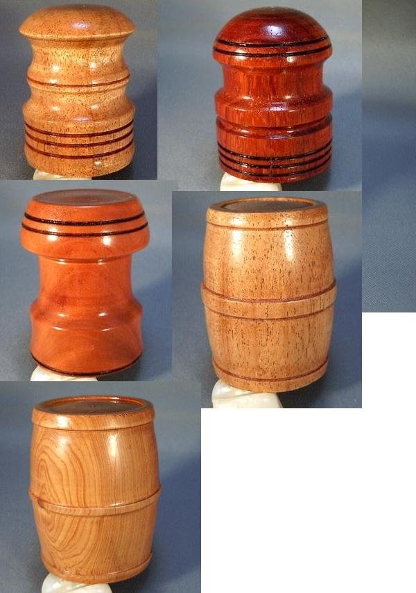

Five Stoppers. Top left: Mahogany, Japan Style, Top right: Bubinga, Middel Left: Peroba Rosa, Middle Right: Mahogany, Bottom: Arizona Pinon (from firewood). The synthetic cork is recessed up inside the stopper. These were fun to do.

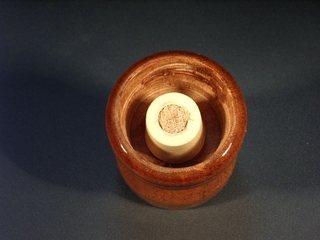

Here is a picture of the "guts" of the stopper. Here is the explanation:I have a different take on Bottle Stoppers. I took the basic idea for the “Ginter†Stopper and modified it. Here is what I do: take a block 2†x 2†x 21/4†and drill 15 mm or 20mm with a 32mm Forstner bit. Then drill 15mm with a 3/8†bit. I put this block on my expanding scroll chuck, HOWEVER, before I got the scroll chuck I just put in on a Jacobs chuck, cut a small piece of waste block for my live center and friction mounted it. Then I turn a bottle stopper. What you can do is take a #2 synthetic cork (I get these from the beer home brew store) and a 3/8†dowel rod. I cut the dowel rod and rubber cork to fit in the 20mm hole. CA glue the rubber cork to the dowel rod and CA glue the dowel rod inside the stopper. You cut the dowel rod/rubber cork to fit inside the 20mm forstner hole. What you have is a “Hidden Cork†bottle stopper. The Bottle Stopper fits over the bottle and you don't see the cork. I don’t use real cork. They guy at the beer home brew store said that almost all real cork has some disease and that the rubber cork (which has a 3/8†hole already drilled in it) is sterile. I’ve made many of these stoppers. You can see a couple of them in my album. Oh yeah Ginter is: http://www.ginterenterprises.com I am not affiliated with Ginter, he has a good idea.
Good luck.

Tony; Those look impressive, the stopper won't roll off the table, and if the cork is wet from the wine, it will not stain the surface.
Good job. I like the design and execution.

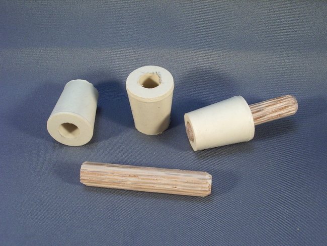

To answer a few questions:
Paul no need to turn the corks they are cone shaped. They are "#2" corks from a Home Brew shop. They are pre drilled at 3/8". A 3/8" dowel rod works great as it is slightly larger than 3/8".
Elliot here is a picture of the corks, dowel rods and all. If I can help you any other way, just holler.

Tony, I was just out looking at your photo album, before I came back here to see new posts on this thread. I realized that you corks were different than I thought. I did not understand they were already tapered and drilled. Thought you were using syn. corks just like a person pulls out of a wine bottle, than cutting and drilling them yourself.

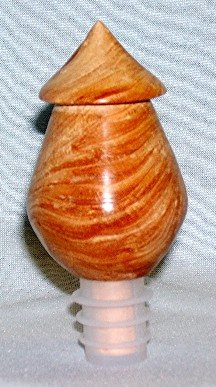

Tony,
Very cool idea.. I like the inside design that Ginter uses, but yours looks less complicated.. I use the silicon sleeves that slip over the dowels on my bottle stoppers.. I stopped doing the metal cones and tear drops because I think they are too top heavy... do you think the silicone sleeves would work as well?? This is the kind I'm talking about....
do you have any objections if I copy your techinique??

Chuck,
Great Stopper! Very nice turning. The Silicone Sleeves should work great. OBJECTIONS ! OBJECTIONS ? Says I, Copy Away, Have Fun, just post pics so we can see. Oh yeah Chuck, uh...where do you get those Silicone Sleeves? (I'd like to do a couple of those...hehe).
The more Stoppers the Better...whoohoo.
Thanks Chuck.

Sorry for delay in response... my internet carrier had a server down for about 24 hours... really messes up your day when you are used to popping on-line first thing every morning to look at email and forums... throws the rest of the day out of whack...
The stopper I show is from a piece of applewood I got from a turner over in NC... pretty wood.
I get my sleeves from CSUSA, PSI and Packardwoods... the last ones I bought, just last week from Packardwoods... they silicone part was yellow instead of the clear/opaque white I'm used to... and Dawn is right.. they come with a step down dowel.. 1/2 for the sleeve and 3/8 for the insert into the stopper. PSI and Packard sells them as a package unit.. dowels and sleeves(10 to a package), but CSUSA sells them as separate pieces.. usually 5 to a package.
