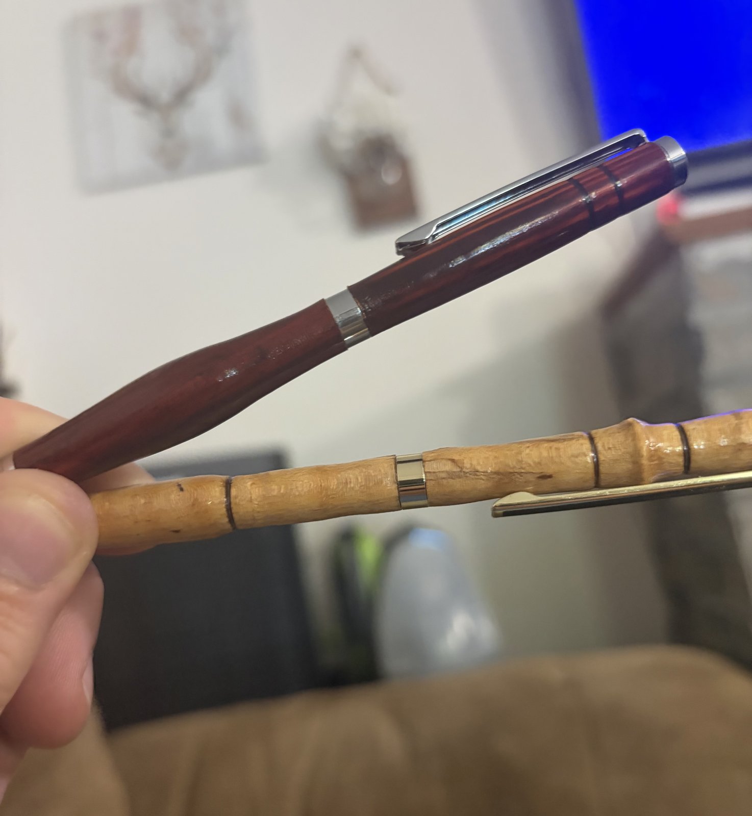

We did make slimline pens in our class. My 10 year old did a good job for his first time on a lathe. His is the light colored wood. First pen making for both of us.
It's a two part-er.

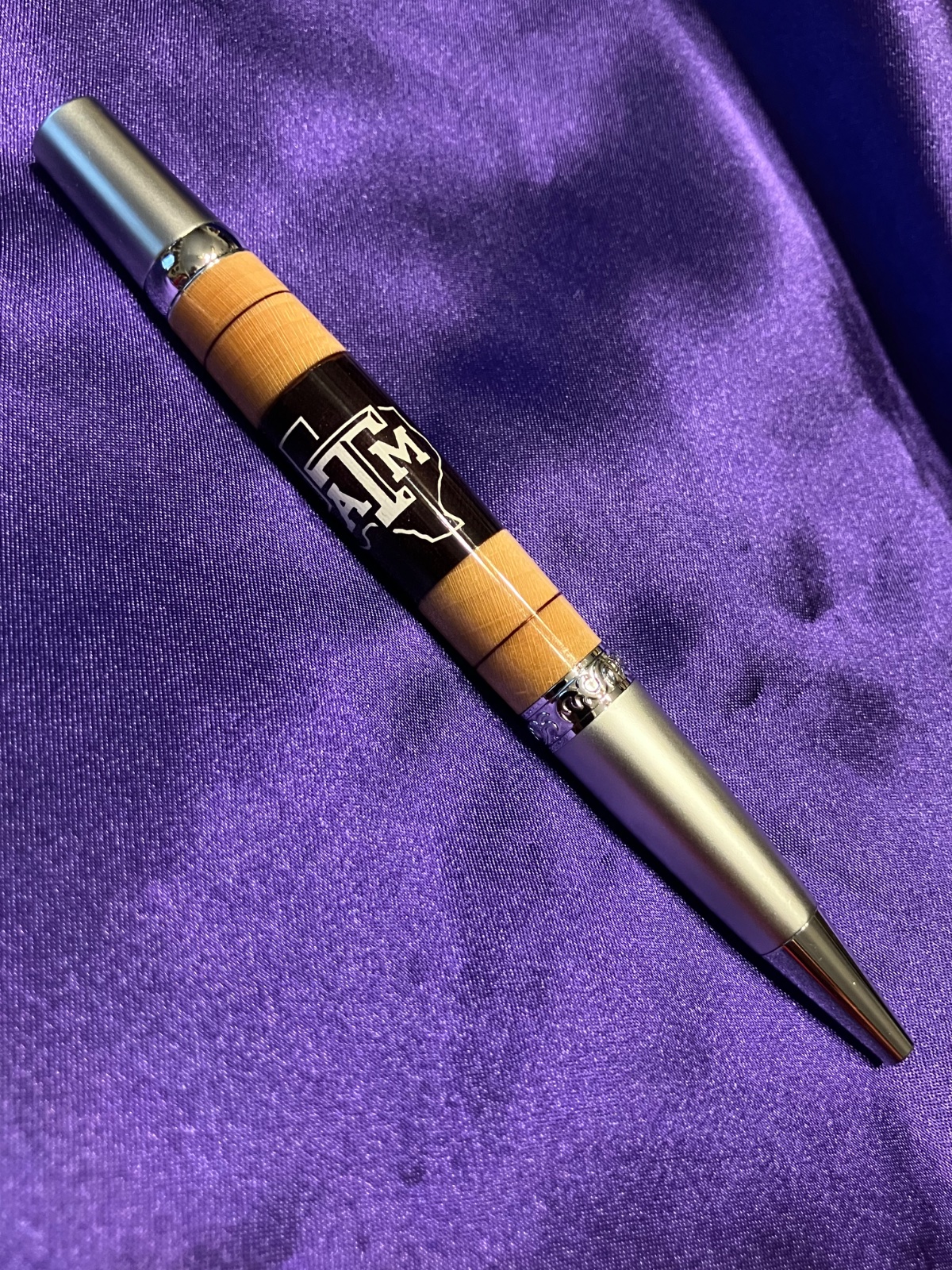

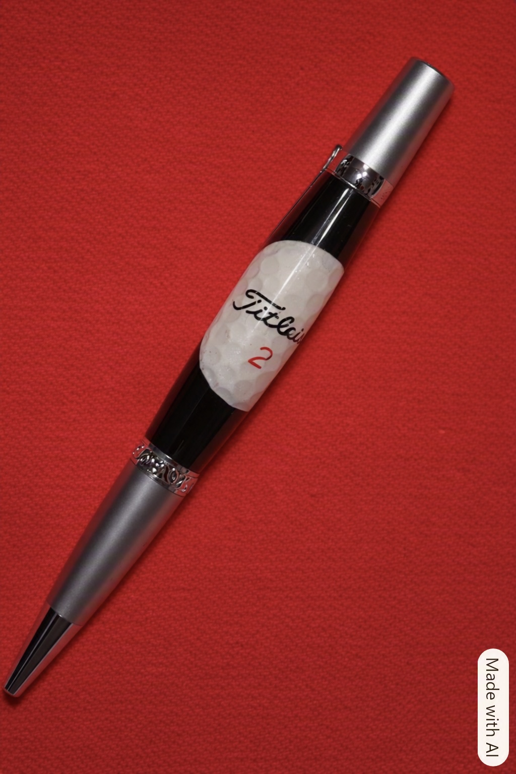

I don't have a picture of the first one so the A&M pen is to give you an idea of the layout of the pen. I cut the center out of the ball and drilled the hole for the tube. I glued the ball on the tube and put it on the lathe to square up the ends and get the diameter close to the bushings. Then I drilled the caps being sure one end of the caps were perpendicular to the hole. When I glued the caps on the tube I was careful not to compress the ball and leave no gaps between the ball and caps. Once dry trim the ends and turn like any other pen.
The second pen I cut the skin off and thinned it as much as possible. Then I glued the ball on a painted tube and cast it in clear resin. That was pretty much it.

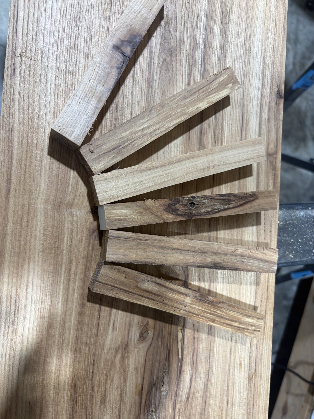

Made some beginner blanks over the weekend from a 2" slab of hickory. I realize that a few of them need to be stabilized but we don't have that option. Will try to turn them with the expectation they will come apart.
For the ones you noted need stabilization, flood those questionable ares of the blanks with thin CA before and after drilling and again before and during turning, it will help.
Wow! Gorgeous figure in that wood! - I think it is going to make some fantastic pens! - Dave

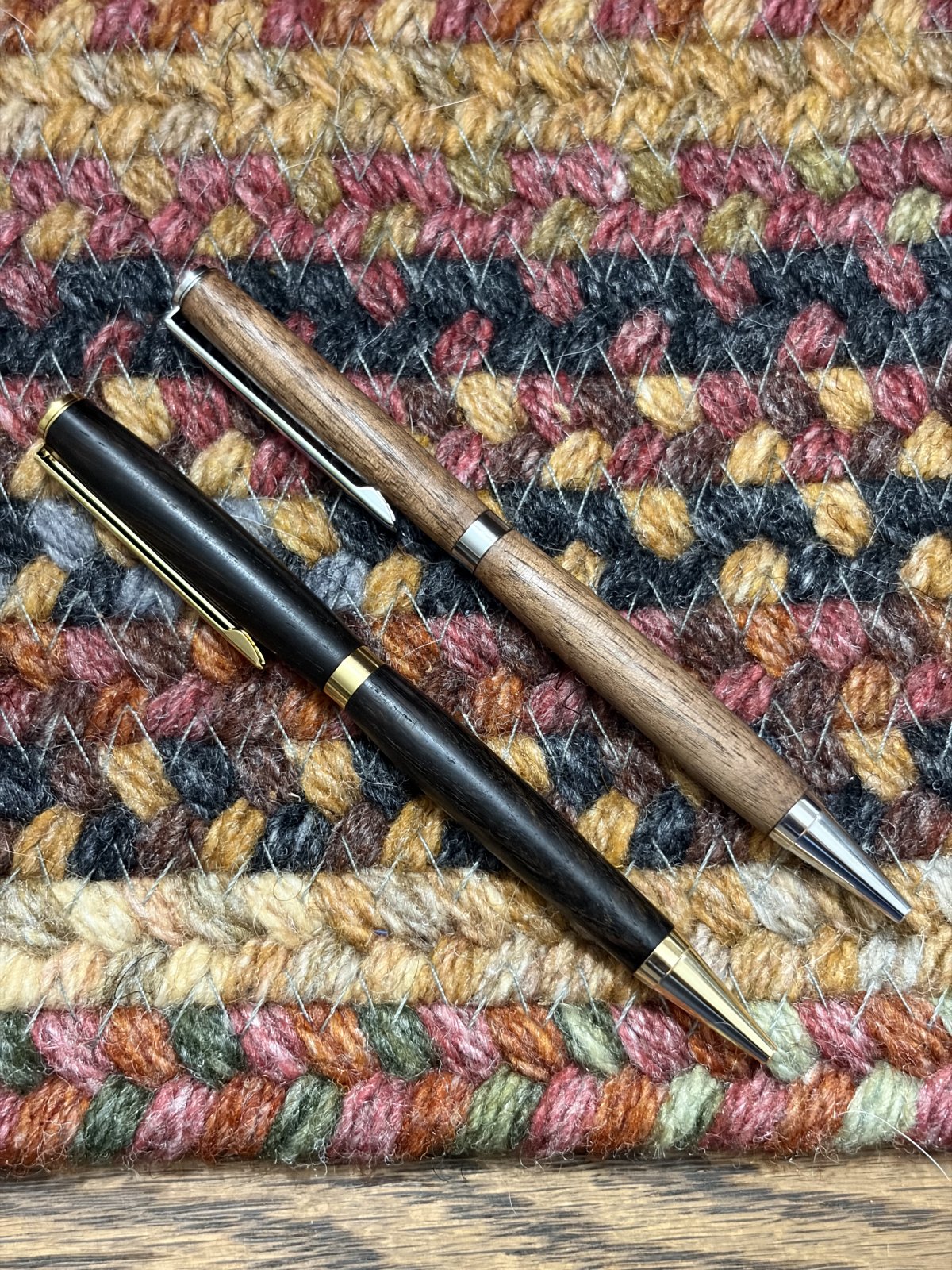

Our lathe finally arrived and today my son and I got to break her in. The Hickory pen I set out to do did not work out. The Slimline kit was antique and after much confusion, the the first piece you press in ends up too short compared to all of the other kits we have on hand. We built 2 pens and on both the refill would stick out way too far. But we figured out why and will have to make blanks a little longer. The Hickory did look great!
We did a walnut from some of our board stock and an african black wood from a store purchase. Our finish was not good on the walnut. The sanding needs to improve. Both were tested with a friction polish finish. ALL CRITIQUES WELCOME FOR IMPROVEMENT AS WE GET GOING.

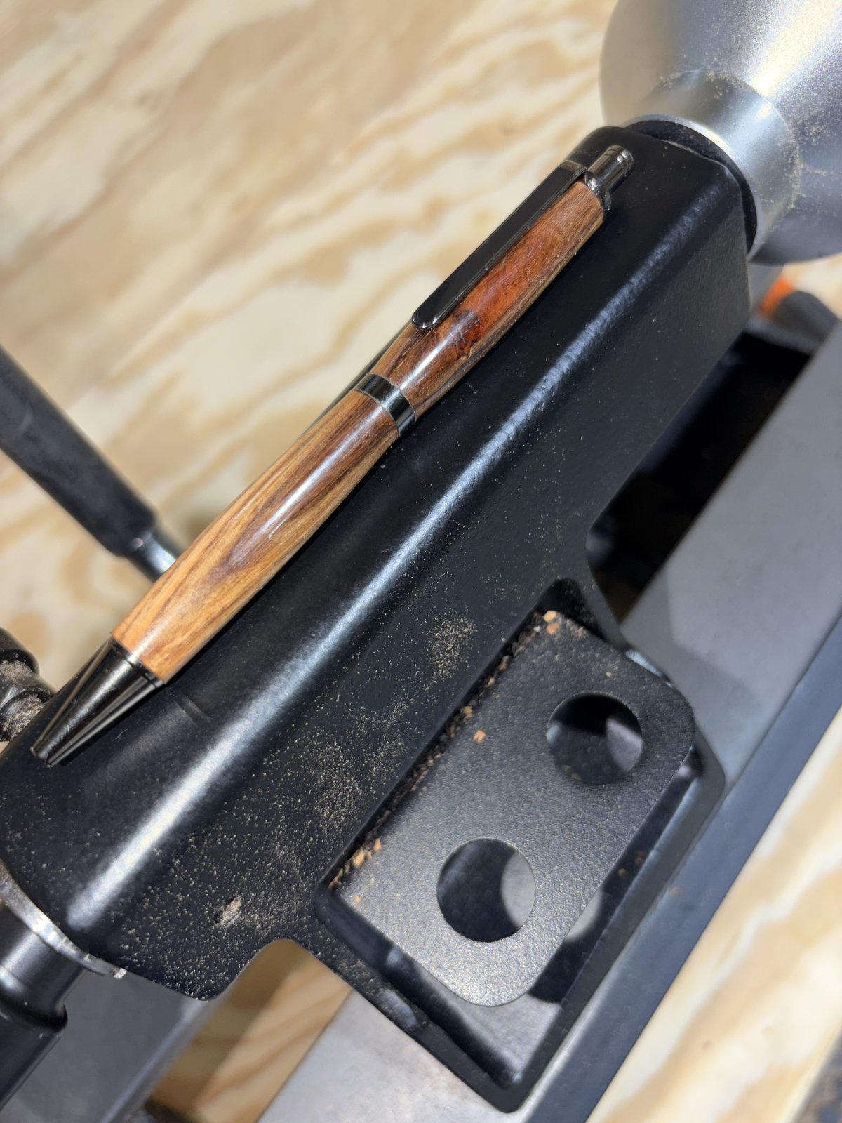

Decided to try the Hickory again. Cut some blanks to try to get the knot to show up. I tried to bond the gaps left after final sanding with thin CA but it left a bad haze and I couldn't seem to get it cleaned up. Got a lot to learn in sanding and buffing compared to the work I see posted around here. But it's addicting!
View attachment 394828Decided to try the Hickory again. Cut some blanks to try to get the knot to show up. I tried to bond the gaps left after final sanding with thin CA but it left a bad haze and I couldn't seem to get it cleaned up. Got a lot to learn in sanding and buffing compared to the work I see posted around here. But it's addicting!
One can experiment with finishing techniques and turning techniques. Some work, some don't. AMHIK BTW, one of the first pens I sold was a Slimline with a maple blank, finished with a blue Sharpie and CA.
