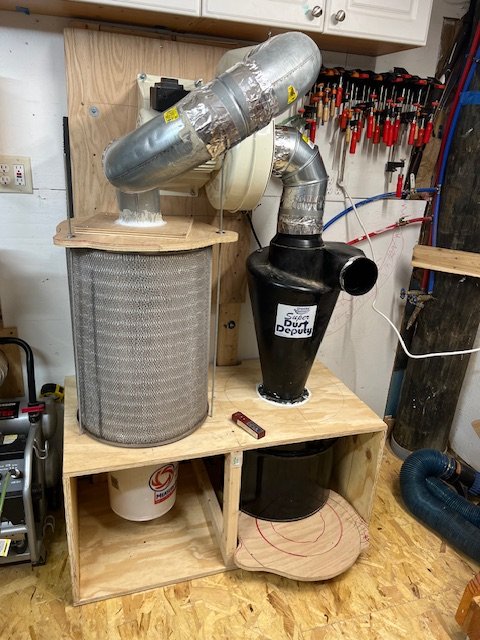

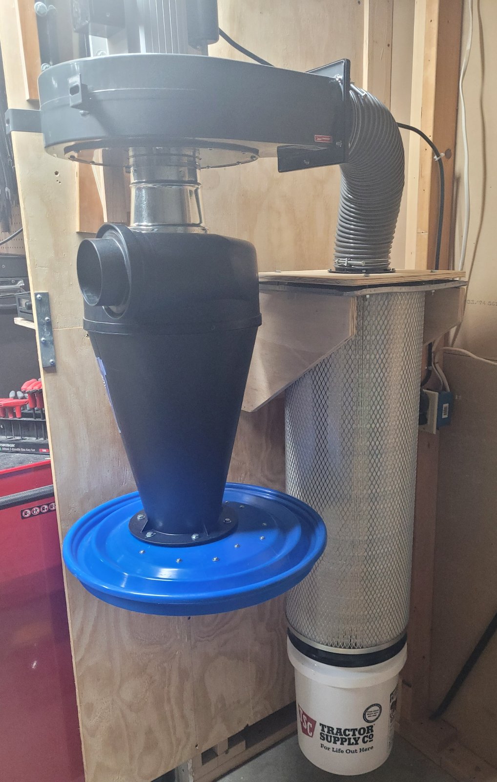

Make sure you leave room under the Wynn filter for a catch bucket. Even with the SDD you will have some fines get through and when you clean the filter, you will want it there to catch stuff.

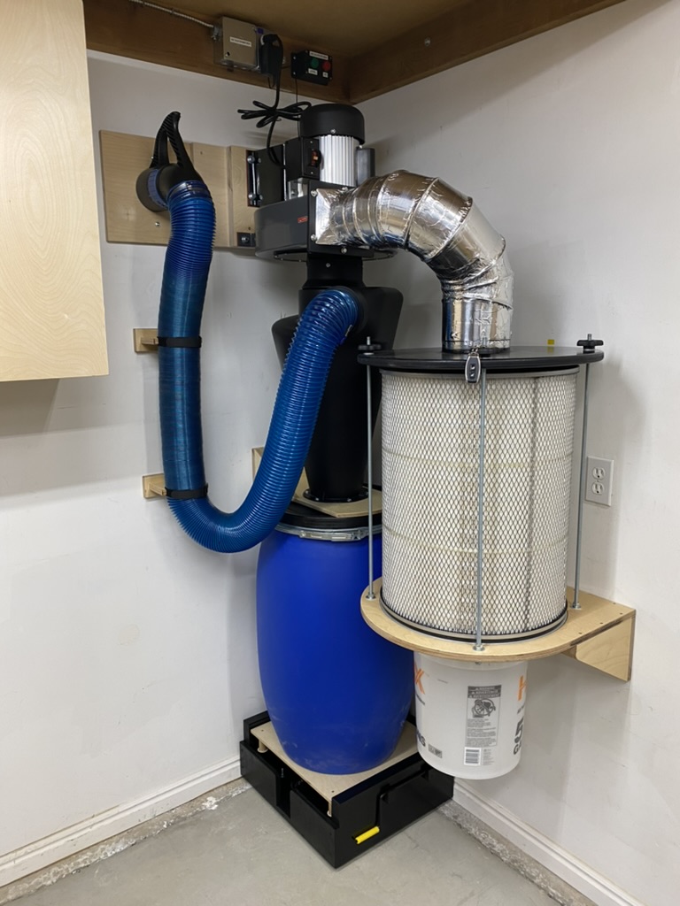

I've got a similar setup to @d_bondi but mine is based on a Jet DC. I used the larger Wynn filter, a SDD, and eliminated the metal separator that came with the DC. My issue was the blower direction and the airflow in the SDD were opposite each other, so I needed to make some adjustments to the design which made the unit a bit larger but more efficient.
Design must accommodate a lot of airflow versus air velocity, so be sure your piping is as large as possible, minimizing bends, and use ridgid pipe as much as you can for longer runs versus flex pipe. I also have a 5 gal spackle bucket on the end of the filter to collect stuff and it needs emptying at times, so plan the filter length as filter plus catch bucket.
Here is mine -
I have the Gamma seal lid and bucket for under the Wynn from Tractor supply and a 35 gallon plastic barrel for under the SDD. I think D. Bondi's layout will work best with my HF DC. Mine will be very similar.
Mike - Please let me know if you have any questions.
NOTE: The bearings on my HF Blower's Motor are going out. I do not know if the fact that I have mounted the motor rotated 90 degrees from its intended orientation has contributed to this or not, but I wanted to share that with you. One of my next shop projects will be disassembling the dust collector so I can replace them. I will look for replacement bearings that are heavier duty and/or for the vertical orientation.
When you look at the photo of my setup, you will see the black box under the 30 gallon drum. This is a lift that allows me to lower the drum to empty it.
I didn't notice the lift. That is a good idea, I was pondering how to support the drum. I was thinking of a pair of wedges to raise and lower it. Where did you source the lift?
I have seen several HF DC mods where the blower was rotated 90°. I wonder if that happens often? There are definitely bearings designed for side thrust as you said. Probably look at McMaster Carr?? The last bearings I bought were for my Jet mini. I don't remember where I got them, but they have to take a side load.

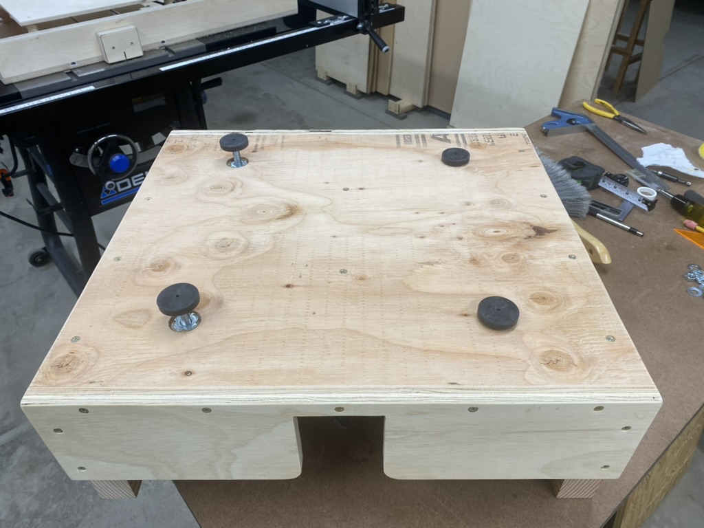

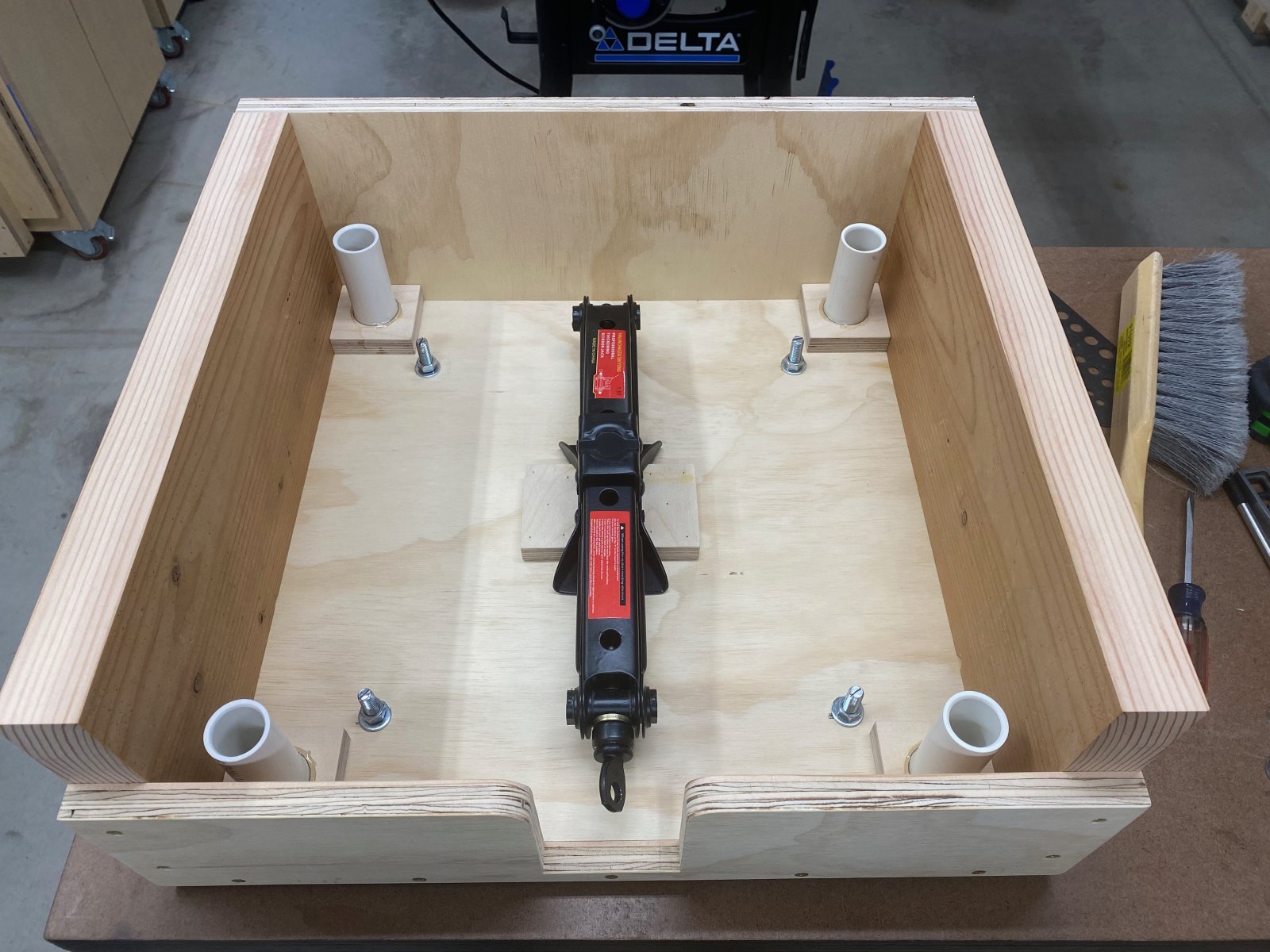

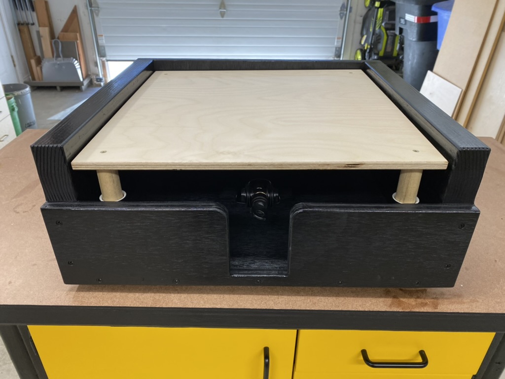

I built it with a cheap car jack from amazon. Definitely over engineered and over built, but I am an enginerd! Here are a few pictures. I hope they help.
View attachment 387869 View attachment 387870 View attachment 387871 View attachment 387872
Oh goodness....... You all probably noticed the piece of plywood under the catch bucket in my pic - my 'engineering' was to draw some circles on it so I would know when it was fully under the bucket.....lol. My lift is 4 pieces of wood, that I stack, with the circle board on top to hold the barrel up. I am lowering my head in shame......
My barrel came with the SDD. It is a true pain in the butt to latch, as it has a classic steel barrel latching assembly that has to be put into the recesses of the barrel and lid before you lever it closed. It works well, came pre-drilled for the SDD, but if you have space I wouldn't use it. I had about 2 inches of clearance between the modified DC and the cabinets above, which are also snugged below the floor joists, so not much room to play. If you have the cash, you might want to consider an alarm they sell that tells you when the bucket is approaching full. I don't have one, so I do waste some time emptying the somewhat full bucket.
Like David's, I originally had the SDD directly connected to the horizontal blower on mine, but the direction of flow required me to flip and stack the SDD and blower differently. It takes up more room, but the DC is probably 20 + years old now and still going strong. Maybe the orientation helps?

The plywood looks like it works fine. I may end up doing that depending on space under the barrel. My barrel is one of the blue 35 gallon ones that have the ring latch too. I am planning to change that somehow, maybe with a piece of plywood on the SDD and one on the barrel with a gasket and bolts or something.
I may put a slit window in the barrel so I can see the dust level. I have seen them attached with silicone and screws.

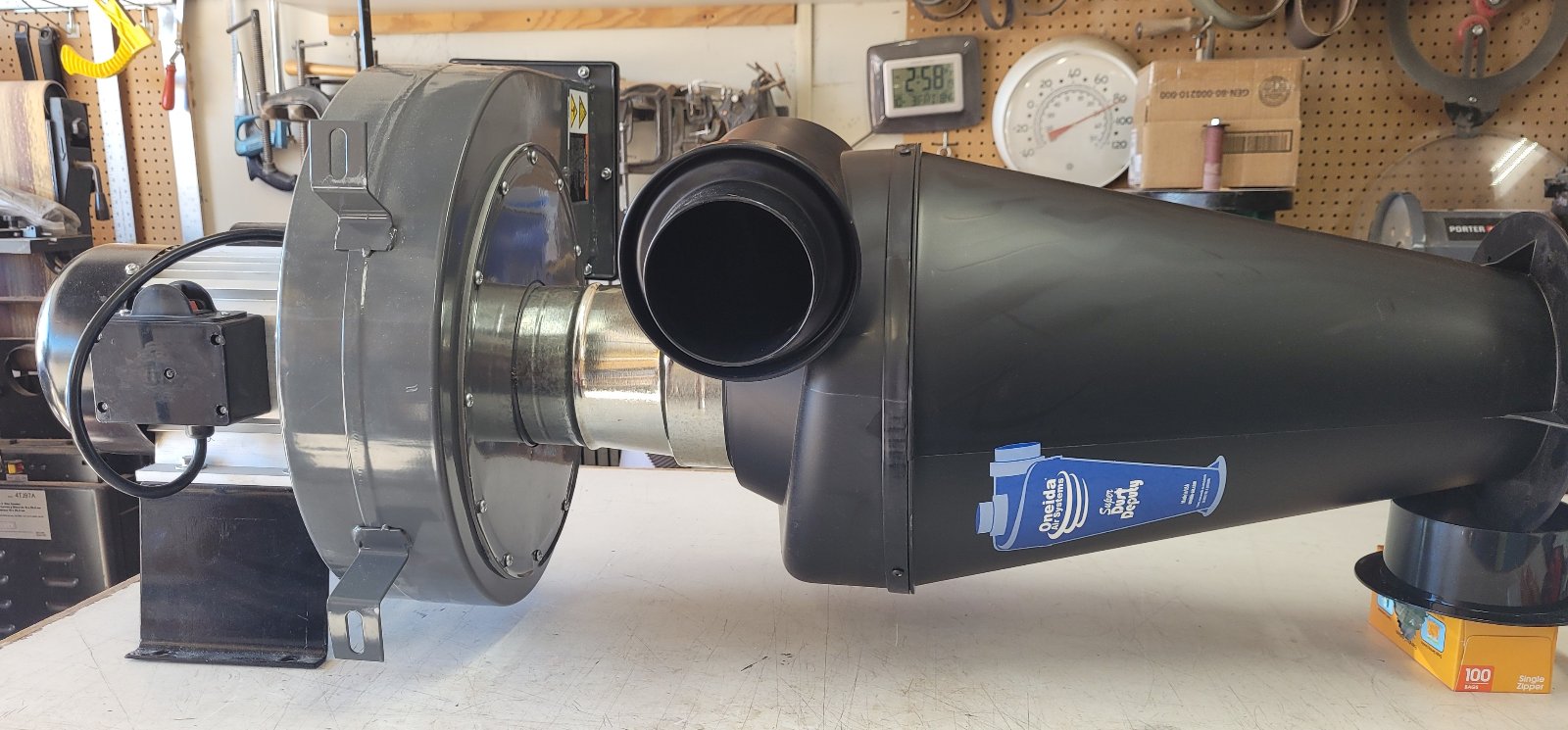

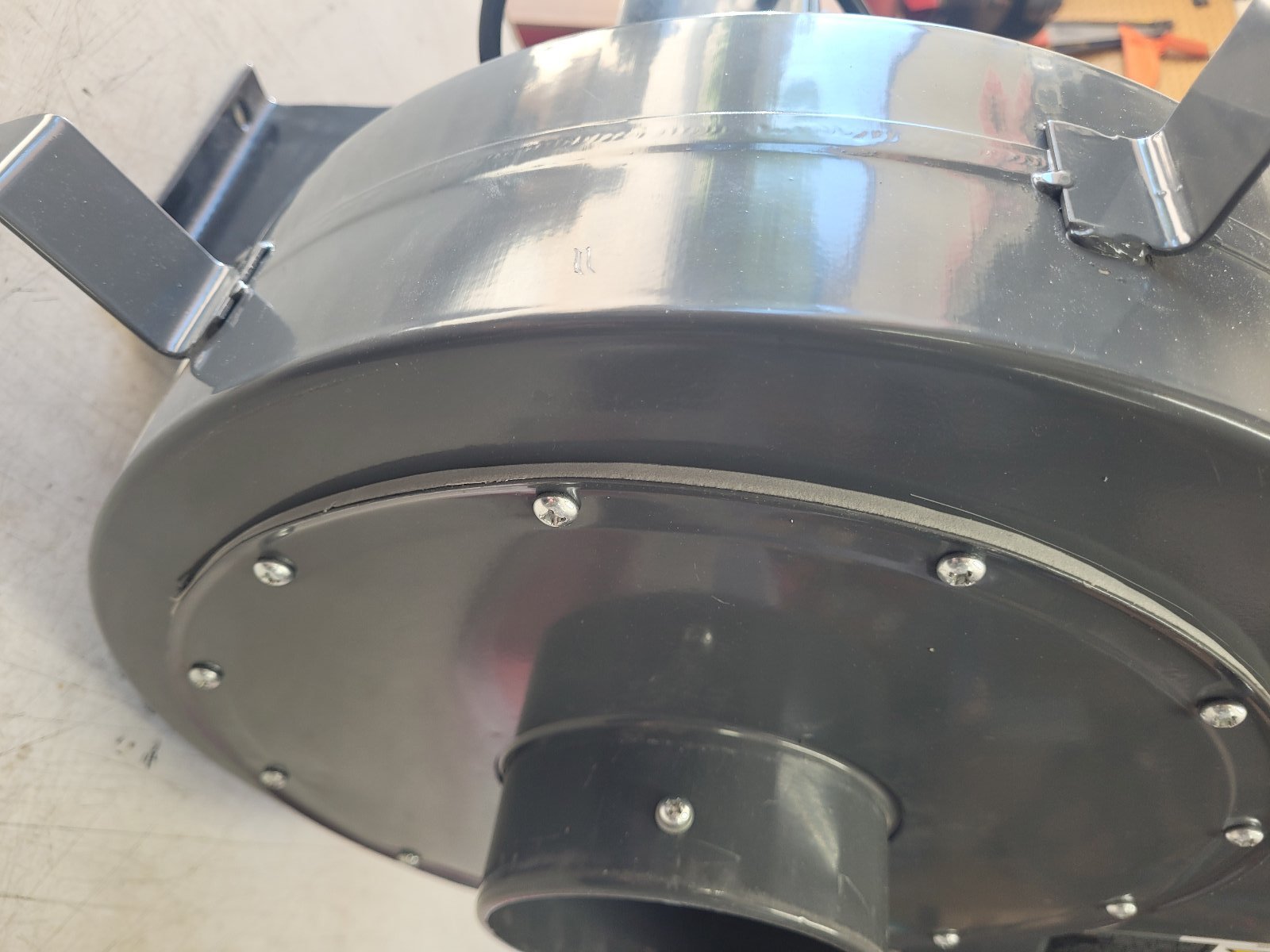

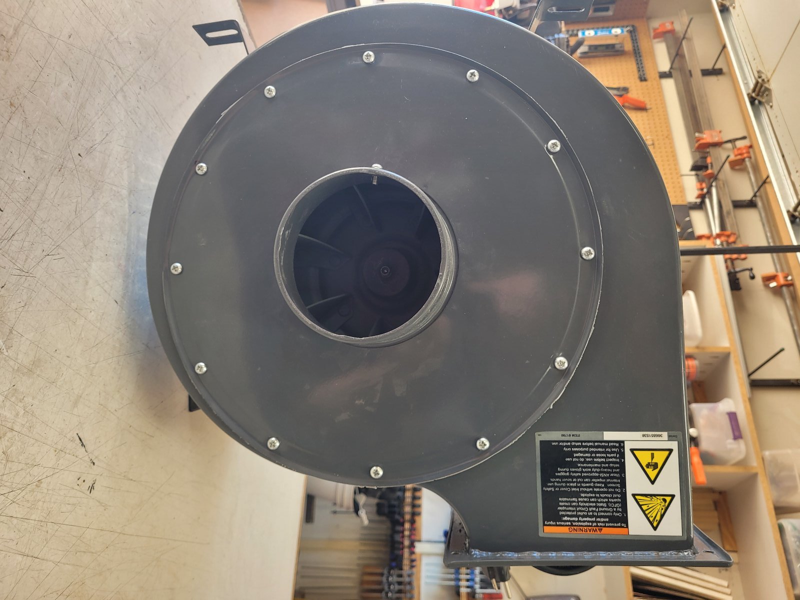

Today I disassembled the blower and installed the new impeller. The blades fit very close to the front cover. If I lay the assembly on the intake port, it touches in one place. I did not turn it on, just turned thru the exhaust by hand. I think I am going to find a 1/4" thick by 1/2" wide gasket and install with the original gasket. After some compression, I believe that there will be enough space for the cover to flex a little and not scrape.
I rotated the blower housing 90° so the outlet is oriented where I need it while I had it apart.

Found the 6" to 5" reducer for adapting the blower to the SDD. Local big box and HF stores don't have the 5" flange, had to order from Amazon.
I found 1/2" thick by 3/4" wide weather stripping that worked great for a spacer between blower cover and housing. I compressed it to about 1/8" and there is plenty of clearance now. Required a clamp and some bad words, but I got there.

I was expecting a fight when I removed the impeller yesterday but it came off easily using a puller. New one went in easily as well. I was happy with that.

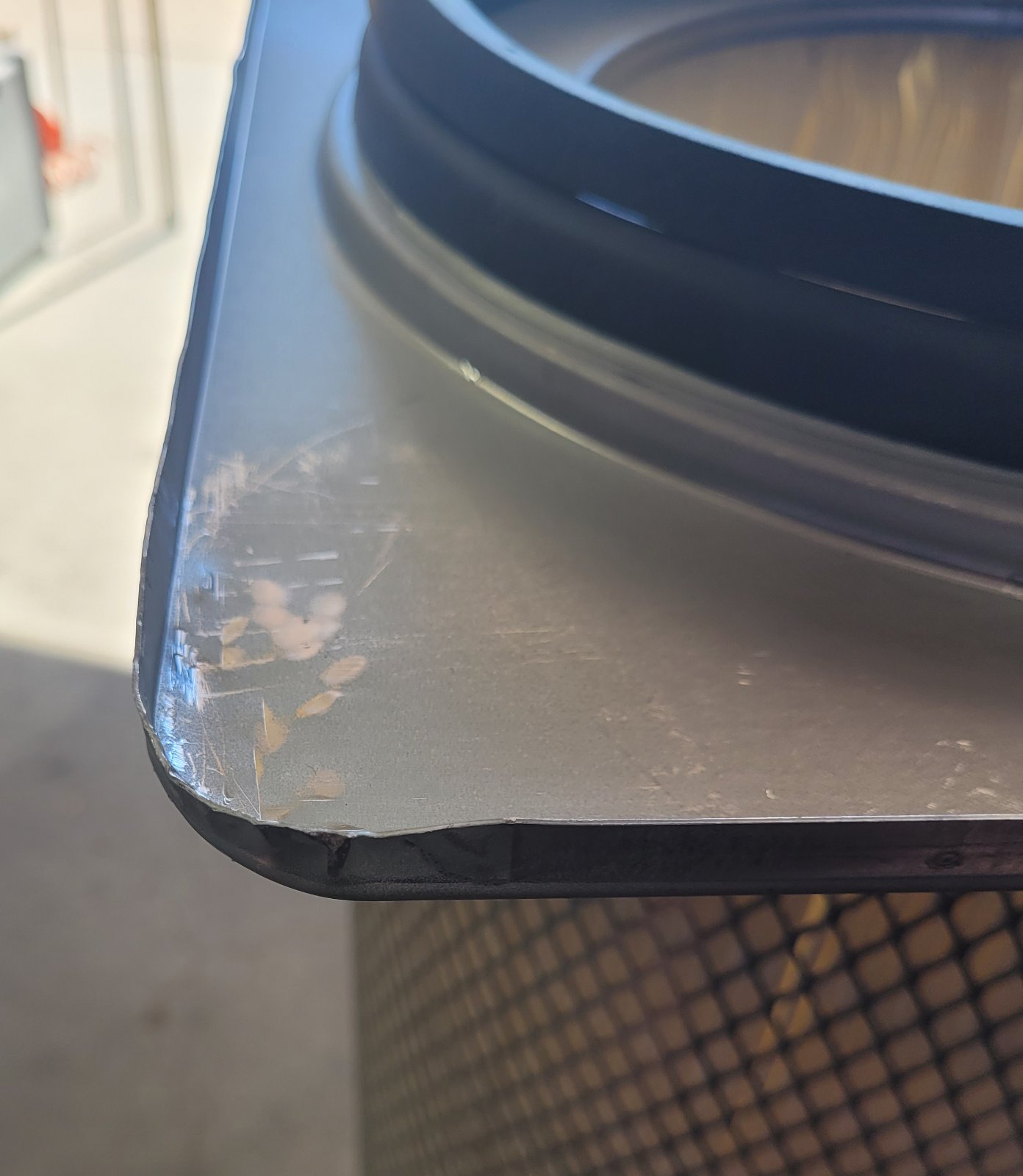

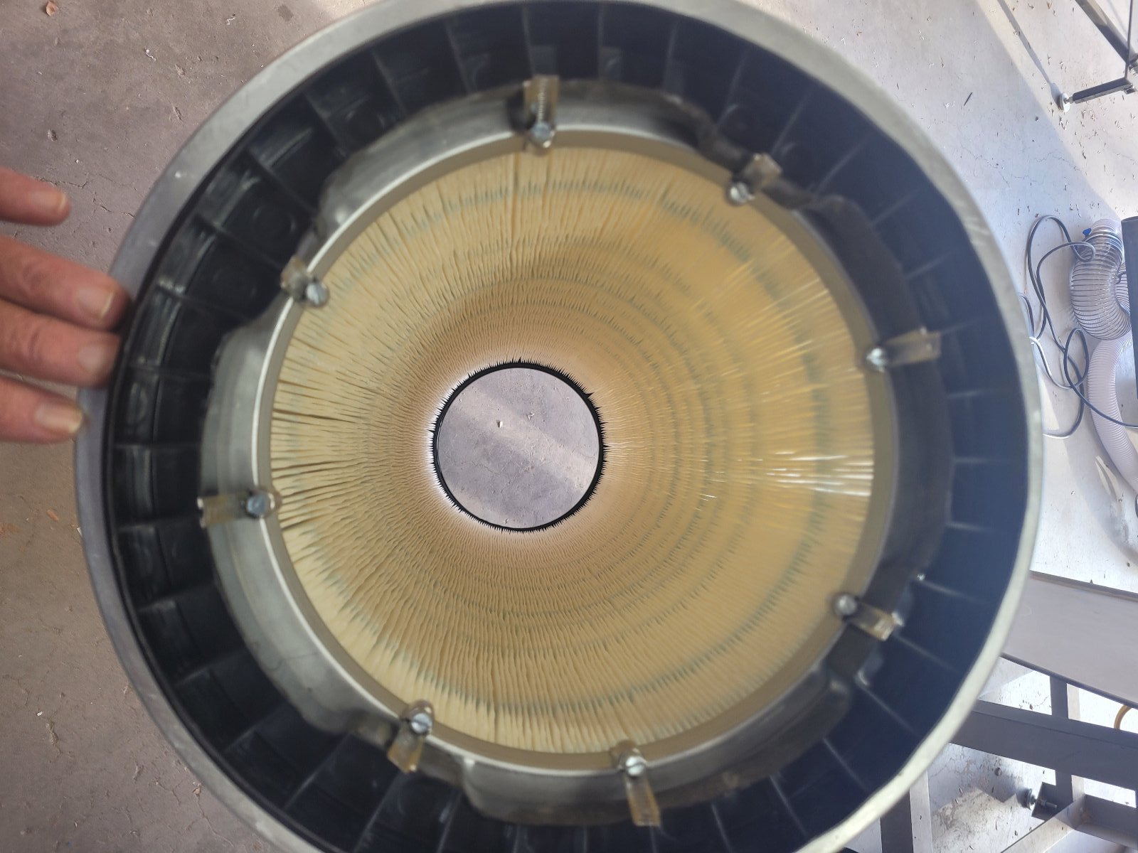

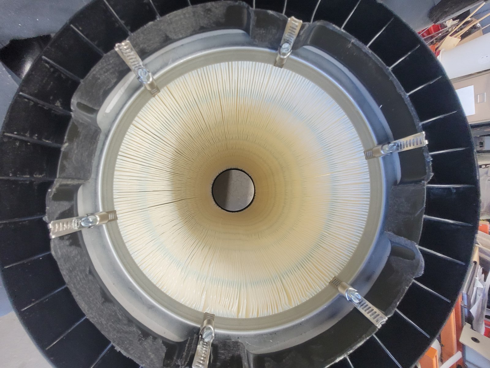

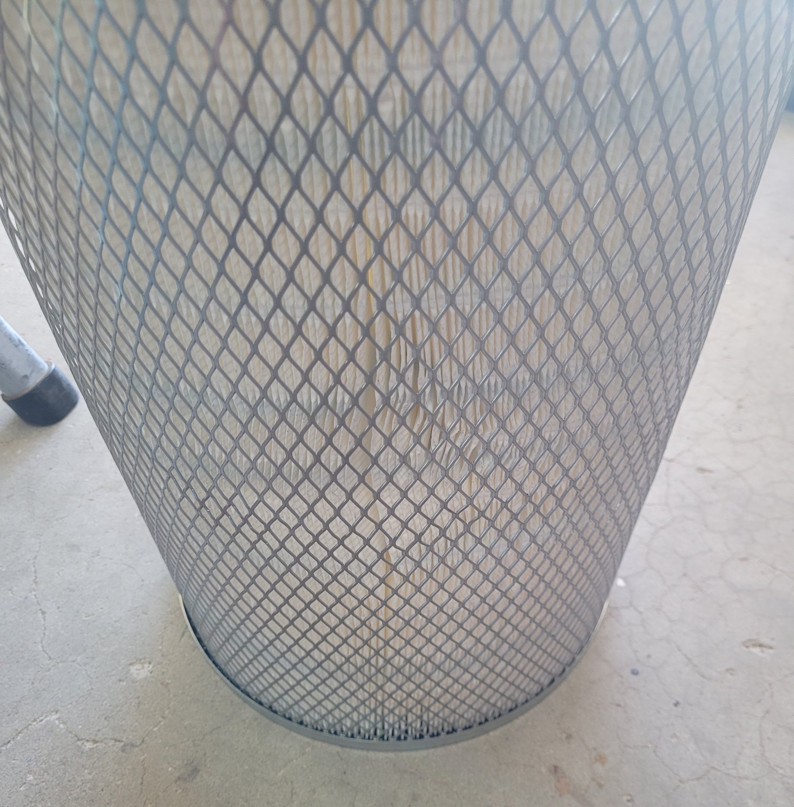

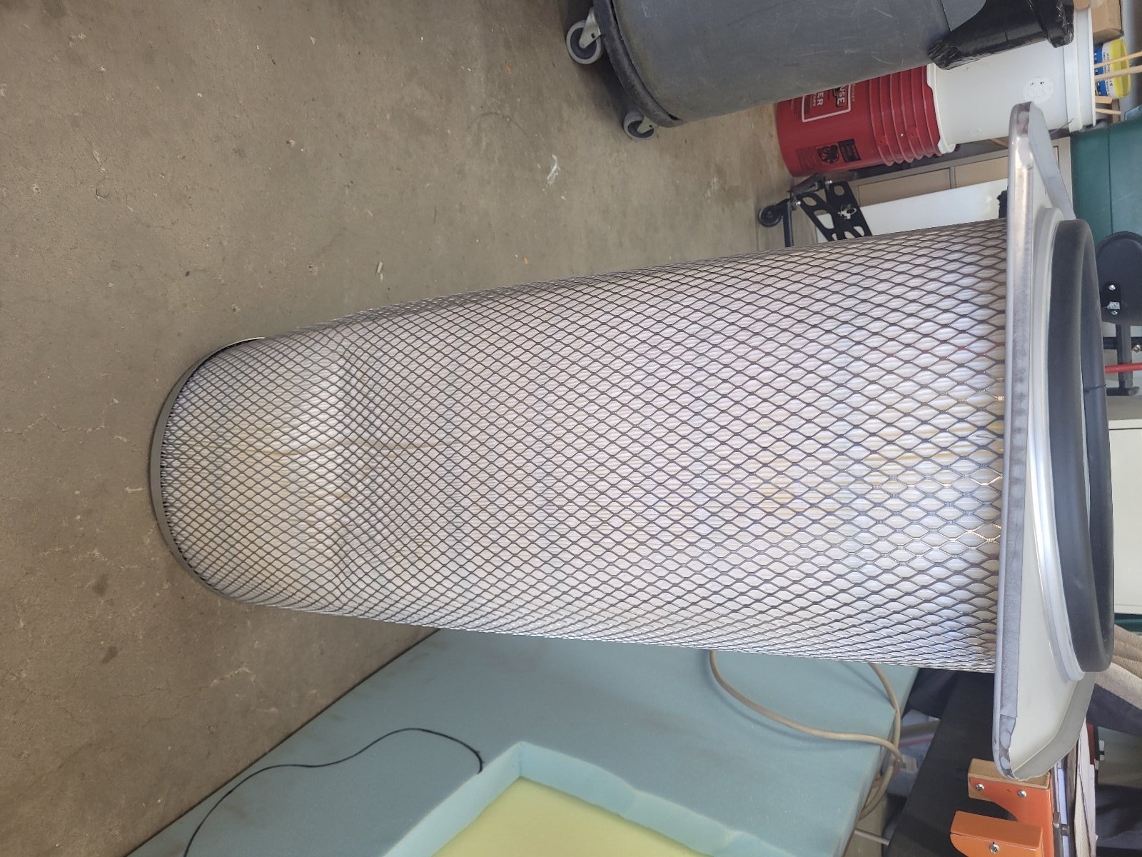

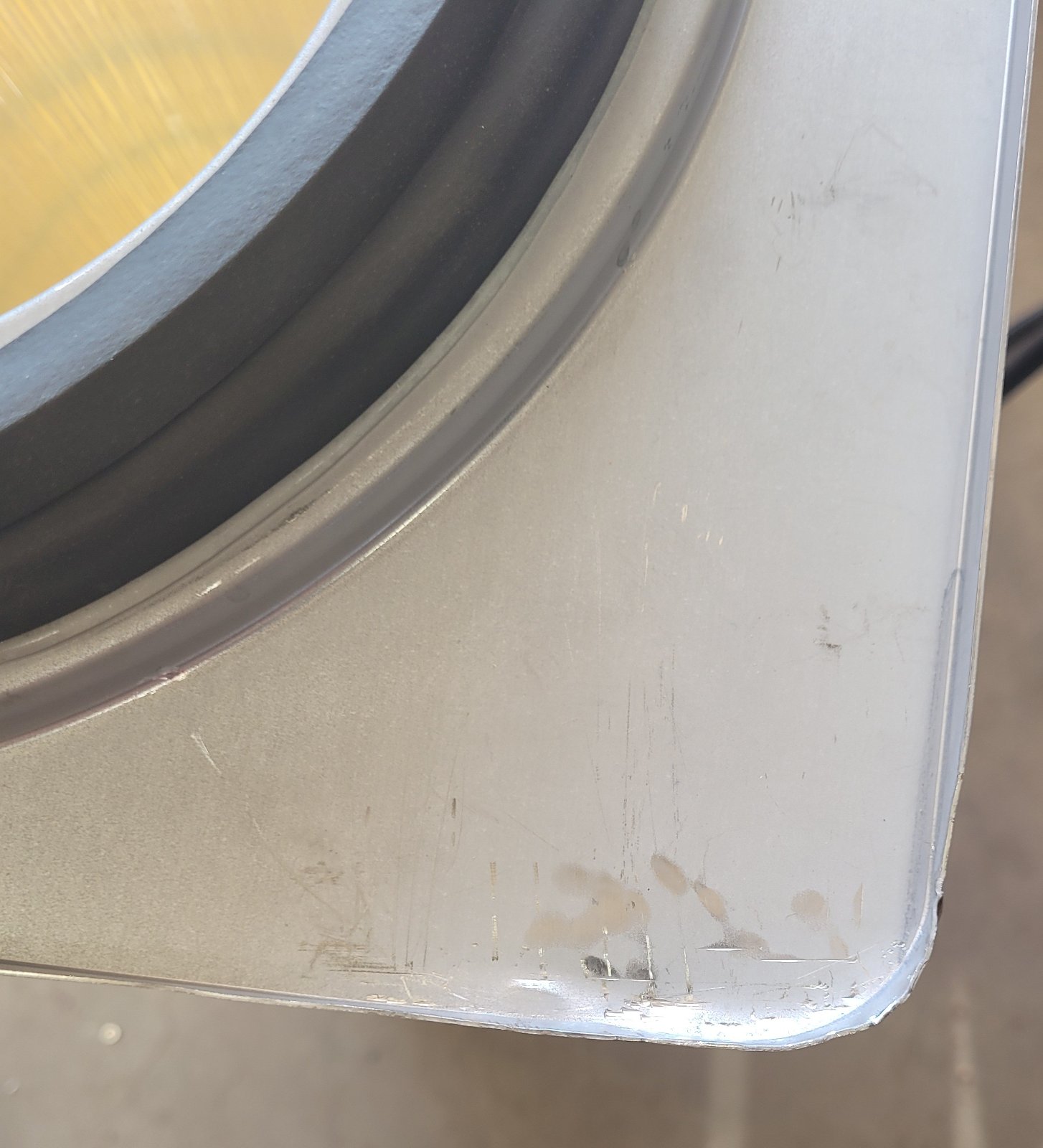

Wynn filter showed up via UPS this morning and it is crushed. It's not usable. I am going to straighten it and use it for measuring and building my supports anyway. Wynn is sending me a new filter Monday.
Pics of new blower seal and damaged filter.
Mike

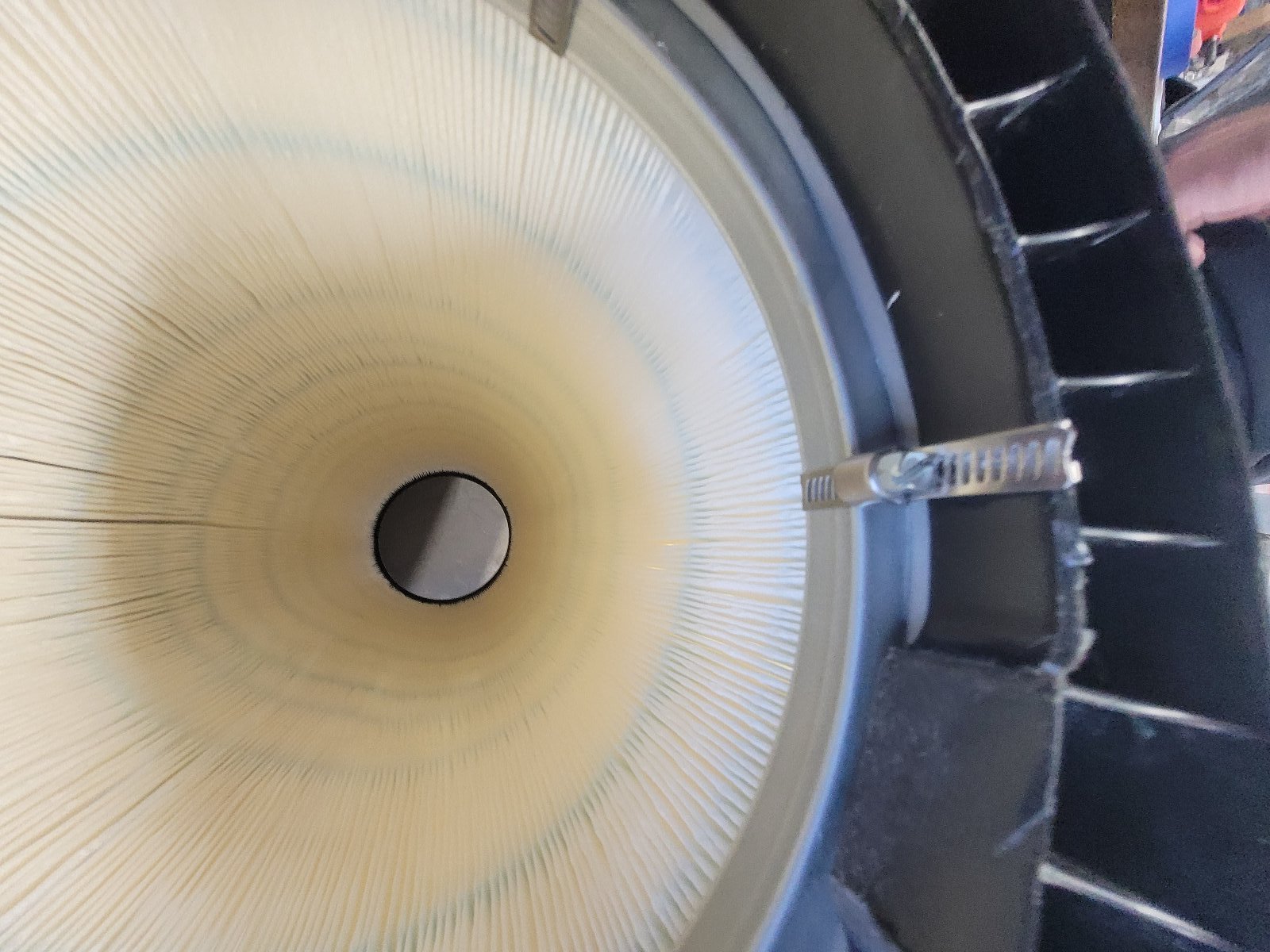

I straightened the flange and pulled the expanded steel surround out on the damaged filter. It might even be usable. I can definitely use it for my structure build this weekend. I took a picture of the blower and SDD on its side on the workbench too. I found 4 leveling screws/feet and some T-nuts I already had. Picked up most of the parts for the leveler/lift I am going to shamelessly copy from Dave Bondi. I am going to work on that tomorrow. The leveling screws/feet are way longer than I need, but I will cut them when I am sure of the total height needed. My son is coming over Sunday to help with the heavy stuff.
Mike

Nice progress Mike! Sorry about the filter - you would think Wynn would have packaged that a bit better.

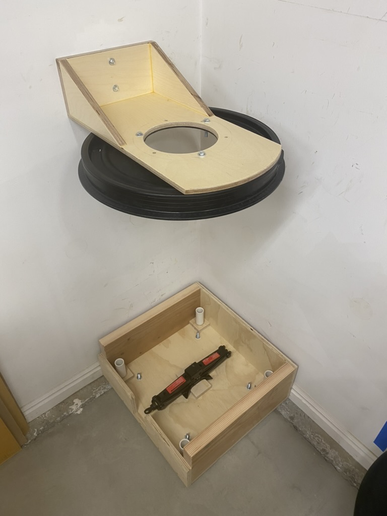

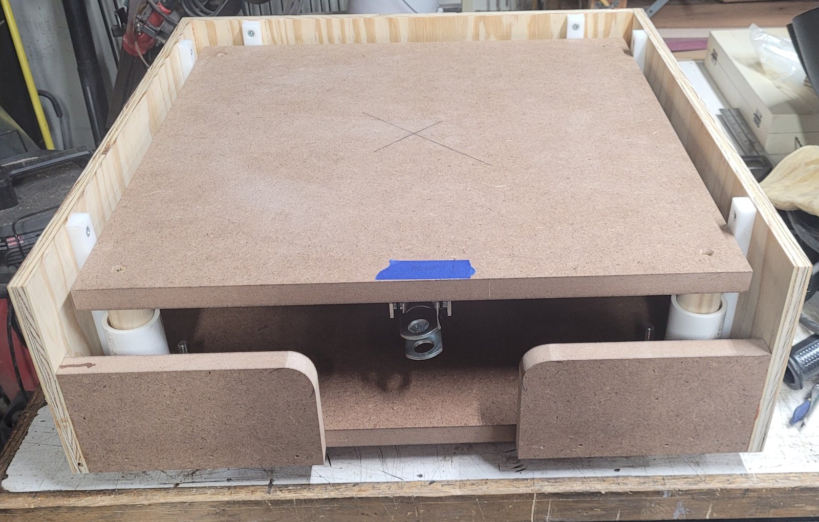

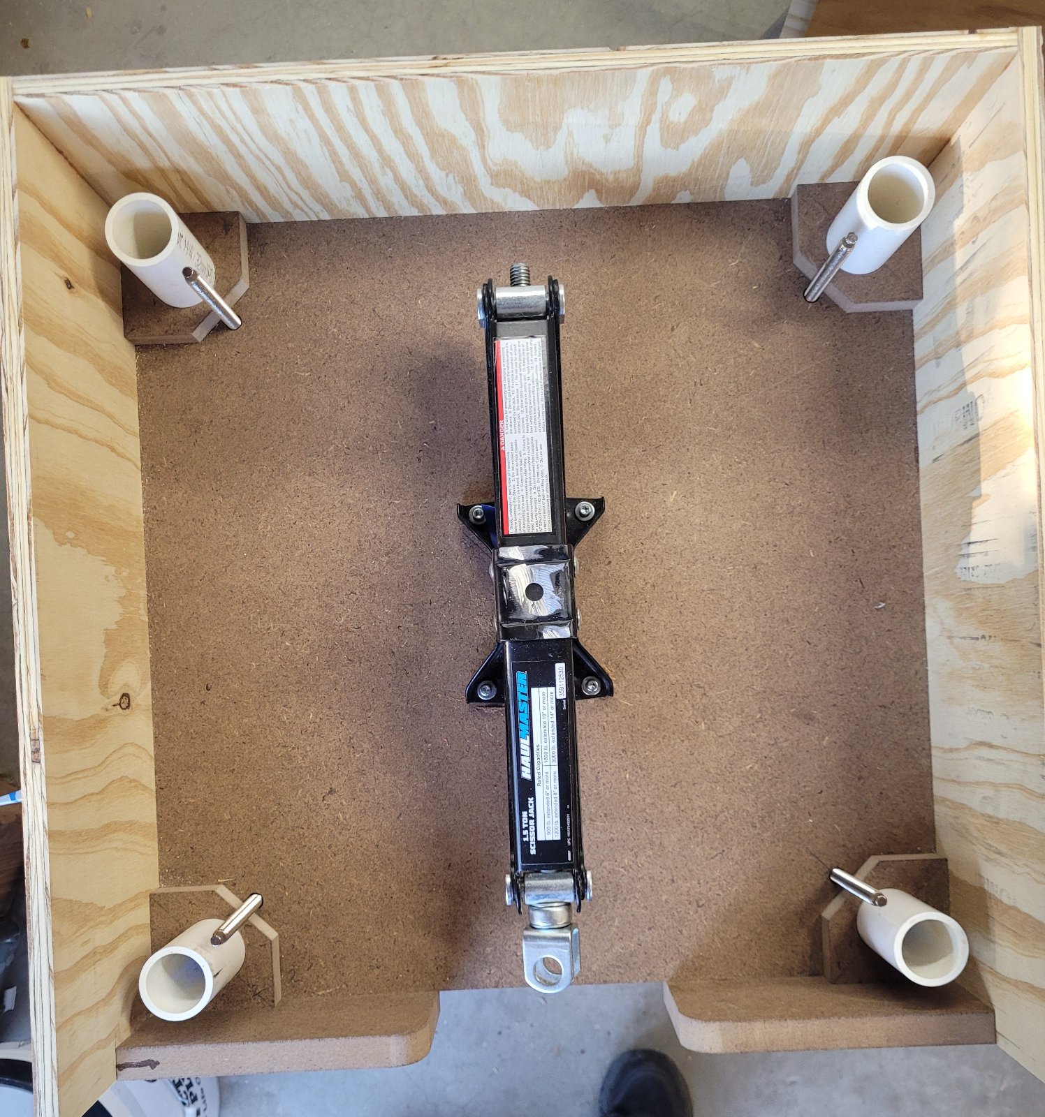

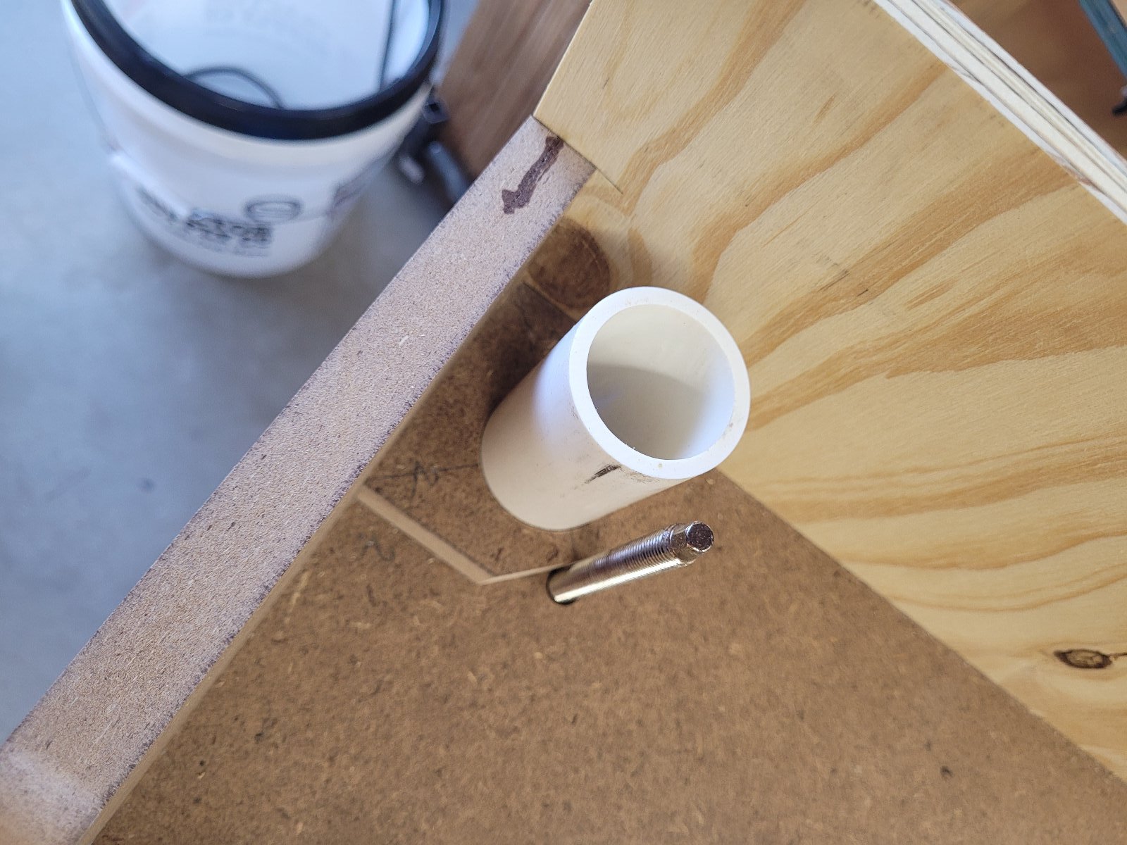

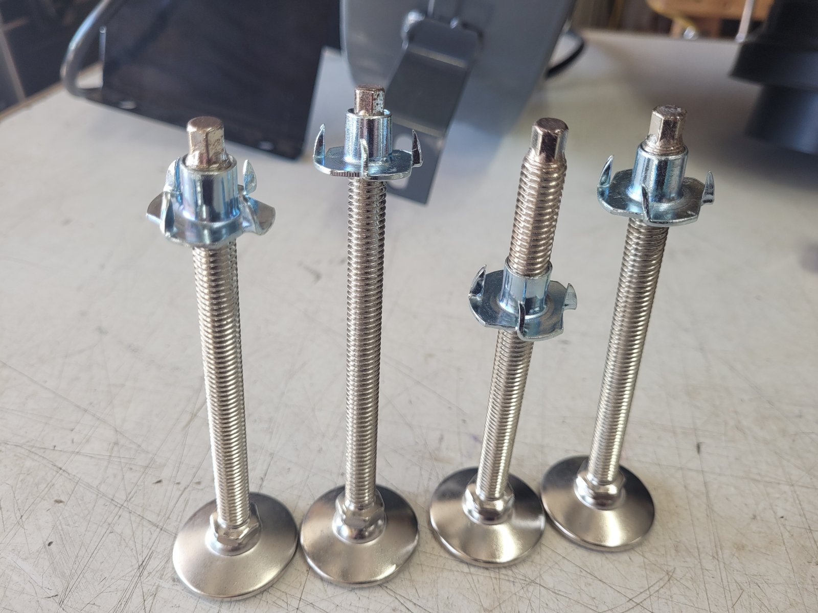

So, I have been in the garage most of the day and am almost done with the leveling jack. I got the leveler bottom made with the holes drilled and matched up to the top (the part that moves up and down). I bought a HF screw jack, only $23. It had a swivel thingy on the top and I cut it off with the grinder and now it looks like Dave's.

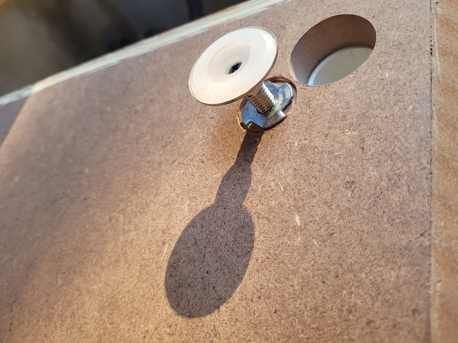

Dave, I have a question about the jack. Is it bolted to the bottom? And/or the top? Can't really tell in the picture showing the jack. I have the hardware to do whatever I need to and a welder if needed.
Thanks for the suggestions everyone. I already have hoses and connectors, but I like the swivel and the mag hookup. I may look into those in a week or two.
Mike
Hi Mike,
I am not currently at home so I can't look for sure, but...
I am pretty sure that the jack is not attached to the base or lift plate with any type of fastener. Here is a better photo of base that shows the two shaped pieces of wood, one on either side of the base of the jack. It is possible that I used fasteners but I cannot see them in the photo.
I don't have any photos of the underside of the lift plate, but my guess is that I cut a piece of wood with a center cutout the shape of the top of the jack and that it simply sits on that. The large dowels inside the PVC pipe guides is what keeps everything aligned.
I can check to be 100% sure when I am back home later this week.
David
David, thank you for your help. I used the PVC and dowel guides like yours. I drilled the base of the jack and bolted it to the lift base. I know in the past on the rare occasion I used a screw jack, they tend to flop around and fall over when you are raising them until they have weight on them and I didn't want that. I am going to finish the leveler this morning and hopefully get the system attached to the wall by end of day. It definitely won't be as pretty as yours, but should be functional. After I put the Wen impeller in blower, it moves a lot more air. And I verified the AC circuit 20 amp.
Thanks again,
Mike

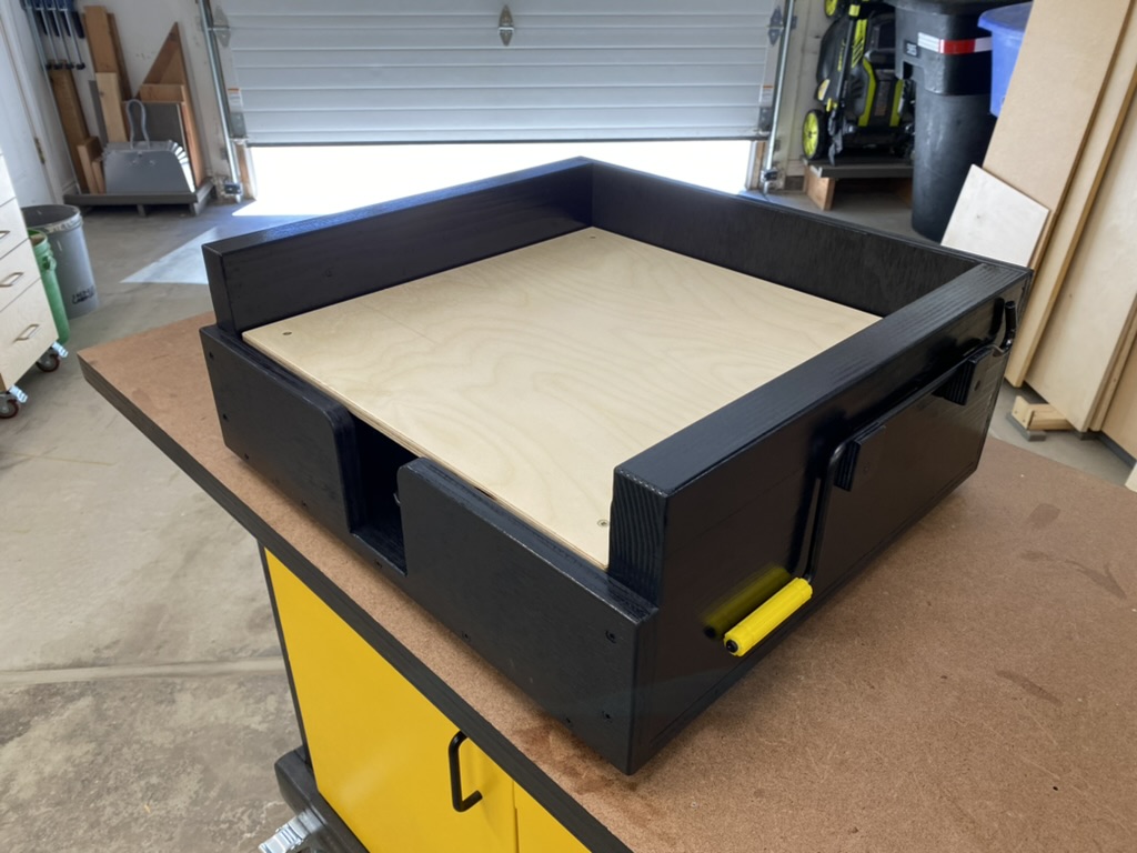

My son came over Sunday and Monday and we got all the heavy stuff done. Not only is he a great help, we also have a good time hanging out. Installed 3/4" plywood on the wall, blower bolted to wall and positioning of the Wynn filter. Tuesday and today, I mostly finished the leveler and got some guide rails installed in the left, right and back. It is finished except for paint and it has been raining and sprinkling here and I don't like to use rattle cans in the garage. I installed the Gamma seal on the bottom of the Wynn filter and made an interface for the 5" flange on the top. Also built the bracket to hang the Wynn filter on the wall and got it installed and the filter on it. Here are some pics, I will take some more in the next couple days after I get things cleaned up. I am going to put the barrel on the leveler and do a test run tomorrow and hopefully get the garage cleaned up. The replacement filter should be here tomorrow.
Mike

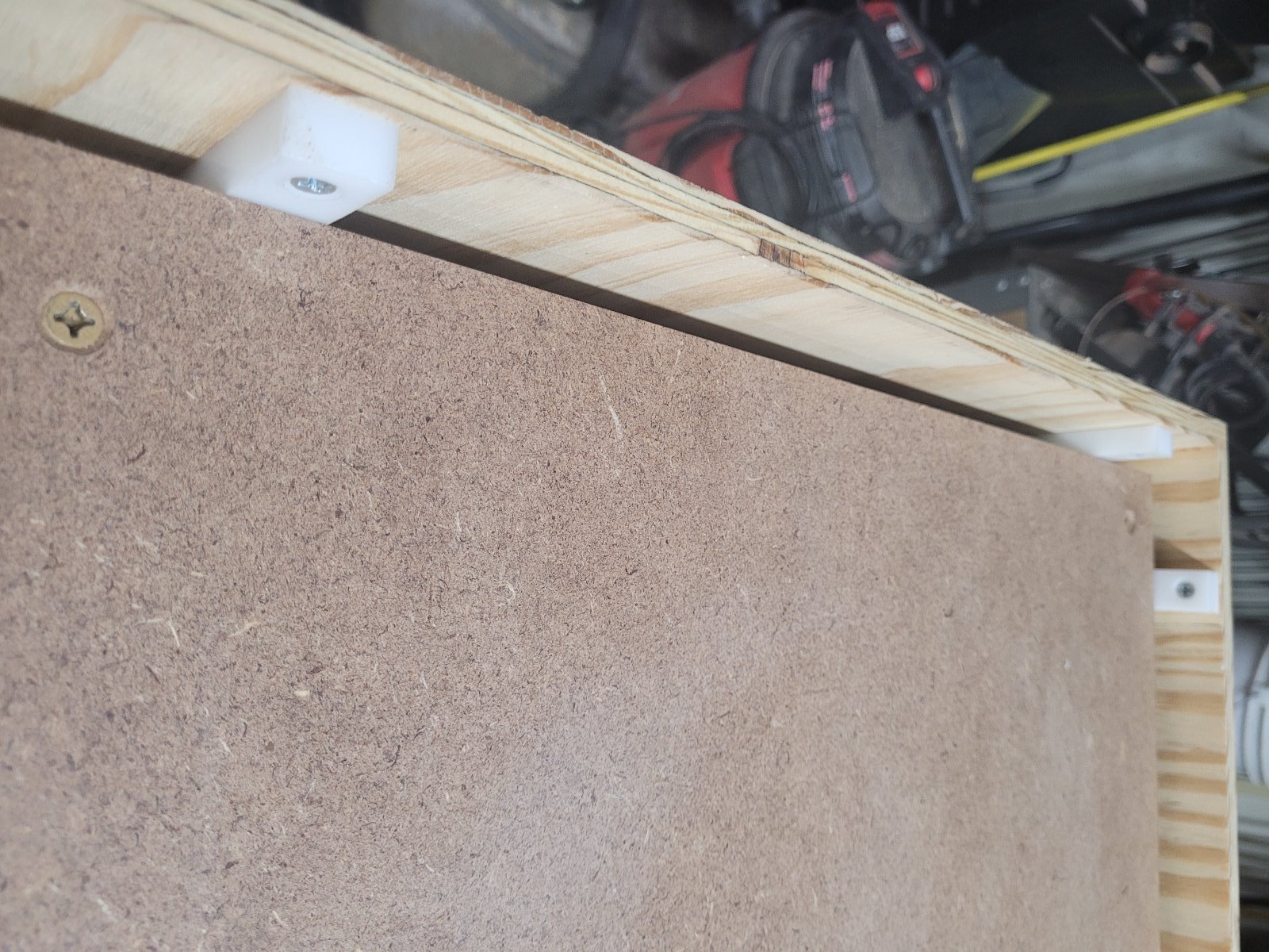

It is looking great Mike! I like the glides you added in the margin between the sides and the lift plate.

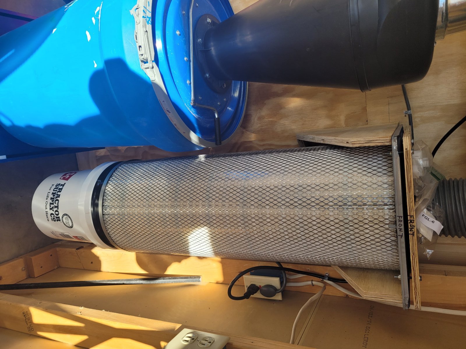

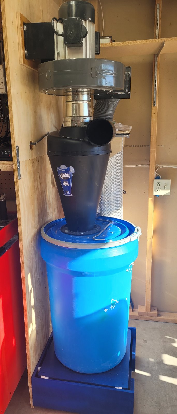

Finally got the DC upgrade finished. I still have to build a sound deadening surround for it. I think I am going to use something loke the Rockwool safe n sound insulation. Still have to do some research on that. I have 5" metal duct with fittings to install across the ceiling to tie in my sanders. So still a lot of small stuff to do, but getting closer. Not bad for an old fart. Of course, I had help from my son and my wife.
1st Pic is the gamma seal lid after cutting out the center and using the little FGL-6 latches from Wynn to attach to bottom of Wynn filter.
Other 2 pics are 2 views of the DC installation.
