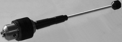

I think seen this posted before, but I can't find the post. Is there a way to keep a Morse taper drill chuck from coming out of my lathe if I am not using a tail stock center?

Assuming that you have the drill chuck in the headstock, if your headstock has a straight-through hole, get a properly threaded and length bolt to use as a draw bar. Alternately, you can use a piece of properly threaded rod plus a washer and wing nut to accomplish the same thing.

From my perspective, do not "whack" anything to get it to stick into the headstock where the tailstock is not supported. At 3900 RPM and 1/2 hp, that can create a fairly dangerous three-pound flying object.

Agree with lou. My opinion is that a drawbar is the ONLY safe way to use any MT accessory unless it's secured with a collet nut on the outer spindle threads. (like a collet chuck for 1x8 spindles, for example)

Take a close look at the taper on your drill press. I believe you will see that there is a tang on the end of the taper that fits into a corresponding slot in the quill. The torque is transferred from the quill to the chuck through this tang and not from the tapered surface. Thus, the taper only has to hold the weight of the chuck and should not slip off easily. Wood lathes have morse tapers without the tang. So, they must provide the friction necessary to transfer the torque from the lathe spindle to the tooling with the taper. If too much torque is required, the taper will slip. With an active force pushing the taper into the spindle, the maximum allowable torque is greater and if slip does occur the taper will 'catch' again without coming out. Without the active force, a slipping taper WILL slide out of the spindle since there is nothing to restrain it or push it back. A drawbar or the tailstock can provide the necessary restraining force.

Check to see if your Jacobs chuck (drill chuck) is threaded at the morse taper end. If it is take it to the local hardware store purchase a length of threaded rod, an appropriate nut or knob and perhaps a washer. Back home insert the chuck in the tailstock, thread in the rod and cut it to the length where the knob or nut will hold it in securely.

My #2 taper does have a thread and it fits a 1/4 inch bolt I have. All I need to do is find a 1/4 x 7 or so rod with nut or bolt and a washer to fit. What amazed me is I could find no reference to this in a book I got from the library.
