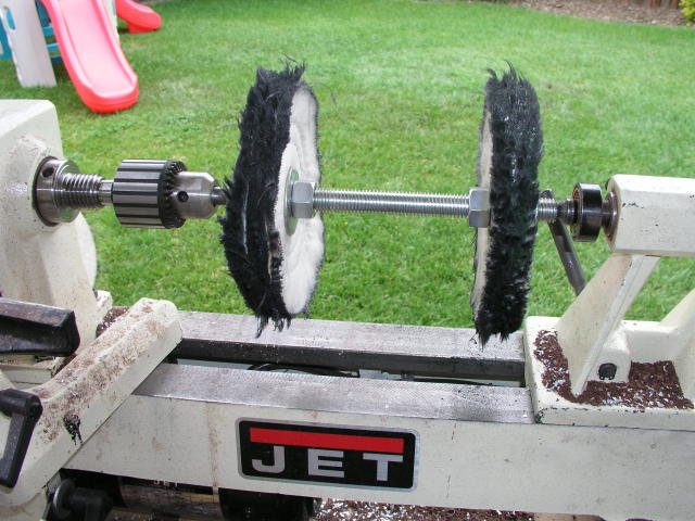

Here is what I use:
I have different wheels for different stock. These are my aluminum wheels, hence the black residue. It was under 15 bucks for the whole setup with two wheels. 5/8" threaded rod, turned down on one end to fit the jacobs, and center tapped on one end for the live center.
Fangar
