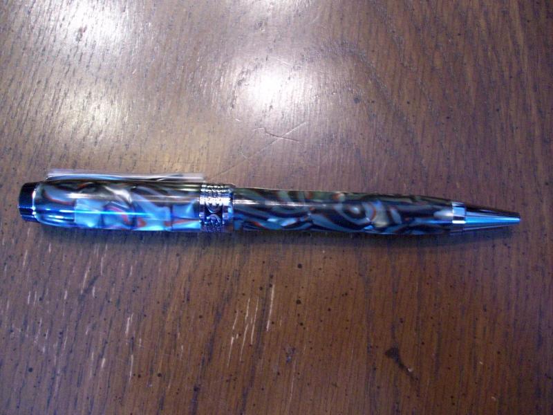

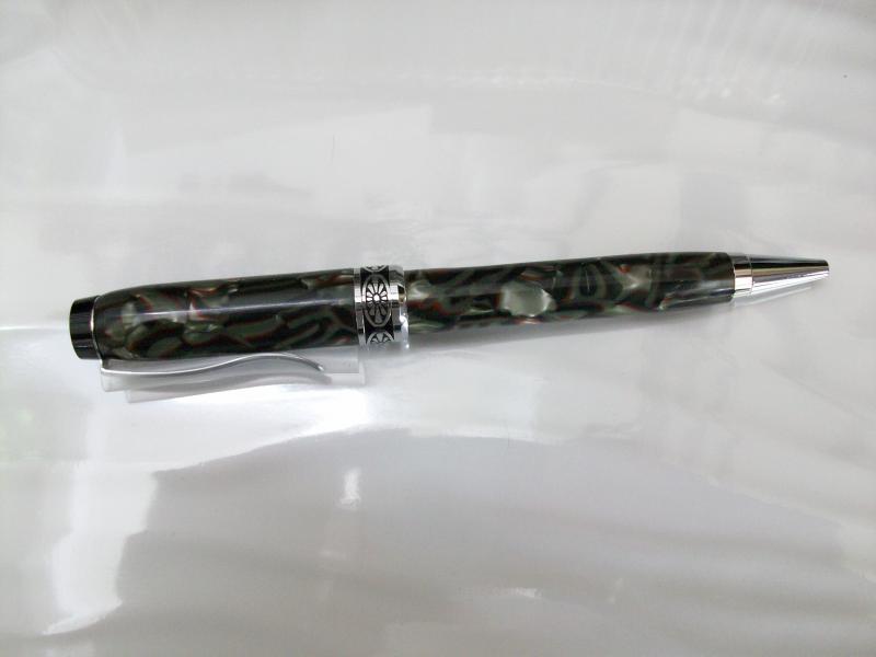

Ok guys and gals. We did what you said. Spent the first 30 minutes sharpening my skew and gouge on the ole trusty Tormek. (Still ain't got it down pat but it's getting better)
Drilled at 700: worked great! Turned at 4950, well that is what it was with no load: worked great!
Took a couple pictures for your perusal. Still suck at photography but I think too many skills dulls the mind!
Your comments are welcome.

Nice work man. I've only turned 1 Acrylic so far, so I don't have much experience to speak from but those 2 look pretty good to me.
