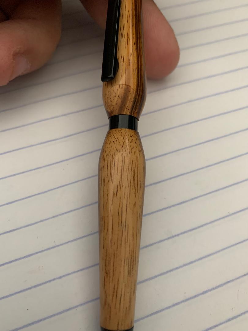

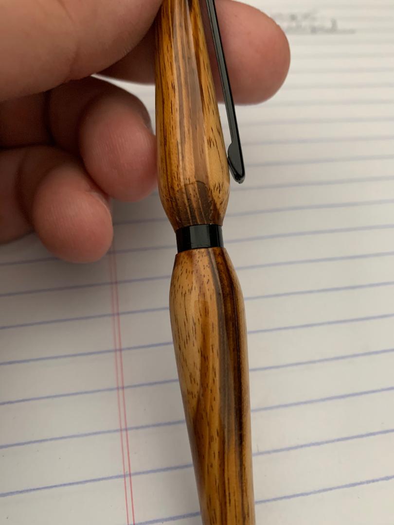

Can you post a photo of the problem/defect
jttheclockman
Feb 22, 2005
19,150
NJ, USA.
That is an adhesion problem. Not sure what the wood is but is probably an oily wood and needs to be cleaned with DNA or acetone before CA is applied. Also sure does look like a thick coat of CA. Too thick for what you are doing. I will say again also that the use of that many med coats and accelerator makes the CA brittle. When you insert parts the wood will expand and there is no flexibility in the finish. Some people choose flex CA just for that reason but to me loosen the tension in the tube for the parts as I said and also use 3 coats thin and 4 coats med. More is always not better. Does nothing for looks. Some people say it gives a deeper look but I do not agree. Aslo you did not say what CA you are using. People here have had problems with Stickfast.

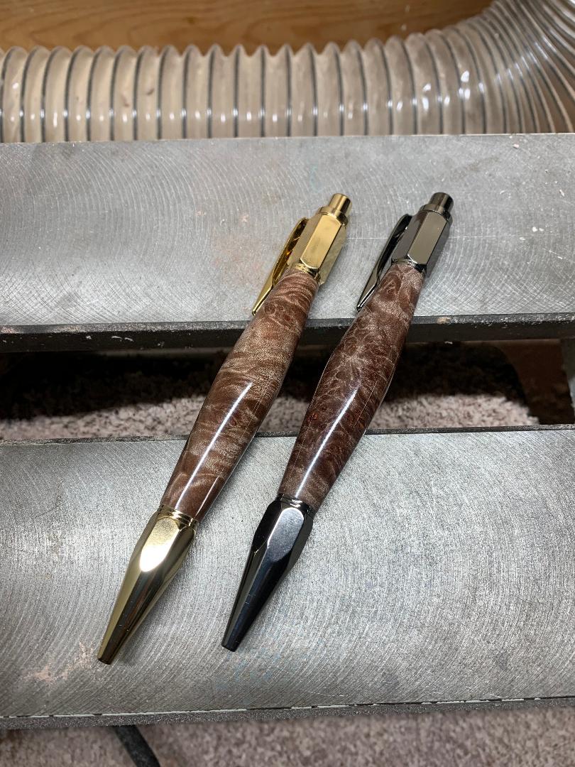

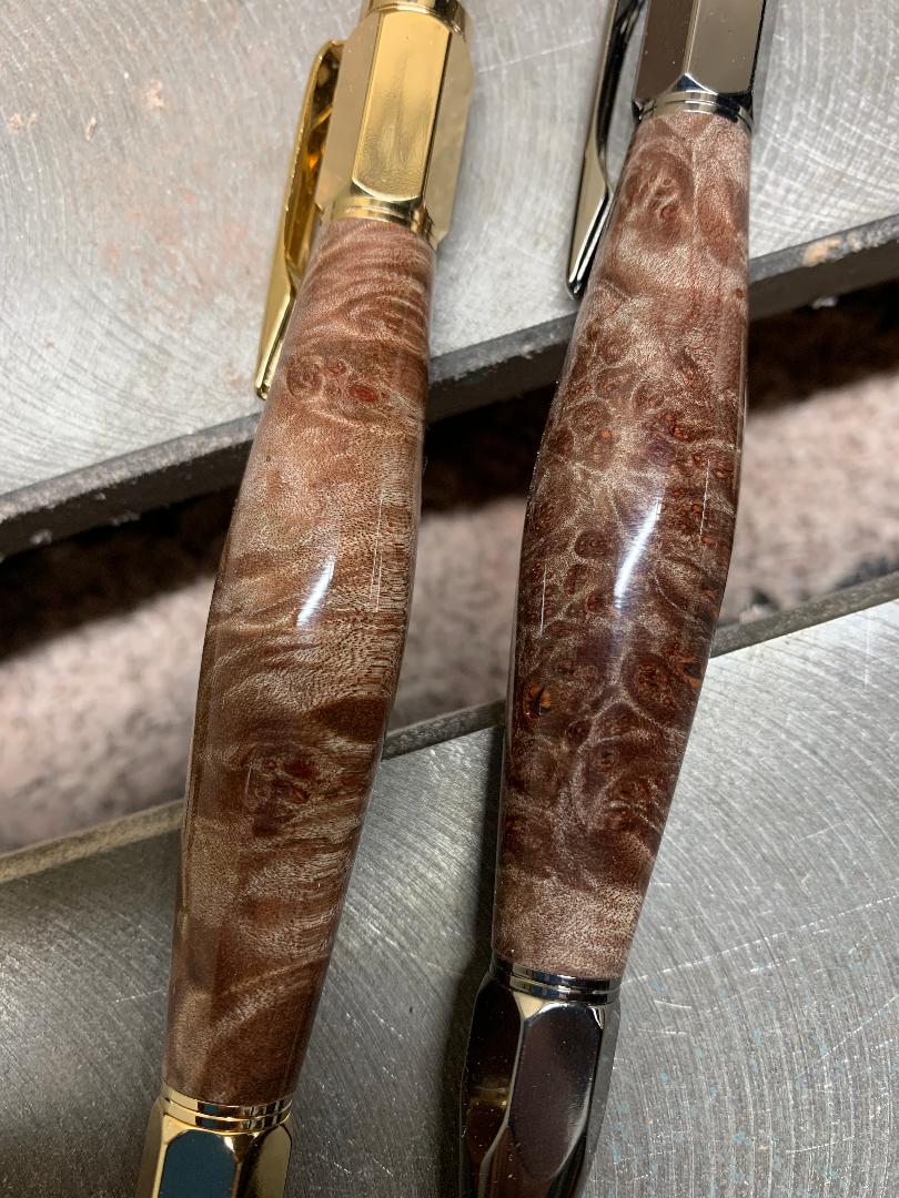

REDEMPTION!!!! Curly maple burl. 2 coats of thin CA natural dry, 4-5 coats medium CA half dry then accelerator. Polished with 12k grit micro mesh. These click pen kits are much more appealing than the slim lines. Thanks again for the input everyone!

Not wishing to appear too critical? But l have a problem with this pen design. In my view the blank is too thick, especially at the clip end. Due to the shape, the clip is pushed outwards more than it should. This will make clipping the pen to a pocket or book, very difficult. It also adds pressure onto the pen surface. I personally would turn the pen to a smaller diameter. I for one am not a fan of the fat body, thin waist look.
MMWW
Oct 28, 2020
12
Hannawa Falls, NY
I agree. I do like the look of it, but it does stress the clip quite a bit. Still getting a feel for shapes. Feel free to share some pictures!!
