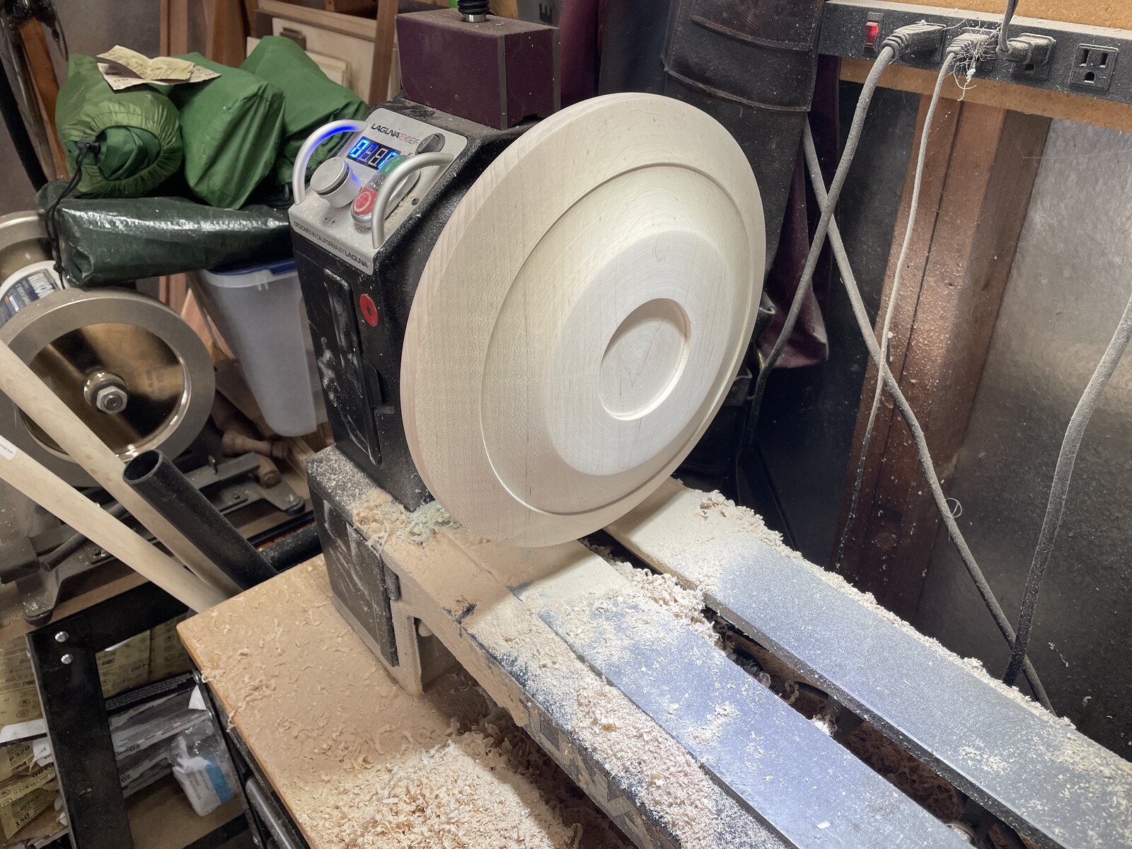

This is coming along well I think.

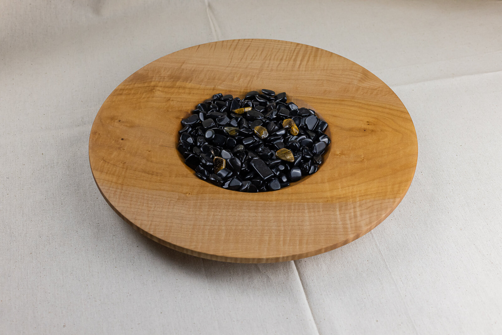

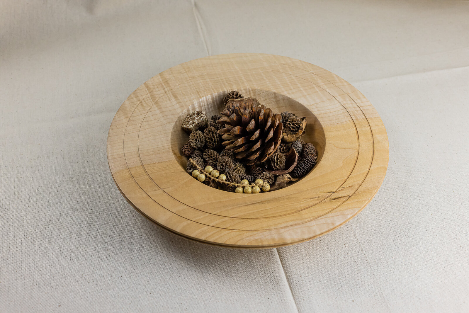

Here are a couple of mine that I recently made, after watching this very video. Both grade AAA ripple figured maple, although just not as nice as the ones you see Jimmy usually turning:
I think I left too much rim, and not enough bowl...will try to fix that next time.
