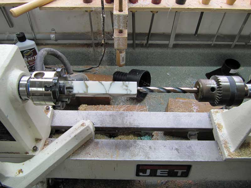

I can't seem to find a link or site that has the 4 jaw mini chuck that I can just throw a square blank on. I have a mini 3 Jaw for rounds, but need a four. Any help would be appreciated.
Martin
You should be able to put a square blank in any four jaw chuck. Provided you are talking about pen blanks.
I use my Barracuda2 chuck for that quite often.
Just put the points of the square between the jaws, rather than in them.

Hi Martin; I know this isn't a 4 jaw chuck but it's what I use all most exclusively for drilling pen blanks.
http://www.pennstateind.com/store/CSCPENCHK.html
I also have 3 of these 4 jaws with an assortment of jaws which used to be used for drilling on the lathe.
http://www.oneway.ca/chucks/index.htm
Take your pick. I'm certain you will get many different answers than mine!

The Barracuda 2 uses a key...
http://www.pennstateind.com/store/CSC3000C.html
And for $20 more, you could have the TiN coated.
