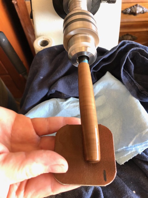

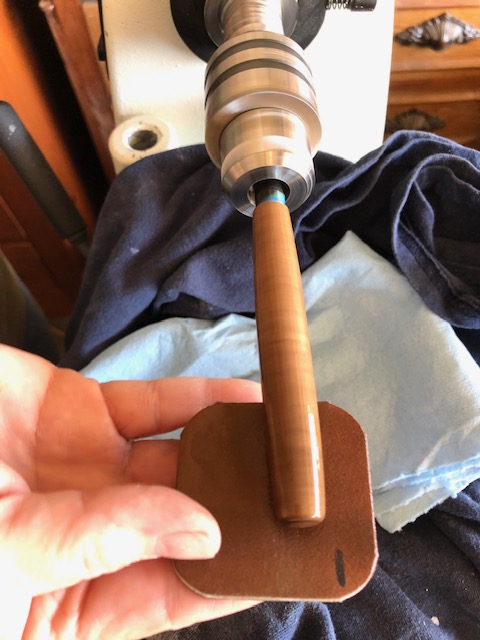

I've been having to do some Macgyvering because we don't have all the tools. I've figured out using a Jacobs Chuck(on the headstock) with a punch that fits snuggly in the tube (and wrapping a bit of painters tape on the punch) creates a crude jamb chuck that allows for sanding.
I have to give credit to itsvirgil, his article mentions using a sort of jamb chuck, we improvised.
An image of how it's set up, it's not ideal (not the proper tool) but works in a pinch.

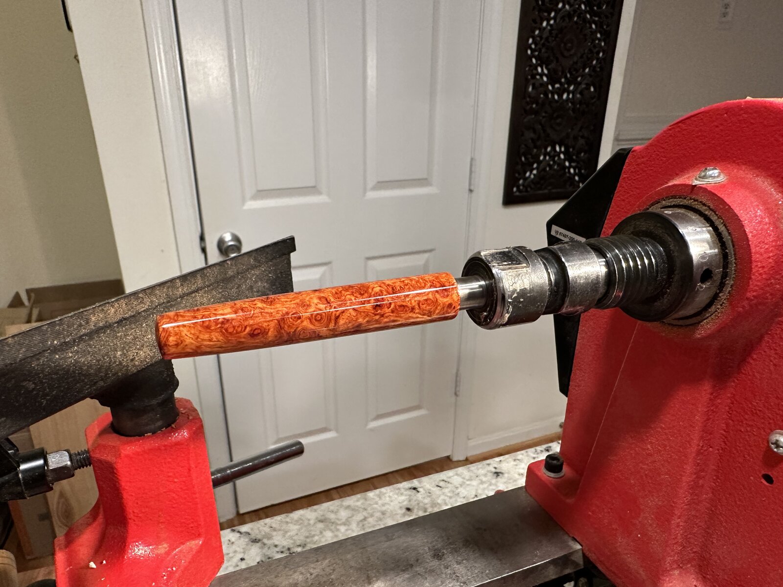

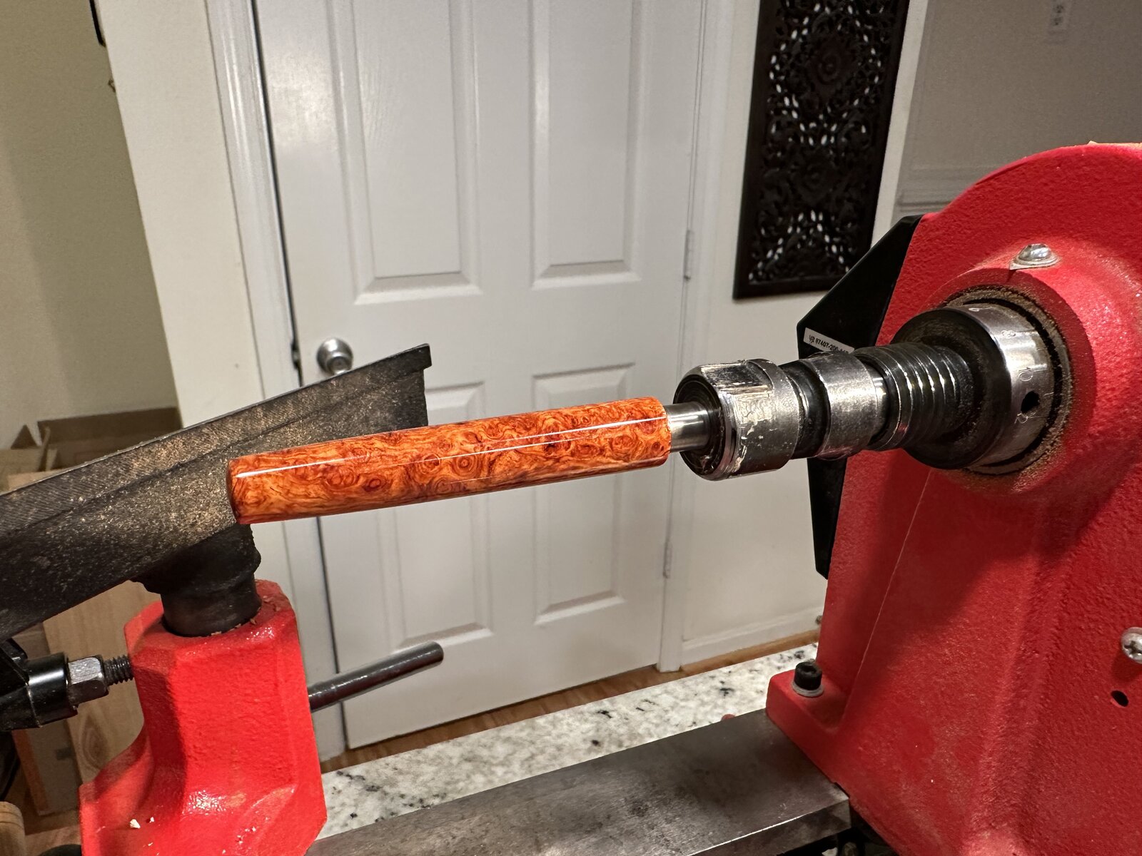

I love my Big Grabber! It's solid as a rock as long as you use it right. Use a tailstock for support while shaping the length of the blank. Save the end of the blank for last and use a skew to shape with pressure applied toward the headstock so you don't work the morse taper lose (a good seating at the beginning is usually enough, but it's best to play it safe). I will admit, figuring out the order of operations to get a blank locked into place can seem confusing, but it 100% makes sense when you figure it out. If you end up buy one and need assistance, let me know!
I started using it to make closed end kits, but I've continued to use it for all of my kitless pens now. Here is one on the lathe as I type...
I've enjoyed it so much, I even bought the regular "Grabber" (when those were still being sold) so that I could make a full range of pen sizes.
