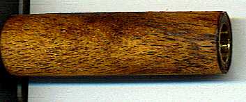

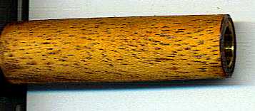

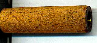

I glued up a Koa blank (my only one) for one of my Cigars and while I was turning it down I noticed the grain is acting like it's running in opposite directions on either side of the blank (upper and lower). Most of the blank is turning smooth, but almost 1/6 of each piece looks almost like the tearout you sometimes get from a planer if the board has grain that is angled upward. Tools are sharp (I checked twice) so that isn't the problem. I tried saturating both in CA, but that didn't help. Wouldn't get in far enough I guess. The only thing I can think of that I haven't tried is wetting the blanks with water. I've done this with figured woods being run through a planer to prevent tearout, but they are substantially larger and raising the grain isn't such an issue. Do any of you experts have any suggestions? I have these almost down to finished size and I'd like to get a good pen out of them.

This pic is the rough side of the upper.
This is the smooth side of the same piece.
This is the rough side of the lower. The problem I'm speaking of is a little easier to see.

personally having already done the things you have stated I would rough turn and switch to 80 grit to get it to final size.

If you are getting moving grain in each portion of the blank, I suspect you have figured koa--which is highly prized! If you can post a picture of the blank it would help. If it is figured, I would strongly recommend an extremely light tough with a skew to finish turning--even using sandpaper for the last couple of 32nds.

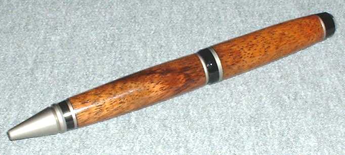

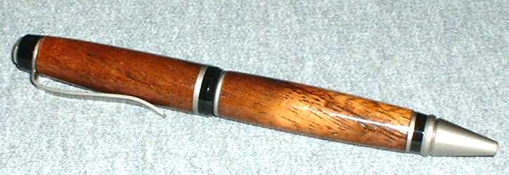

All, I finally finished the pen and all in all, I'm quite pleased with how it turned out. Take a look.
<br />
Other side
<br />
I also used a different finish than I've been using and I think I like it. Three coats of lacquer sanding sealer followed by three coats of Deft lacquer (brushed on) and buffed out. It takes longer, but based on the woes I've been reading about FP finishes not wearing well I decided to give this a try. Although the pics don't really pic up the sheen, this pen is GLOSSY!
Again, thanks to everyone for the suggestions. You saved the day on this one!
