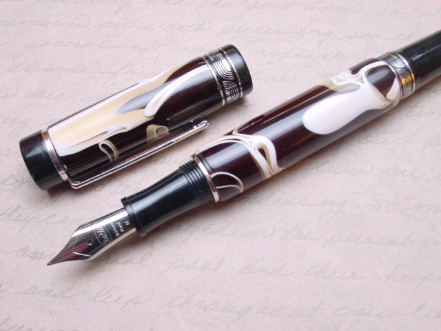

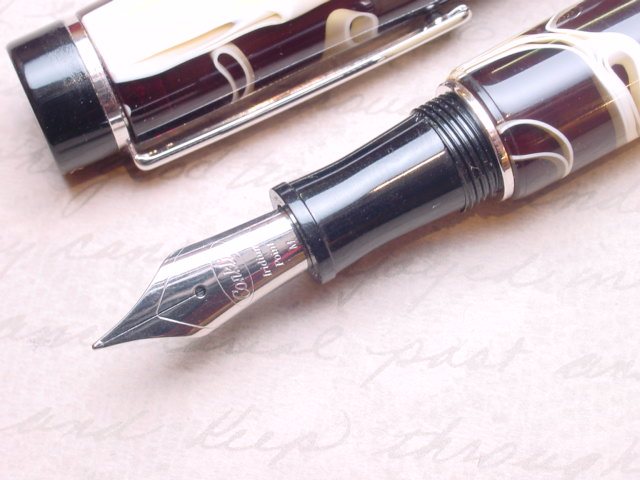

Thanks, Mac, you made me try something last night. Take a close look at this pen, rather NIB. (but the pen did come out nice for just a quikie thought). Notice it is a steel Conklin nib. writes pretty good, for just the little test I did from last night. So here is your custom steel nib pen.
I can get all the custom steel nibs you want for .75 cents (nib only)
Problem.......To have the stamping die made for the nib , about 800.00
Quanity needed to place the order, 5,000 per writing grade (about 4K)
If you want the matching feeder, nib & feeder & housing assembled for you, add 5.00 to that. The feeder & housing actually cost more than the steel nib,
The gold nib I have coming, will now fit the Ligero as well, you have Mac to thank for that one [:)] I will try the conversion for the El Grande this weekend.

Anthony, As usual the pen is beautiful. I really admire your workmanship.
