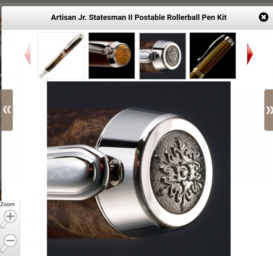

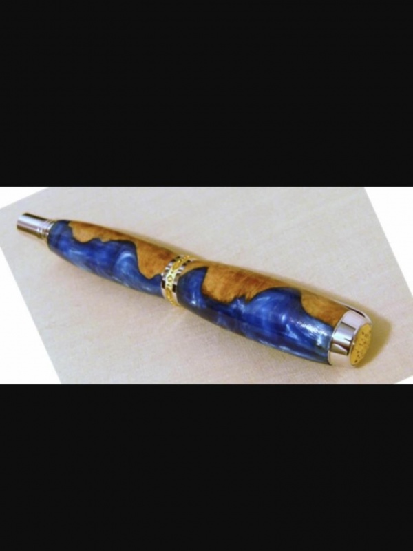

I am relatively new to pen turning and have just started selling the products I create. In the past, I have sold my items too cheap but have been working hard to create prices that are reasonable yet benefit me as well. That being said, I HAVE MY FIRST BIG ORDER! Not just one or two pens but BULK quantity. I have only created "low-cost" slimline resin/wood pens so far. This customer, wants a higher-end artisan/cigar style pen that cost anywhere from 25-35 dollars a kit. I'm adding $5-10 to each pen depending on quantity for blanks/labor. I have been doing my homework and comparing prices/quality on a lot of sites. There are just so many!! I narrowed it down to one specific style, on woodturnerscatalog.com, that I know my customer is 100% satisfied with design wise.. even though he has no idea how much they cost yet.
Fast forward 24 hours.. customer has asked to replace the cap portion (design) of the kit with their LOGO instead.. Great idea, but I have no idea how I should execute it. My significant other, just happens to be a machinist so he suggested either creating a die and pressing or stamping it into a type of metal or milling the logo in.
MY QUESTIONS ARE: How do I begin pricing 25, 50, 75, 100, 40-50 dollar pens (I think im pricing them too low)? What are the best places to order high quality pen kits in bulk!? I have to add machining work/material but I have no idea what i'll truly need until the pens are actually ordered. Does anyone have experience with bulk pricing and the time it takes to create 100 pens??
I am just feeling so overwhelmed. Picture of pen below. ANY advice would be great!! Thanks, in advance!

Ryan Krusac (ryankrusac.com) considers the statesman to be the highest quality kit. Go to his site to see his pricing. Cut it in half and discount a bit further for bulk sales to get in the ballpark. But it has to be top quality work!
Thanks, corgicoupe! I am at a loss for words, 400 dollar pens!? It definitely gives me something to go off of, though! Thank you!!
I haven't priced anything, yet. I'm well aware the items I've sold in the past were too cheap. However, most went to locals, friends, and family who have helped me get to where I am now. I want to make sure, I dont make that mistake in the future though, so that's why I am asking. Bulk quantity is new to me. Should I charge hourly, instead? Location, location.. How do I know which areas pay more?
If you are $40 in a kit and blank with custom finial costing another $10, if it was me I would start pricing at $200 per as a bulk order prices. $250 start for a single pen.
That is minimum
Price them all like you are in an area that can afford those prices.

Wow, thanks. I purchased one Statesman for a little over $35 yesterday, to turn a sample pen. I will definitely check out the Tritons! Are they similar in quality? What is the difference in the Statesman and the Jr. Stateman other than size?
My significant other, is a machinist so machining/milling the finials won't be a problem.. We hope. I did quote them boxes just in case! However, I didn't think about offering it as an alternative to the finials. I'll be sure to give them that option as well. Although, I dont think it will effect the price any.
I ordered a kit, at the same time, that comes with several drill bits and bushings for the Stateman kit. I'll be sure to get extras! Thank you, for the advice on maintaining quality and efficiency as well! I truly appreciate the help!! I sent an estimate to customer, yesterday. Praying it works out!
