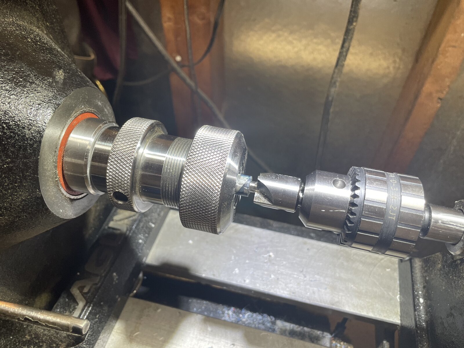

Here was my ultimate solution. Somewhat similar to what someone posted above. Pen blank in a collet Chuck to hold it square. Pen mill in a Jacobs Chuck to make the cut. Worked out so well that I may start doing this for all my blanks rather than using the hand drill!
The only potential trip-up is that it squares the ends to the exterior of the blank, rather than to the tube. Depending on when & how you round the blank (and/or how you drill it) that may or may not be a real issue, but it's worth keeping in mind.
That's exactly what I was thinking. Early on I used to trim my blanks with a disc sander and its miter. It did cause issues once in a while, when the end of the blank wasn't square to the tube.
I hadn't considered this. In theory, it should be OK since I drill on the lathe using the same pair of chucks. But definitely something to be on the lookout for and be aware of. Thanks for flagging.
