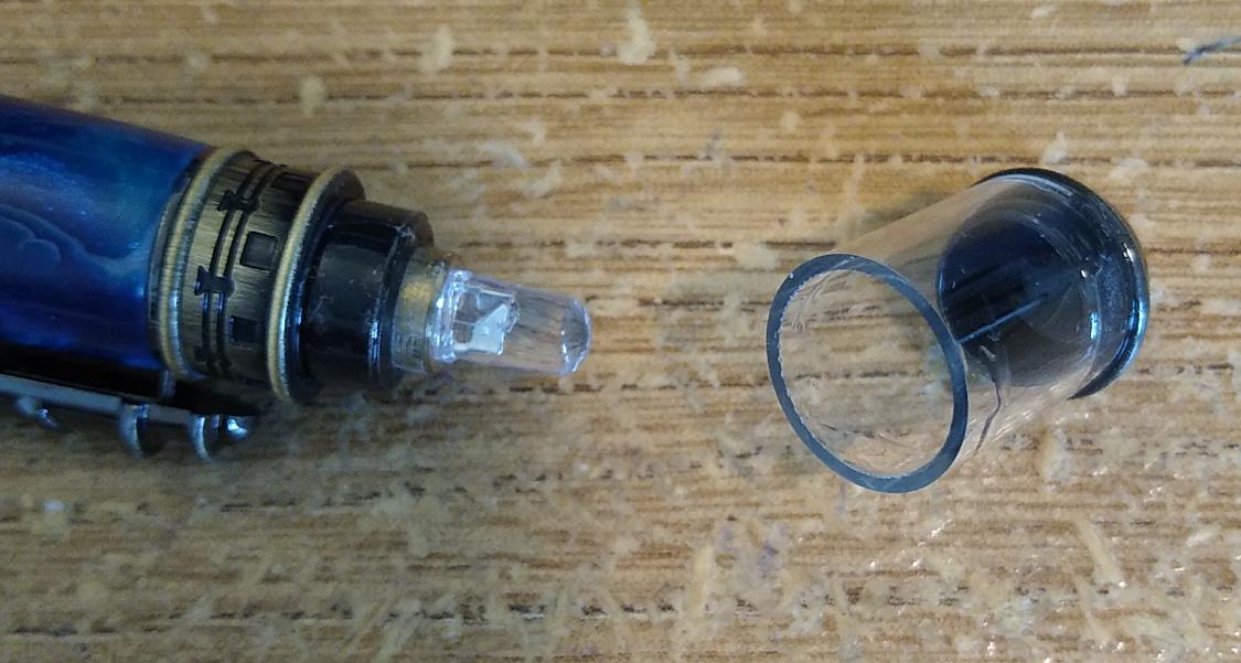

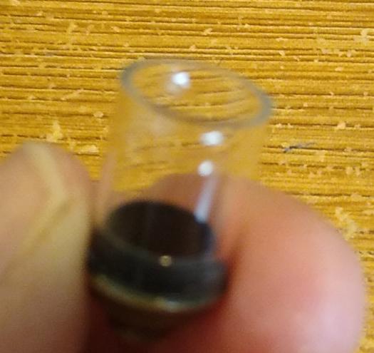

Was photographing some pens this morning. A Lighthouse pen I was shooting, fell off the stand it was on and the "light dome" came off. Not the first time this happened but when I tried fixing that one, I used CA glue, and it "clouded" up the plastic dome. I don't want to repeat the same mistake.
What can I use, or what did "they" use, to glue this on, and can I do better?

I tried clear epoxy and was able to get it back on, but it smeared the black paint that's around the base. Was able to get a replacement from PSI. All good. Thanks!
I just had one of those that I made for a coworker that had the same failure. To fix it, I brought in a bottle of medium ca, (but I'd assume any weight would work), removed the cap completely from the ca, dipped a q-tip into the ca, wiped excess off so I didn't get drips, and smeared around the black base. A little twist like with a brass tube in a blank, and it set up securely.
