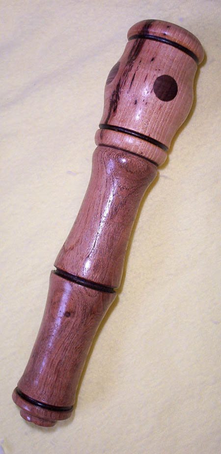

I make calls, originally most of my supplies came from HUT. They are good folks to do business with. If you have questions call and ask for Larry. He won't oversell you but will give good advice. With a goose call (flute), unlike duck calls, the stopper is very long compared to the barrel. I have best results using Forstner bits for the end grain boring. My first goose flute is pictured below. It was a special order and contains a reed from HUT. Customer was very pleased. Not shown well in the picture is a tenon on the stopper end for adding a flexible expansion tube. I don't like or use them but some folks insist on having so I make is optional with the end user.
<br />

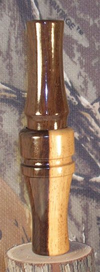

Most of the goose or duck calls I use my pen mandrel.
Turn the barrel and the exhaust one at a time.
If you need any help send an e-mail.
Black Chacate from craft supply CA finish
<br />
