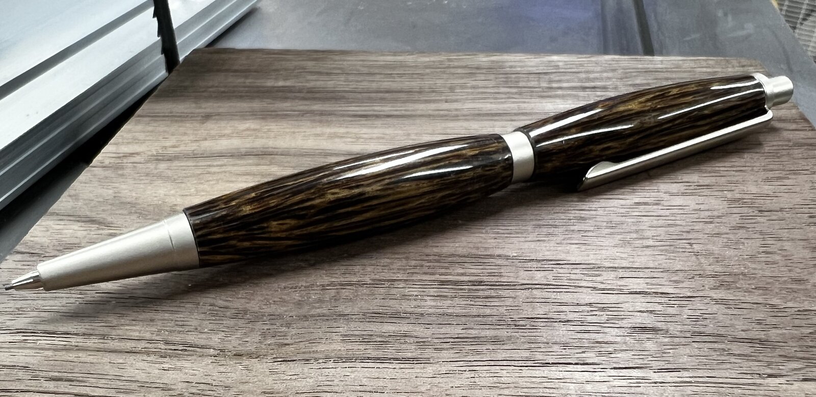

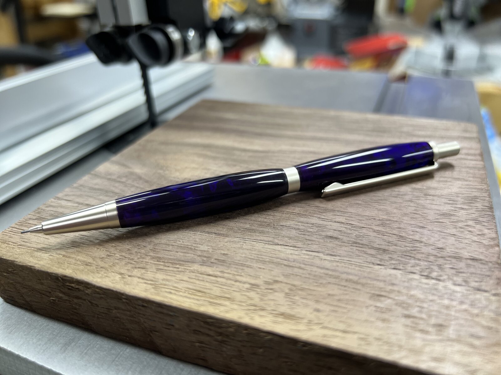

I am sorry I haven't been online for a bit, I was busy in the shop making a couple of Slimline Pencils! Thank you for the kind words regarding my pens so far. I am learning valuable lessons with each pen I make. My lesson this session was, don't sand your blank with water and then apply CA or the CA will cloud in places. The first pencil which has small CA clouds, is a black palm blank, I was too far off my bushings but love the look of the palm and it was interesting to turn. The second was just a purple acrylic, but this was my best fit and finish so far, the transitions are all smooth and I added Novus2 as the final step after micro sanding and it really made it pop.

Black palm is beautiful and a real bear to work. Congratulations! Novus 2 as the final step on both acrylics and CA is the way to go!
I also love turning Black Palm, I always soak it with Thin CA to stabilize and then stop short of final dimensions and sand to final fit so I don't get one of the dark fibers catching out just as I sneak up on the right diameter.
