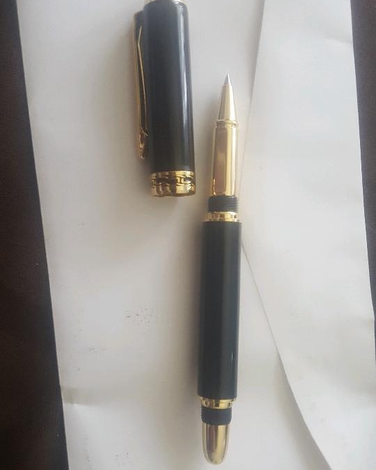

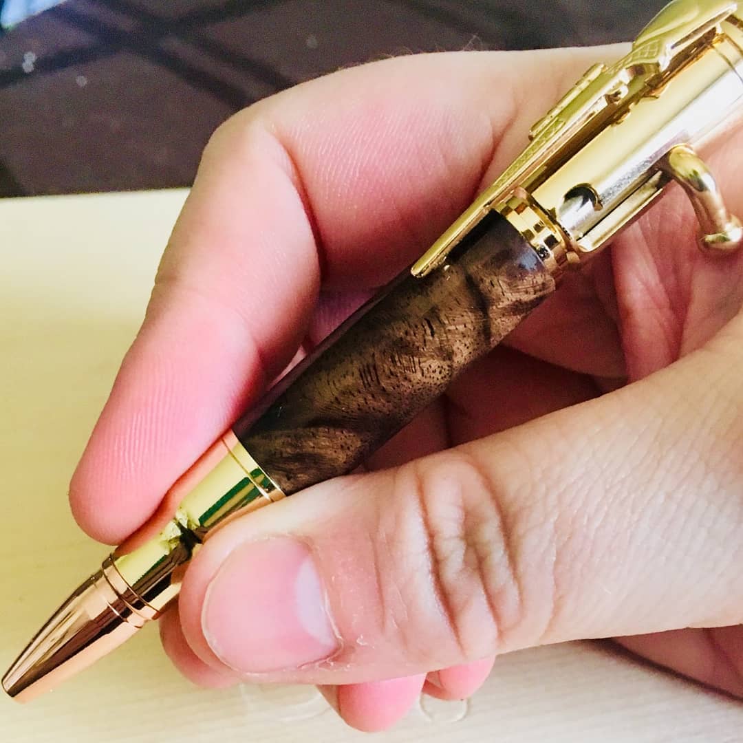

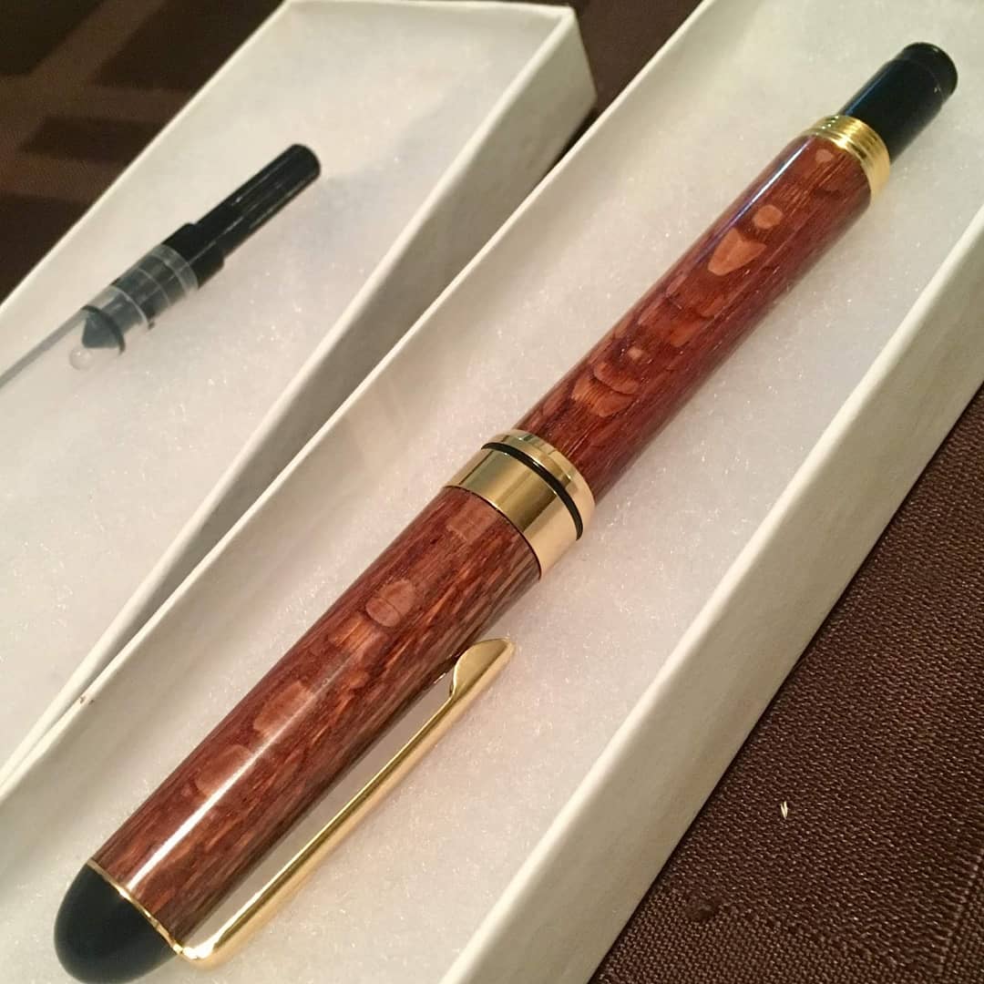

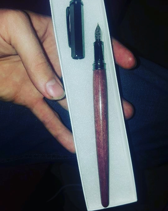

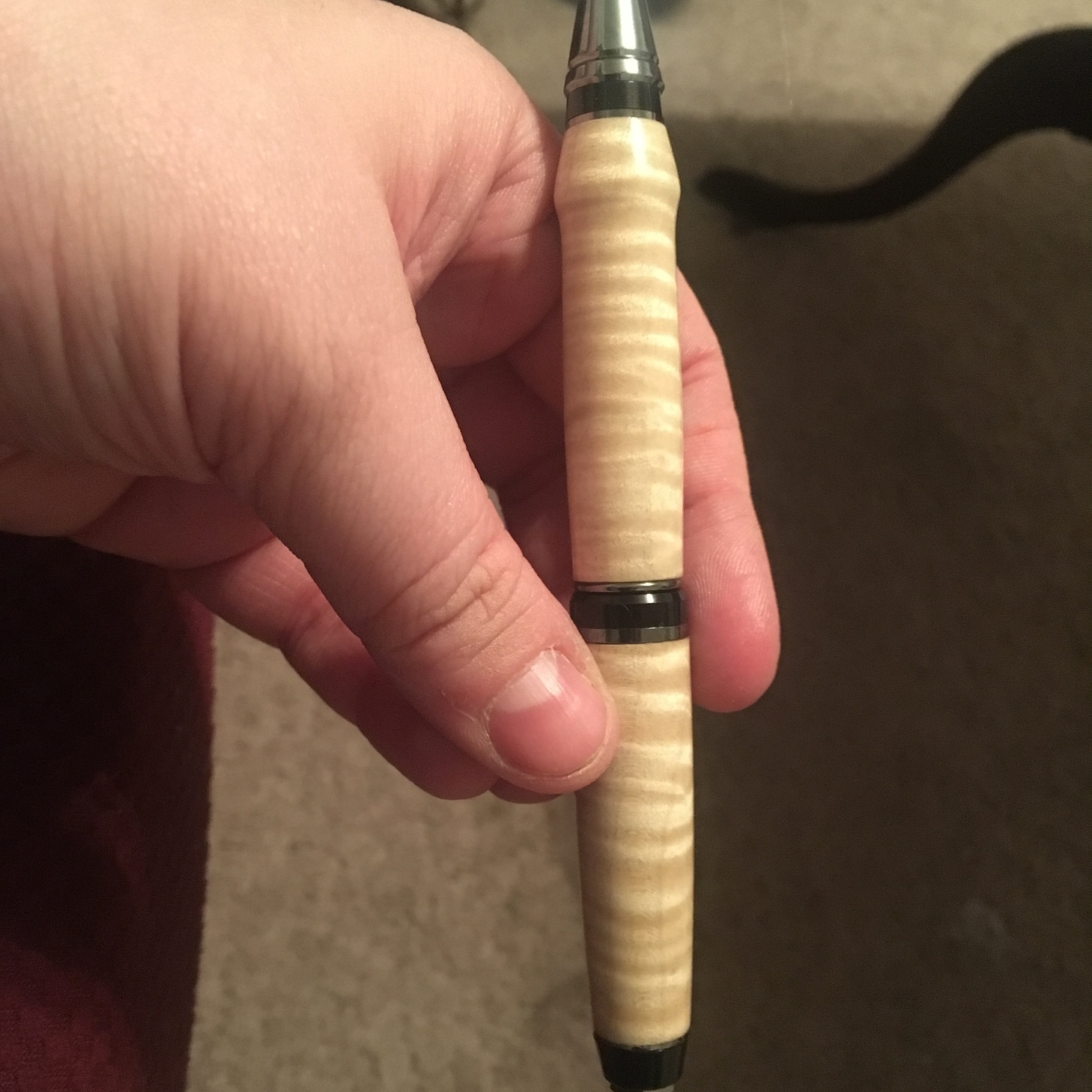

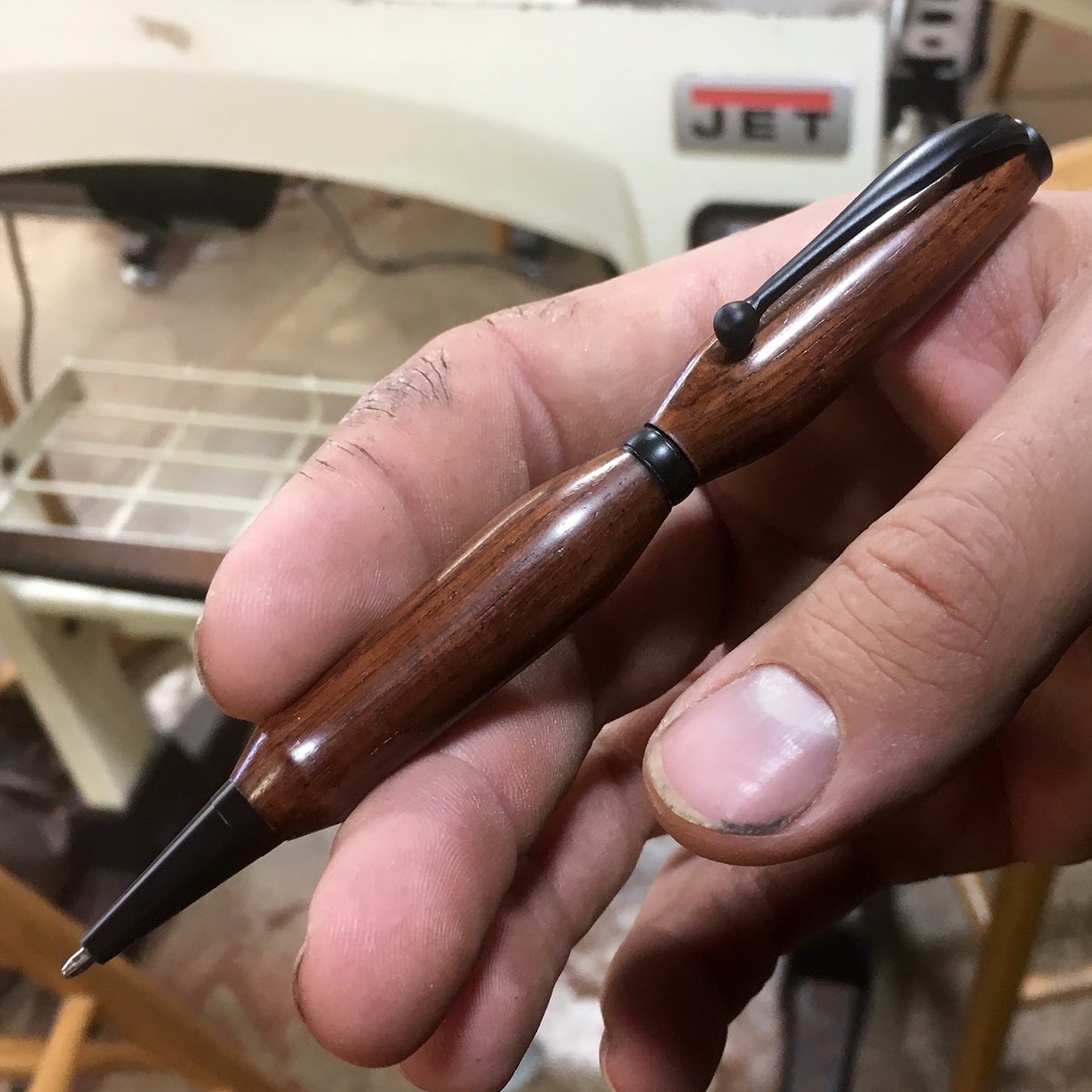

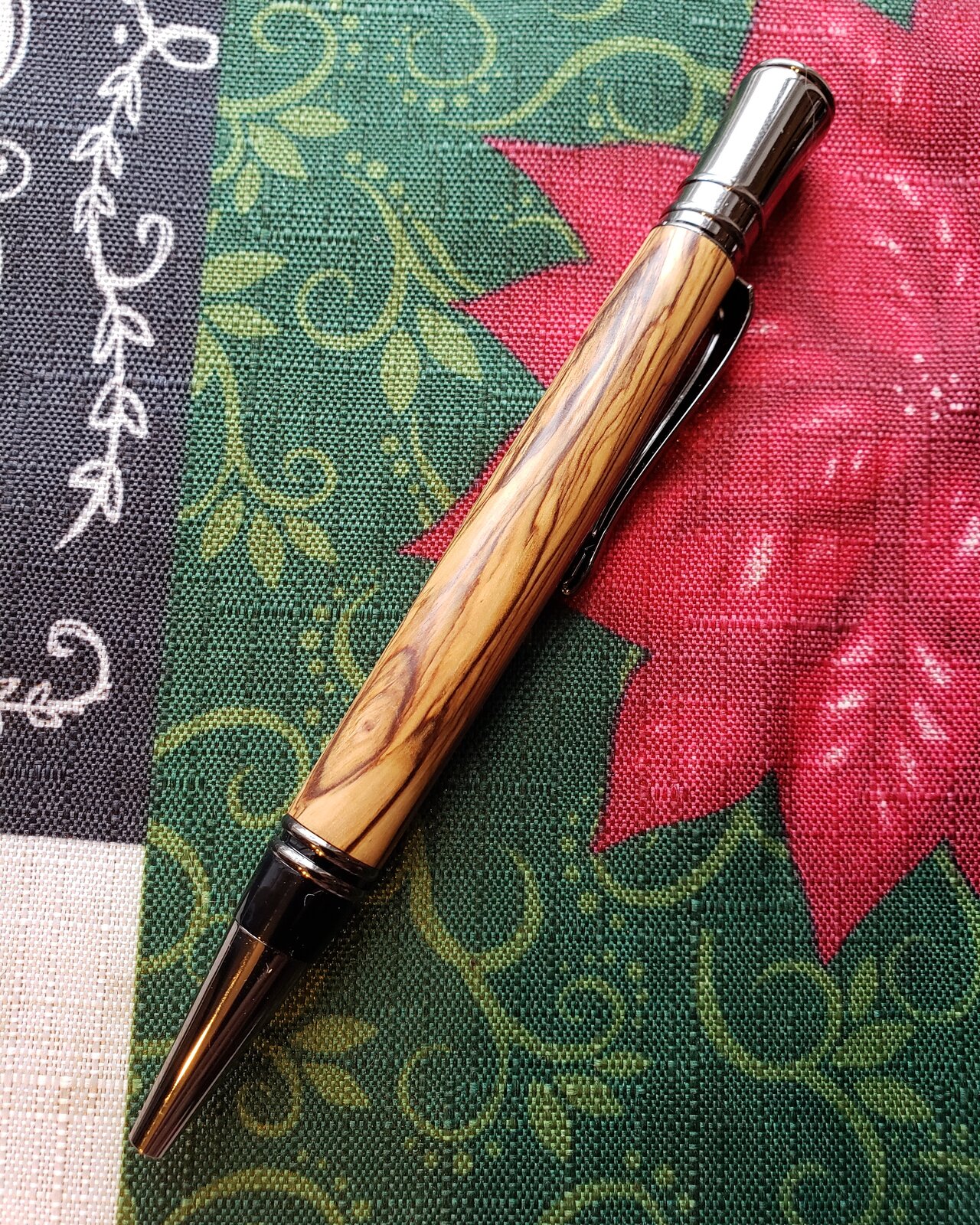

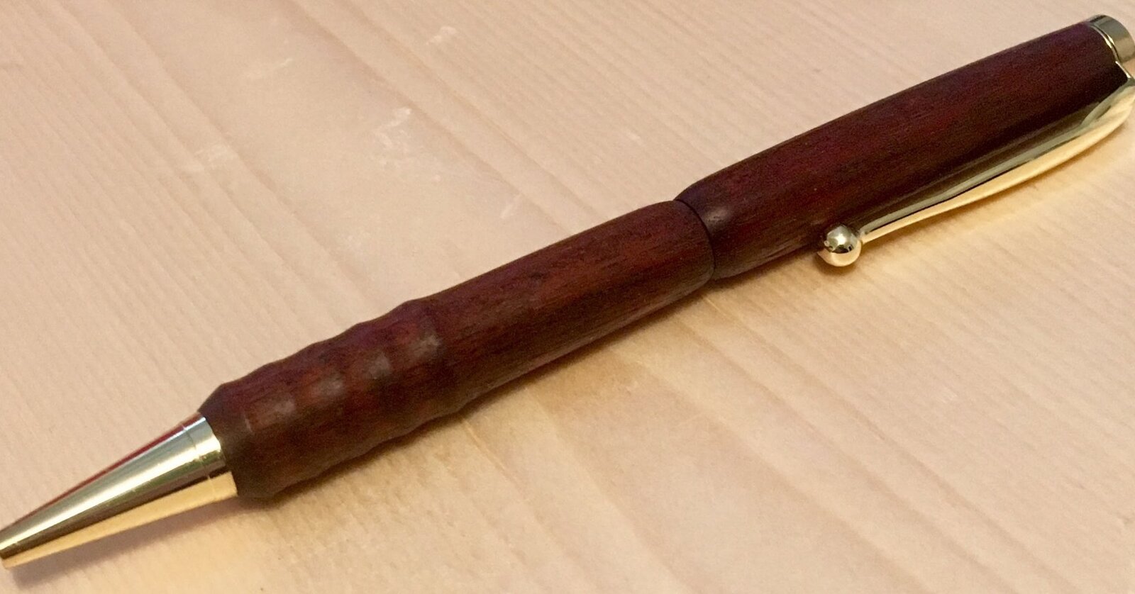

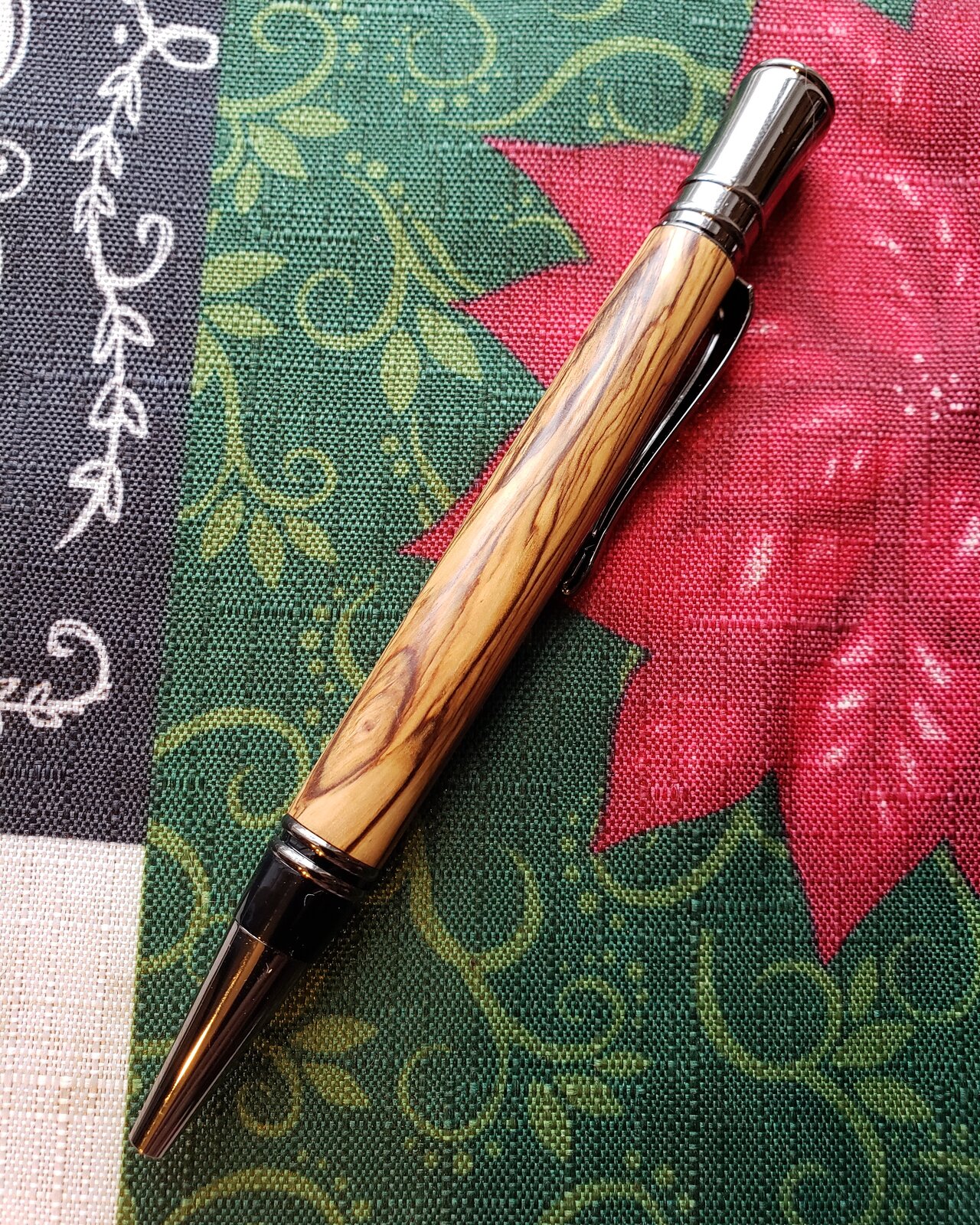

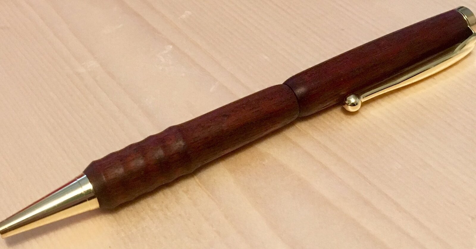

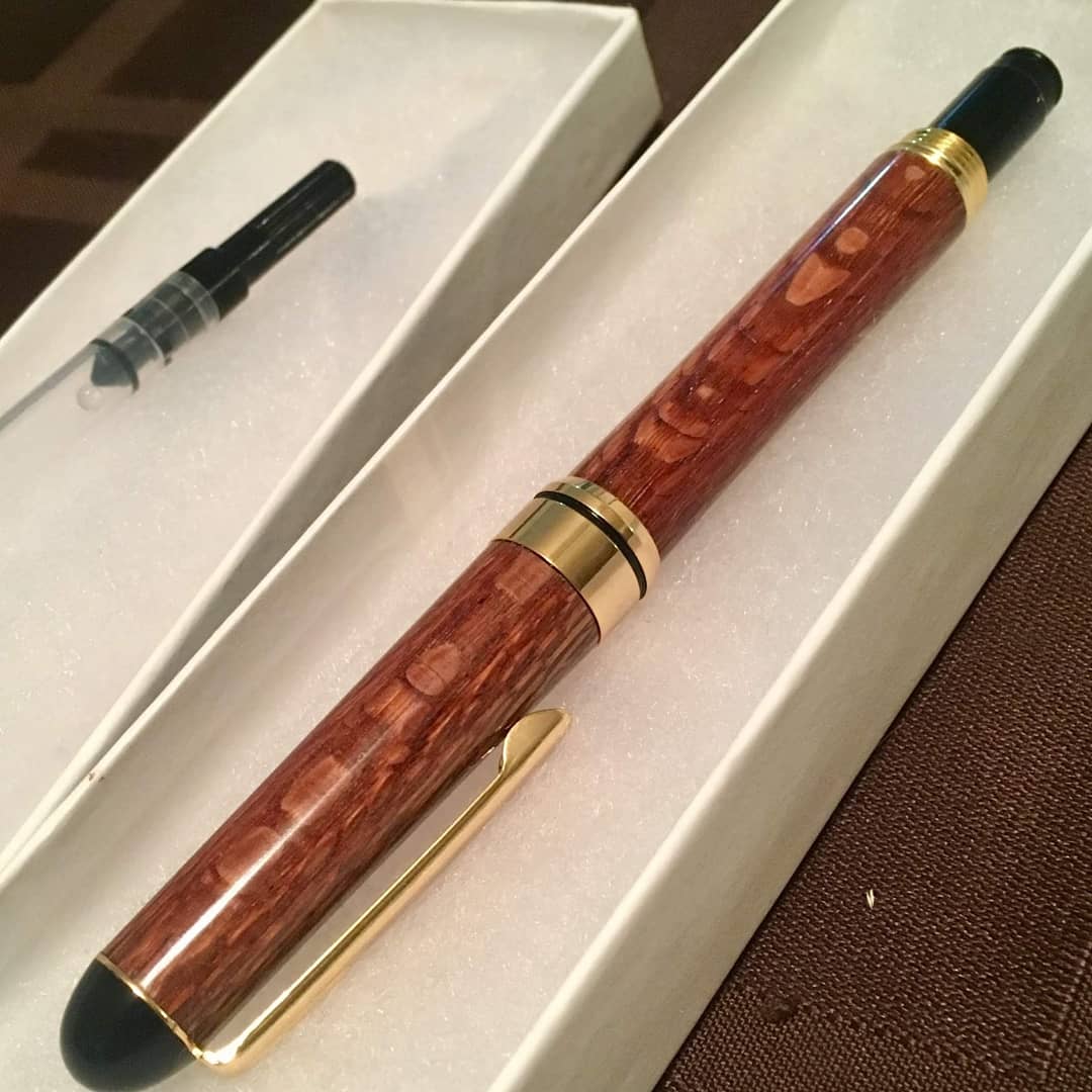

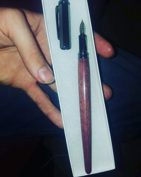

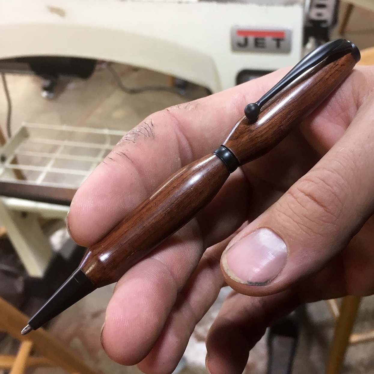

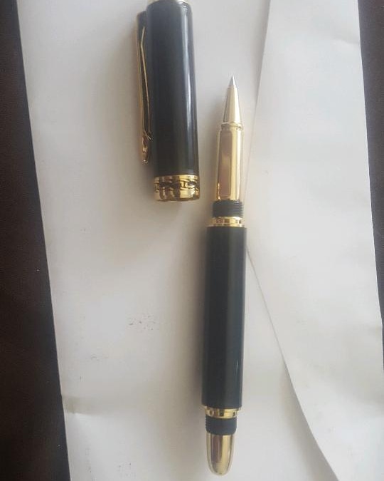

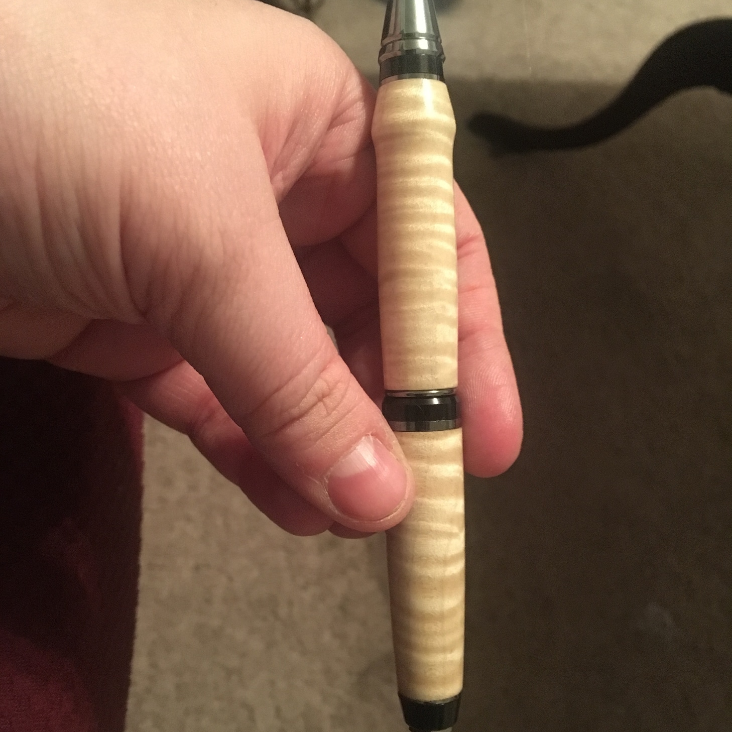

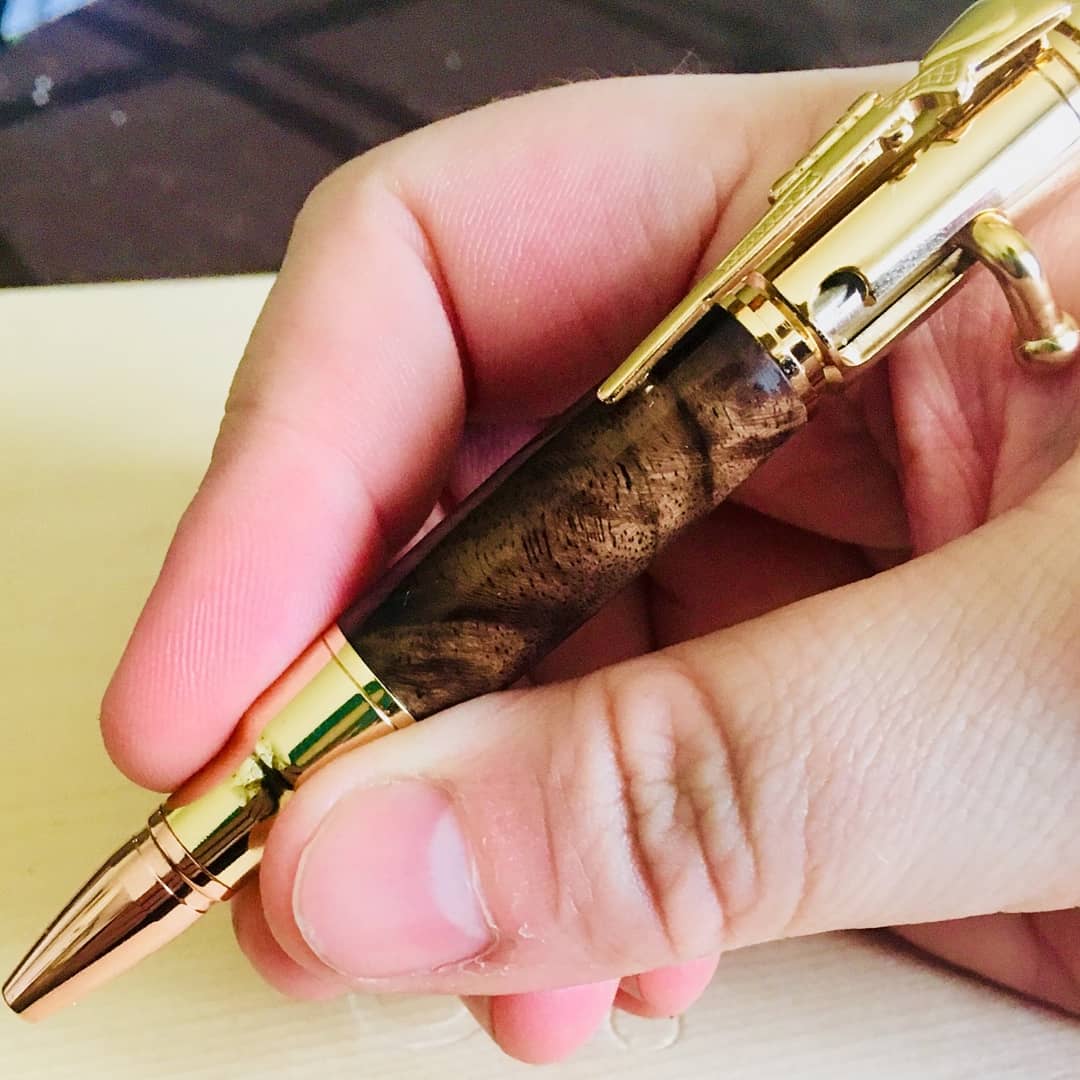

New member here from east-central New Hampshire. I have been turning pens for about 3 years now, but I look forward to learning tips and tricks from those with more experience than I. So far I have only turned wood, but I am interested in expanding out to include acrylic and possibly eventually try kitless all-metal.
The rosewood with black hardware was my first ever turning from a pen class at Rockler. The poorly finished Ipe slimline was my first pen on my own. The others are an assortment I have made since for various people, some finished with cyanoacrylate glue and some with friction polish.

I assume you mean the purpleheart fountain pen? I started out with a vertex magnetic fountain kit and measured the inside dimensions of the completed assembly. I then drilled out the wood to match what the kit would have been. After gluing in the brass tube, I set the bushing in that end and kept the other end in the chuck (no pen mandrel possible). I used a live center to hold the bushing against the blank and turned and finished like normal except for where I needed to part it off. I finished the last quarter inch or so at the pointed end by hand after parting.
