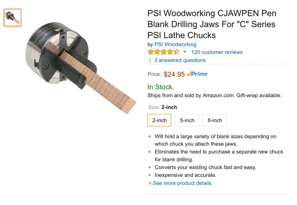

Sue, her is a pic of the pen turning jaws you listed in the earlier post. The jaws are the two black parts you see holding the wood blank.
You need the chuck...scroll chuck you see that the jaws are attached to. The Chuck screws onto the lathe headstock spindle thread. When the lathe is running, the spindle(shaft ) turns. The Chuck mounted on the spindle is spinning your wood.

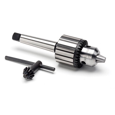

Here is a pic of the Jacobs chuck(drill Chuck) which will mount in the tailstock and hold your drill bit while the wood blank spins. You will crank the bandshell to advance the drill into the wood. Just hold the drill Chuck by hand as when you crank it back out to clear chips, you don't want the drill Chuck to loosen in the tailstock.
The tapered end you see fits in the tail stock and needs to be the matching size morse taper.

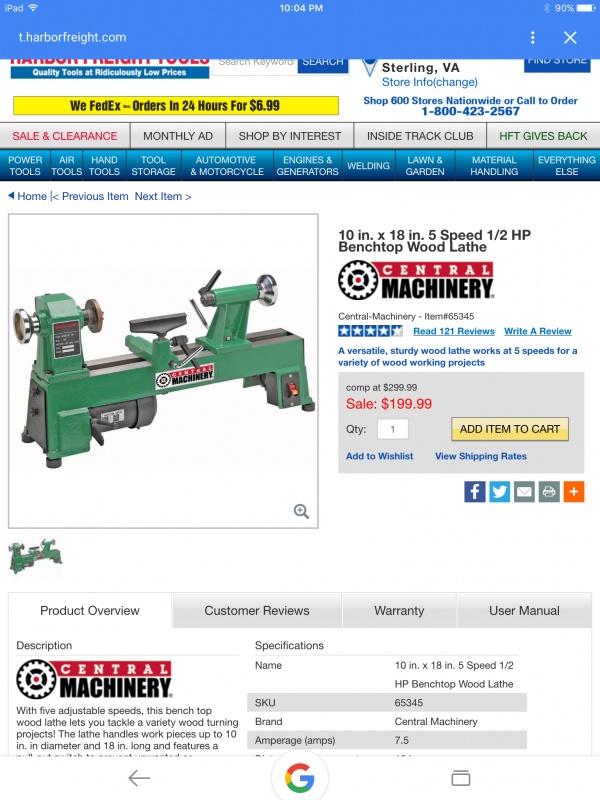

Ahhh..got it...I am SO visual, but it works like the chuck on my drill...gotcha.... this is my lathe. Not high end by any means...but meant to be a starter...as it is the only wood craft project I have ever done. My grandfather was a decoy maker though and I spent a lot of time with him in his wood shop, I just didn't know what things were called.
sue, I see the lathe you listed. I feel if your budget allows, going to their next size up...the lathe will not only be able to handle larger work but the size of the threading and morse tapers where you will attach your drill Chuck, pen mandrel will be more of a standard size(#2 morse taper). You will have a better time fining accessories as your turning advances.
The next one does not have the variable speed. You have to change the belt to change speeds but should be a better choice over the other one.
Here is a pic of the Harbor Freight one.
My next recommendation would be a Rikon mini lathe from Woodcraft.

Sue, if you can possibly return the lathe you have to H.F. and buy the next size up (picture posted by Charlie) it would only cost you $75 extra and would be well worth it in the long run and would save you buying the drill press.
What will it gain you ? -
- longer length to accommodate your headstock chuck, jaws, pen blank, drill bit and Jacobs chuck (in the tailstock)
- more common MT2 (instead of MT1) fittings in both headstock and tailstock resulting in easier-to-get accessories
- MT2 gives you better accuracy and ease of use (as well as easier-to-get accessories)
If you are at all serious about this hobby you will come to appreciate MT2 and the extra lathe length.
