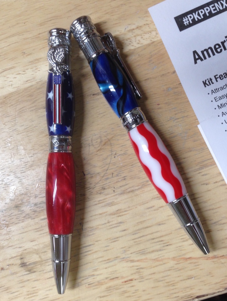

The American Patriots are heavy and quite cool.

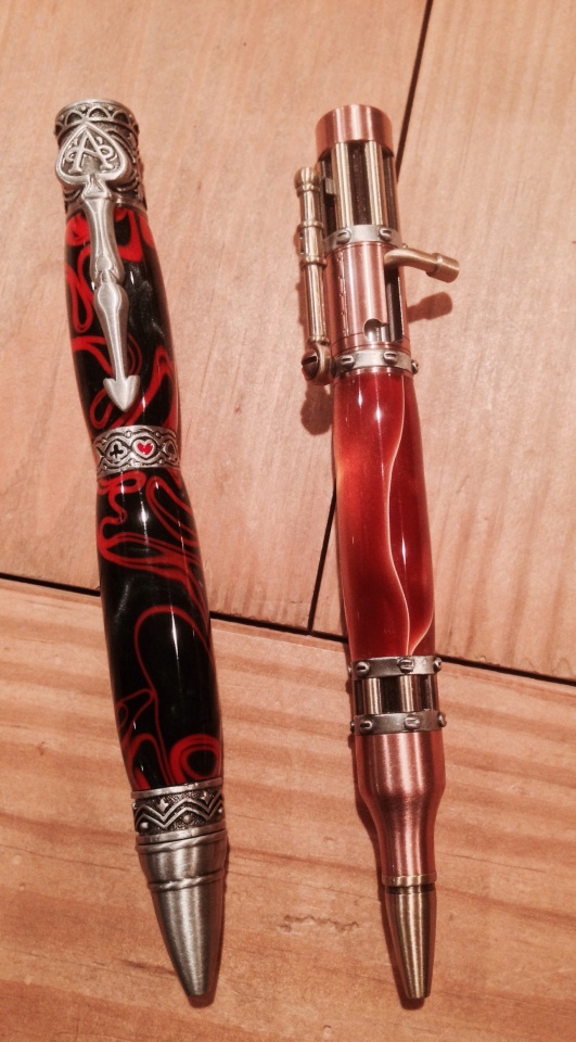

The Steampunk..... if it fits his taste it is a unique pen to own.
all are from PSI
I agree with the suggestions for Churchill (Berea) & American Patriot (PSI). I'm a big man and I carry these. I also like the Steampunk pens from PSI. I carry one with a circuit board blank on it. Always attracts a comment. I also like my Vertex Supreme (PSI). It has a magnetic cap that posts on either end, available in rollerball or fountain pen. I like it in gun metal finish. Nice and heavy, but well balanced. Watch the magnet in your pocket with your cell phone or credit cards.
