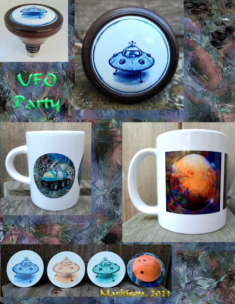

We knew they were out there, and I was grateful for a generous albeit brief visit.
They left me a nice heat sublimated UFO image-inlaid exotic wood bottle stopper at our UFO party - also left me some souvenir mugs after we savored some exotic espresso.
I was curious about the bowling ball token. They said that intergalactic league play is going well - but best to wear a helmet to minimize risk of injury related to gravitational variation.
They came in peace.
Happy Sunday to all - Bob

Here's how I did it:
Discs
I loaded an Epson 3760 Ecotank printer with Cosmos brand sublimation inks instead of inkjet ink
I created the artwork by hand in various real media, then digitally refined it in PhotoShop.
I then resized the images and printed them onto Crafting Besties brand dye sublimation papers.
I used aluminum dye sublimation blanks (from Etsy) for the discs.
I taped the images face down onto the discs with heat proof tape.
Then used a Cricut Minipress to transfer the images, 380 degrees, 30 seconds, with light down-pressure; quickly peeled off the taped image, and revealed the permanent light fast image.
I domed the printed metal discs on a hardwood dapping block, then inlaid them into the lathe-turned/tung-oil finished hardwood.
Niles S-9000 stopper threaded into a Niles brass insert in the turned wood.

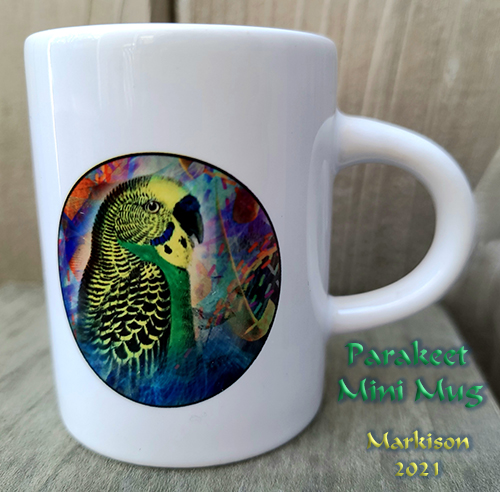

Mugs
I used a Heat Press Nation brand (6-in-1) mug press for the cups - 360-380 degrees x 3 minutes.
I'm planning some little experiments that will likely find their way into pens (and other things).
