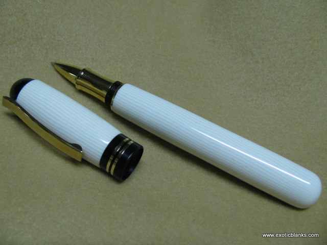

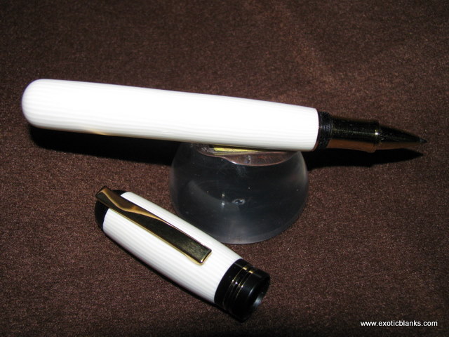

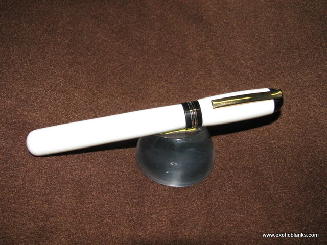

But, I got an order for a pen, from the exotics site. Gentleman saw casein and decided he needed a pen with a certain rollerball refill that he liked. Asked if I could make it. His refill and his taste dictated the length. The components come from more than one type "kit"
Well, so here it is:
Of course, comments are welcome! Especially good ones.:rolleyes::rolleyes::rolleyes:

BAD BAD BAD beautiful work but the components for it were individually selected with great care not from a KIT!!!!!!!!!
Great looking custom pen

I was intrigued the first time I saw a casein pen and it is quickly becoming one of my favorite materials. Hope exotics can keep this in stock. A beauty.

I think it would look more interesting with a piece of black acrylic added to the closed end. But, I was just the mechanic here, the customer KNEW what he wanted.
I'm not complaining, it IS a pretty pen. Will be interesting to see how durable it is.

Mr Beall can take credit for the finish. I did work on it a while, the scratches did not want to come out (1000 grit). But, I really wanted a top-shelf result---personal pride thing---- and the gentleman looks like he could refer some business to me. So, I kept buffing until I could not see scratches any more!!
Casein CAN shine!!

I'm not kidding when I say it took a while. Three separate sessions, maybe two minutes each. But, had I stayed there for longer, I would have put too much pressure on it and it would have gotten hot, then, who knows???
I did NOT want to blow this one! (Sold all my casein, one try and you're OUT!!)

PROBABLY!!
I like the blue one.
:biggrin:
:biggrin::biggrin:

Were you trying to get the blue out? Is it taken under fluorescent lights?
