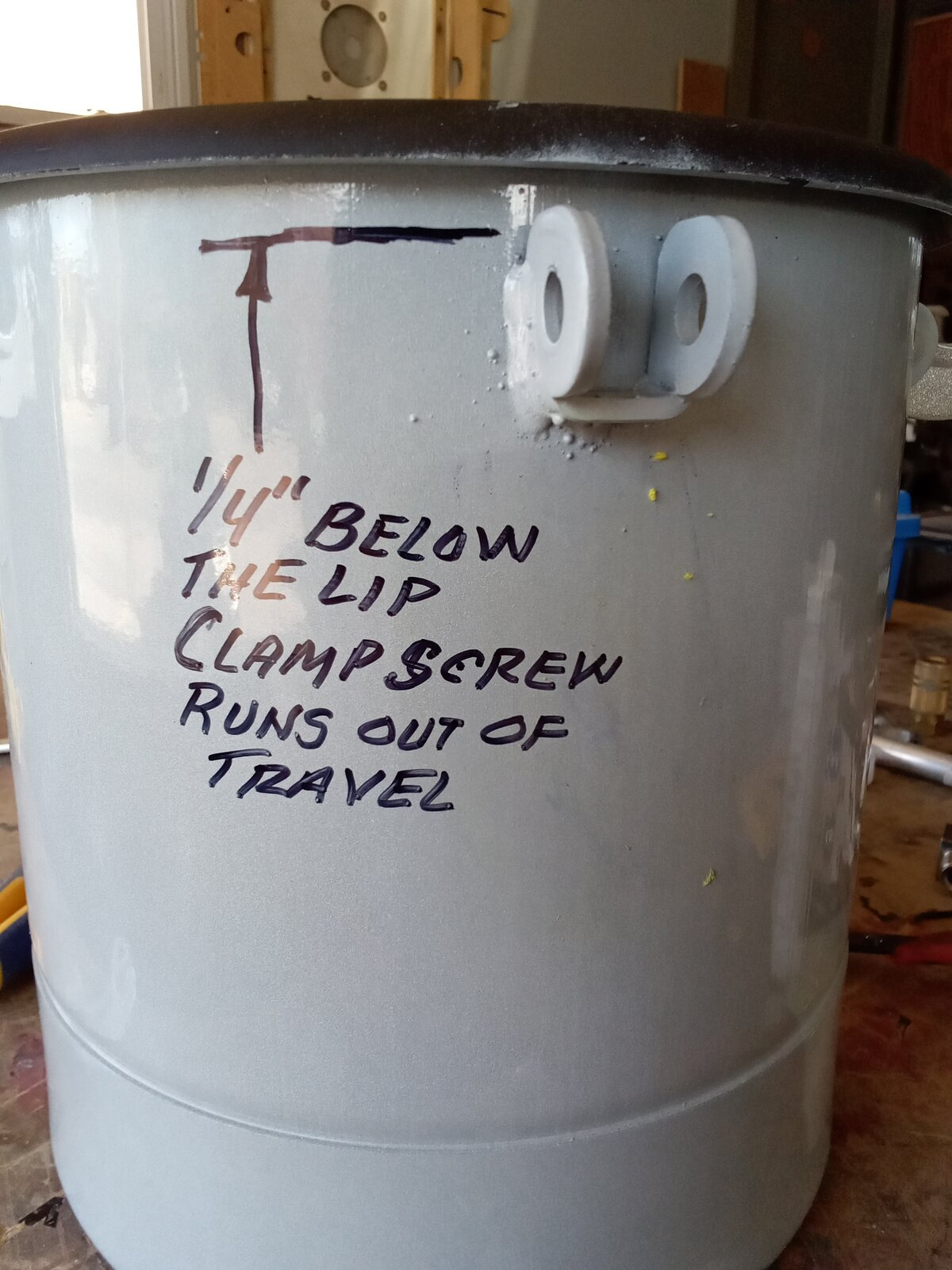

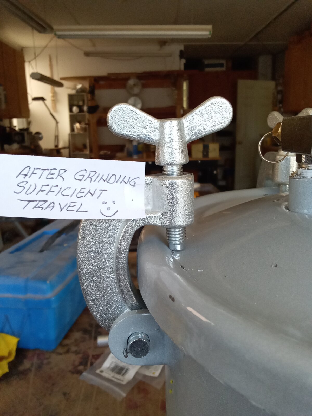

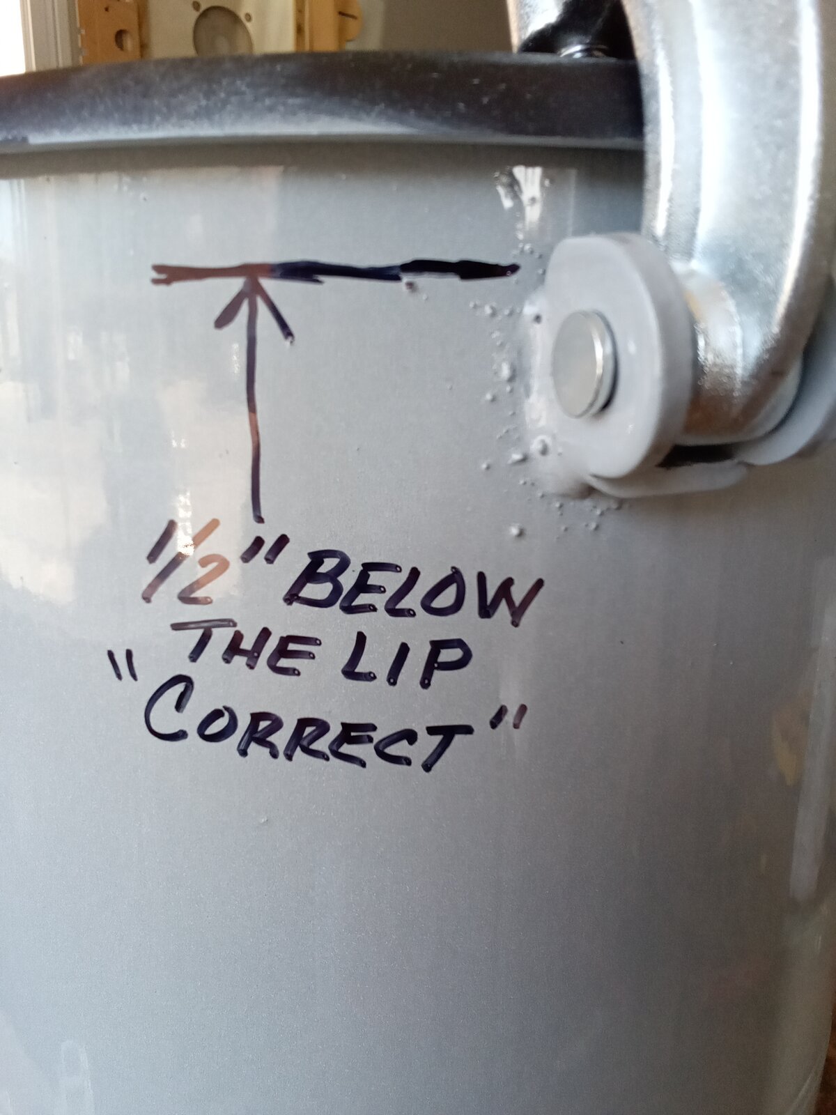

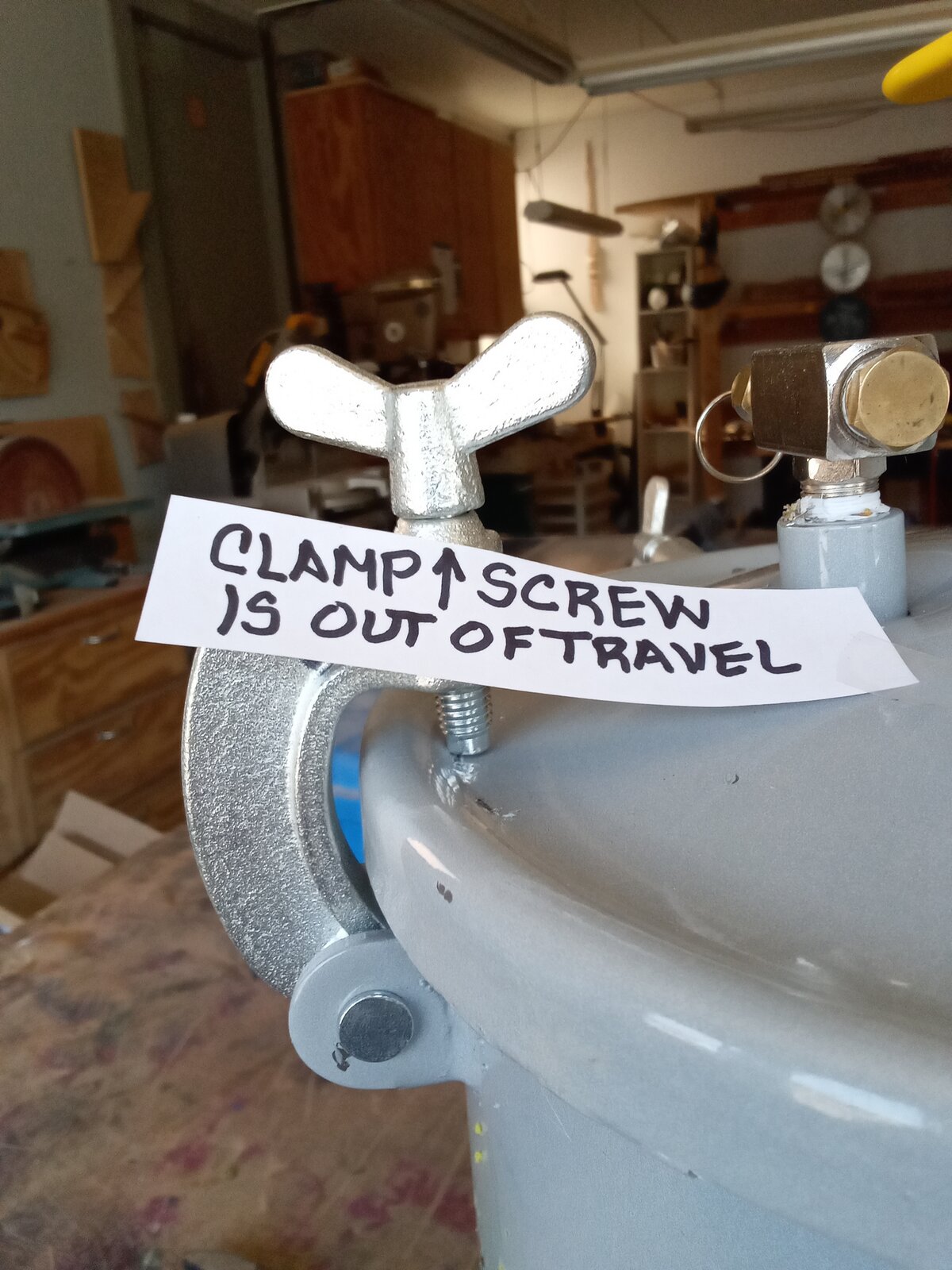

See the pics here . One set of the tabs that the clamp is attached to was welded to the tank body 1/4 inch higher than the other 3 clamp assemblies. It is off enough that the screw runs out of travel before sufficient force can be applied by that clamp.

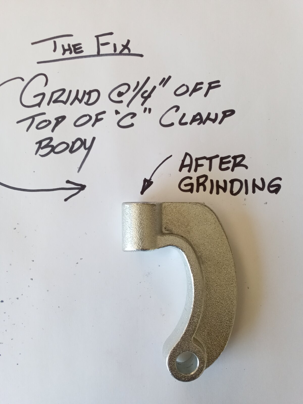

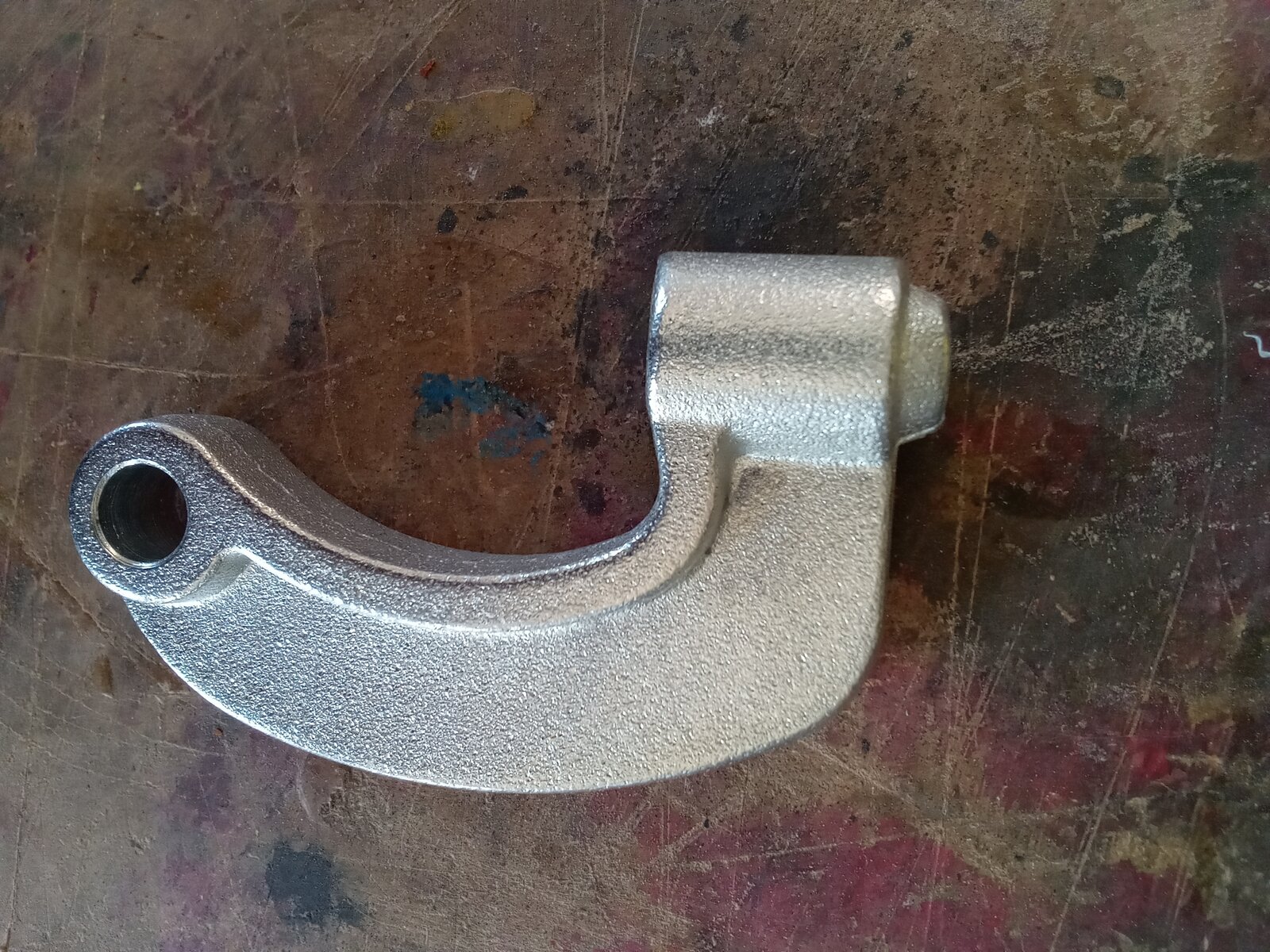

Ok no biggie the fix is simple a little grinding.....the pictures below will tell the story.
