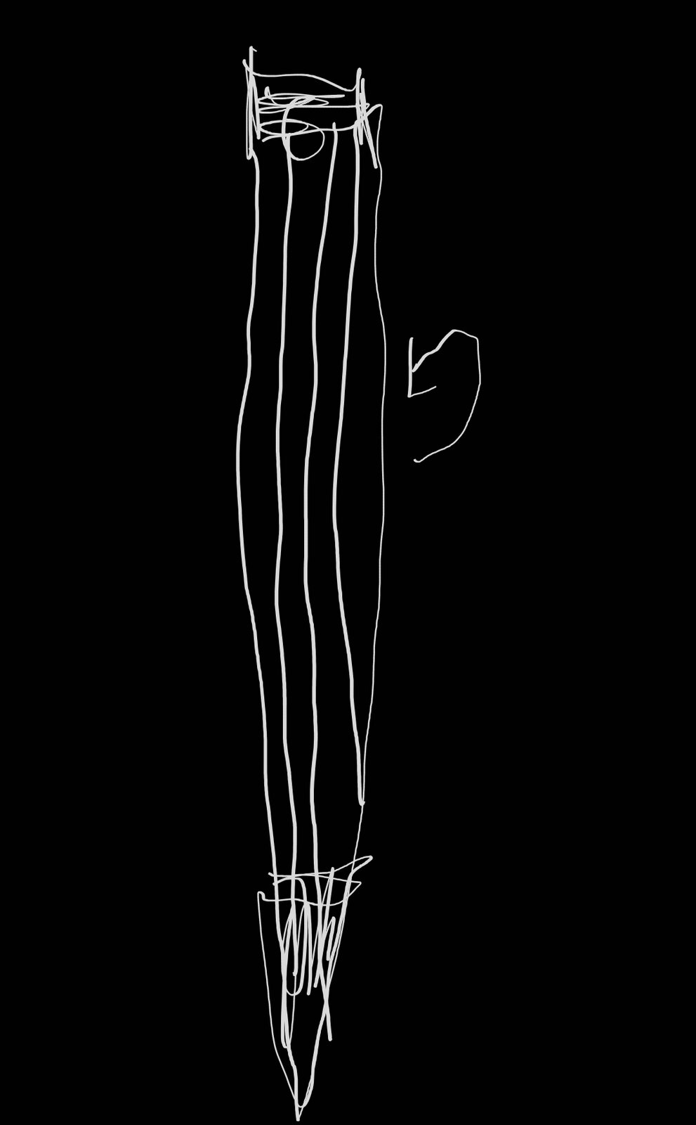

Hello friends, I've been commissioned to create a pen with seven guitar string inlays. I've turned and prepared the wood and cut my grooves. The trouble I'm running into is that the guitar strings, which are about an inch and a quarter long, are incredibly difficult to glue in and settle in my grooves, since the guitar string is stiff, unlike a bendable wire. Before cutting the strings to length, I wraped them around a cylinder for a few days to give it some bend but it's still pretty doggone tough to hold these boys down. Any advice on how to get this done? Thanks so much
Ok, new question. How can I cut straight inlays along the length of the pen blank? I do not have a router.
I did not use a router, I used a saw with a very fine blade, 1mm carbide kerf. You can find 1mm blades with a search, but they will be 4" to 5" in diameter.
Making consistent groves is something that takes practice. Make a jig that holds the blank perfectly still, use a jig to guide either the blank or guide the saw over/beside the blank at prescribed marks. Precision is the key and that is why I wrote practice - which will tell you what adjustments you need for consistency.
