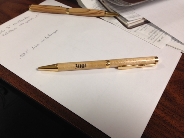

Just took a picture of one I had on my desk.
