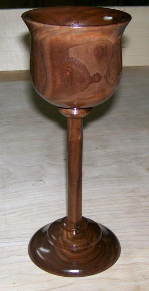

once again thanks for the replies, and i did read the artical Justin and that cleared up alot of things for me. Thanks to all of you that replied and if anyone has anything to add please do so. Thought i'd upload a picture of the first one, any comments are welcome.
Thanks,
Jim
