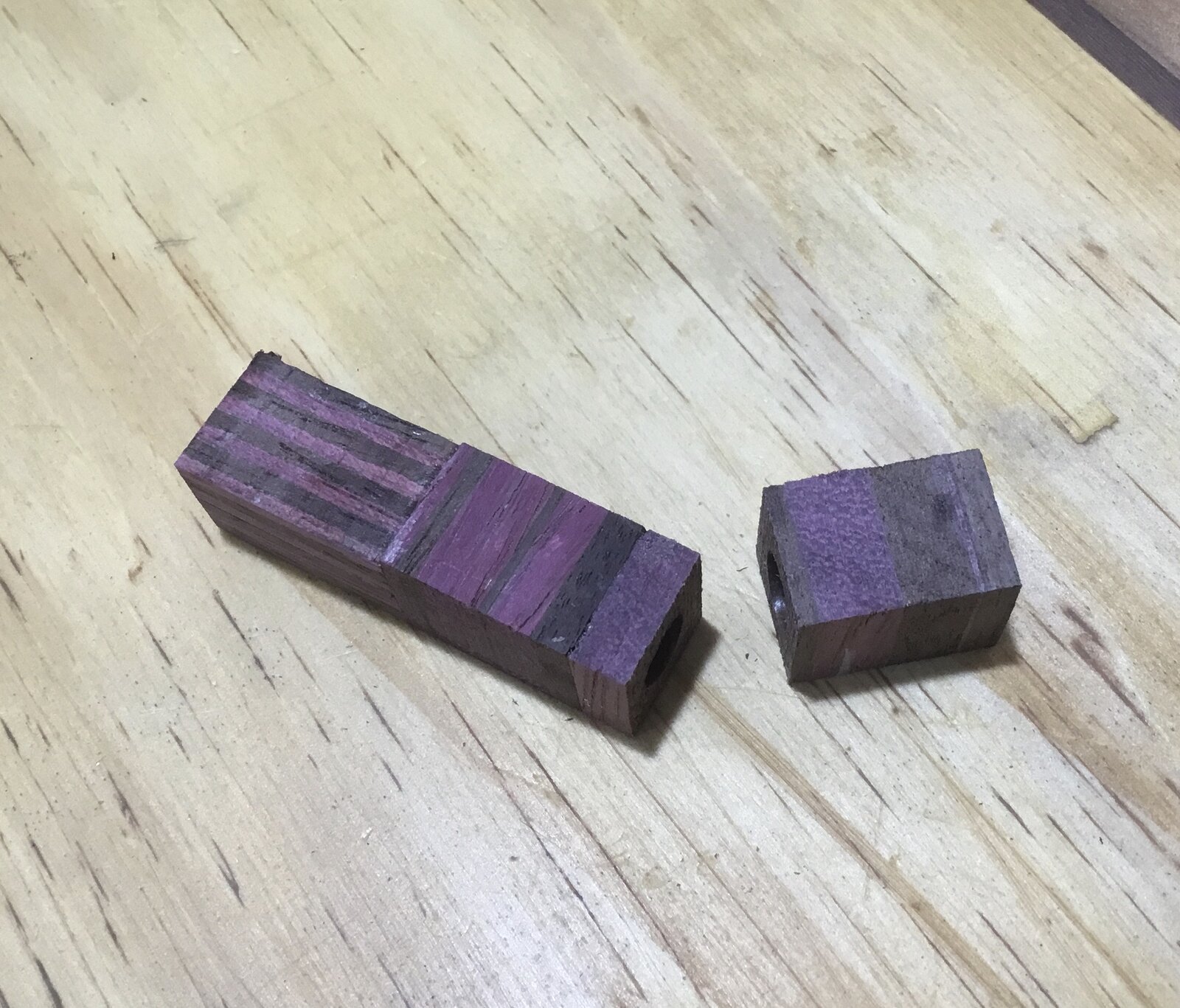

Hello everyone, I'm just starting to make some pen blanks from different kinds of wood. I always use titebond 2 to glue them together, but today i was drilling a hole in one and there was a section that fell apart.
Regularly I will glue it again, clamp it and wait till tomorrow but I thought "what if i use medium Ca glue for bonding it again?"do I also have to wait till tomorrow? Or is it better to glue it with TB?
Thank you in advance.

Here is the problem. You have now sealed the grain of the wood with the TB. Even if you glued again with TB it will not have any chance to attach to the grain of the wood unless you freshen those ends up again by either a good sanding or recutting. Now CA glue is good for adhering solid surfaces but can also use some help with some tooth to both pieces by sanding. The same goes for epoxies. Med Ca takes alot longer to dry than thin but can be accelerated by using accelerator spray. Anyway you look at it it is still a crap shoot if it holds together no matter how you glue it. Just the nature of segmenting. Good luck.
Thanks so much, it helps a lot. I'm going to sand or give it a touch in my shooting board and glue it with TB again and wait until tomorrow. If i want to do things faster so I'll have to go slow and with patience. Until now TB has worked well for me.

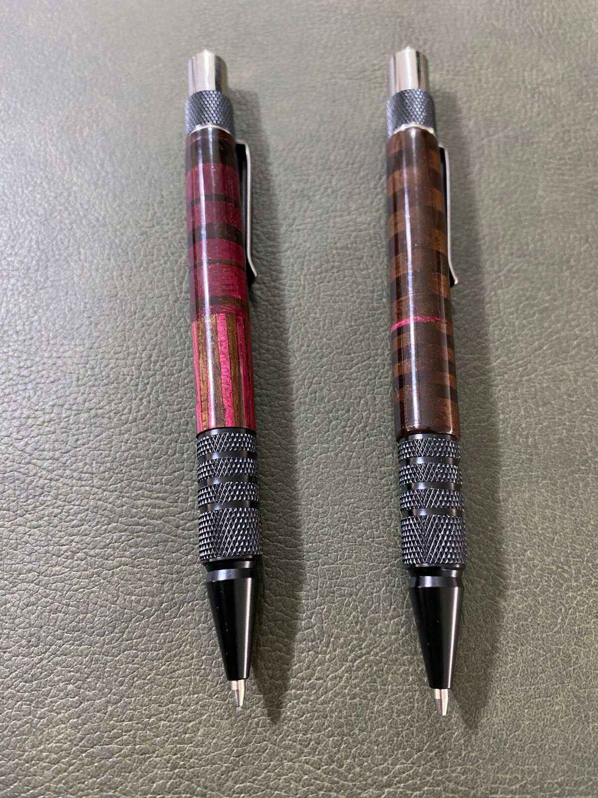

Thanks to everyone, I have some pictures of a collection that I'm working on.
It's long way to learn finishing, wood behave, etc.
greetings

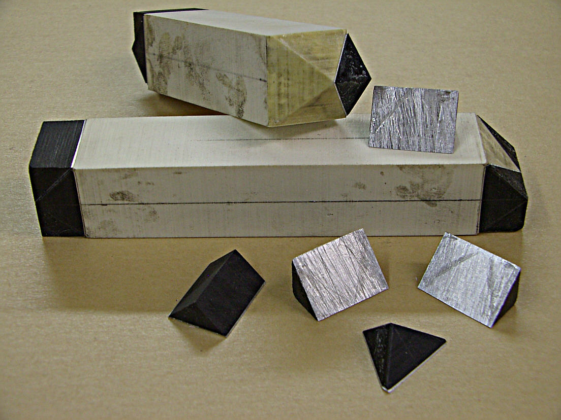

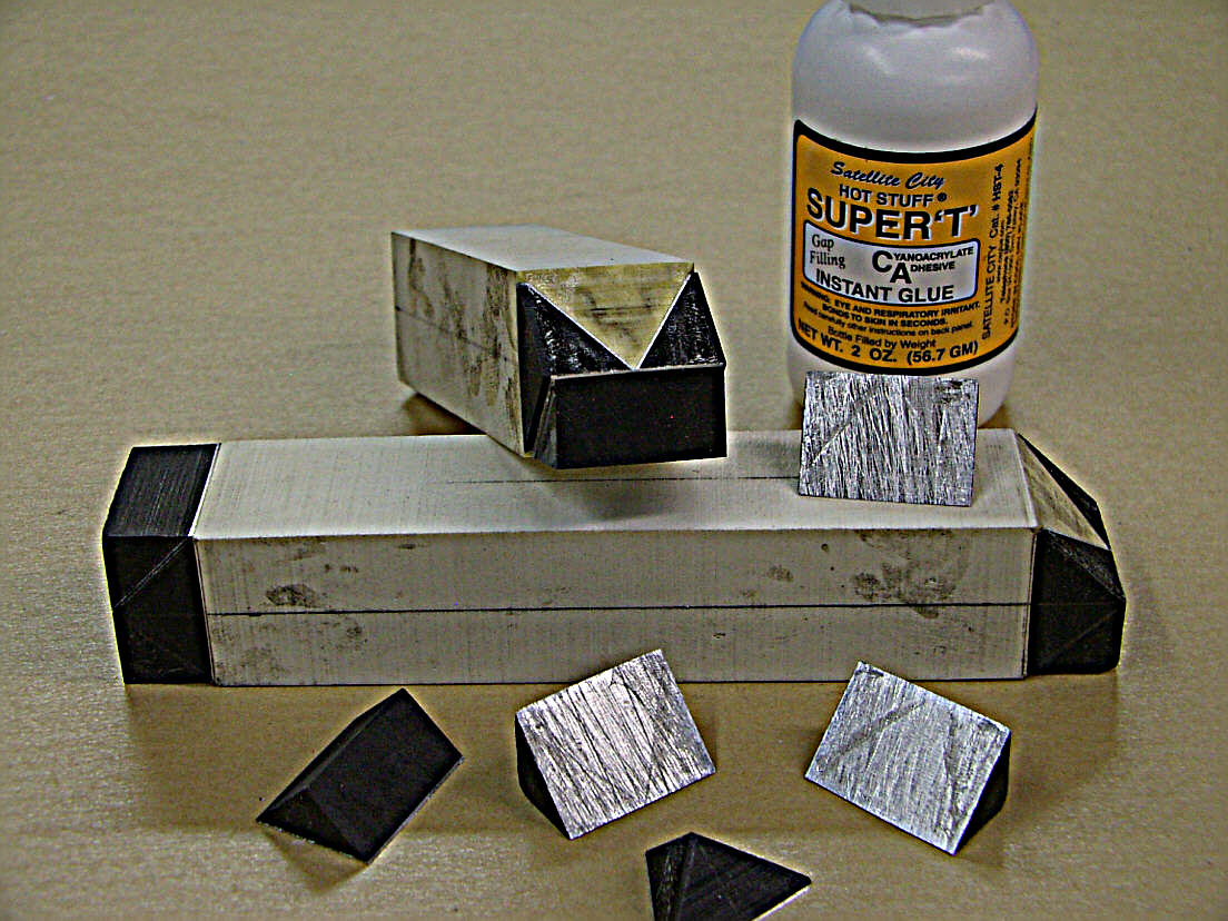

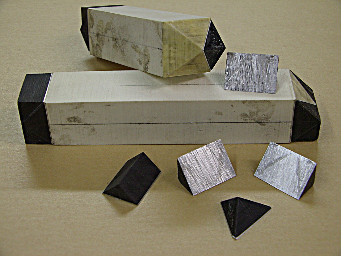

I use medium ca with accelerator exclusively regardless of material when building segmented blanks. I also finish all of my segmented pens with ca. other adhesives work fine as stated in the above comments however I generally don't want to wait overnight for something to set up or dry. With ca you can go from gluing to turning in a matter of minutes without much issue.
It works for you but not everybody. Everyone needs to try for themselves.
Thank you,I also want to try accelerator looks like it's magic but I don't have it and I'm afraid to import it because it is spray and don't know if it's allowed, maybe I should try with a small sample and try, I think I'll better ask my courier and ask them if they know if it's allowed .
greetings
I don't mean to imply that it was the only way, but I would also say it can work for everyone of done correctly. Just like wood glue or epoxy can work for everyone if done appropriately. I was sharing my approach and reasons why I use CA over other methods.

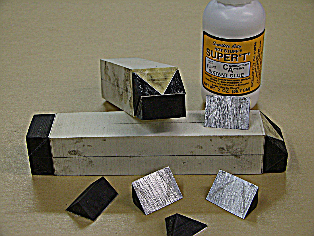

I did not imply anything either. My thought on the process is first CA is brittle no matter how you do it. It can have a tendency to snap when drilling. Been there. Had pieces fall apart before I got to turning. (example shown) I too CA all my wood blanks but acrylics no. I found gluing acrylics and metals works better FOR ME if I use epoxy. If it works for you by all means keep doing it and have fun. Hope to see some of your segmented work. I love segmenting.
View attachment 361408View attachment 361409
is it wood and acrylic ? Nice combination, looks elegant, its going to be a very nice pen.
It was holly and Gabon ebony with aluminum strips. That blank has made it to the I will get to it at another time pile. The actual pen design for that blank was going to a very busy one. It still on the drawing board though so maybe someday you will see a finished pen. But my point was that was the first and last time I used CA to glue my segments. Now it is epoxy.
Wow ebony, hope to see it finished very nice color and material selection.

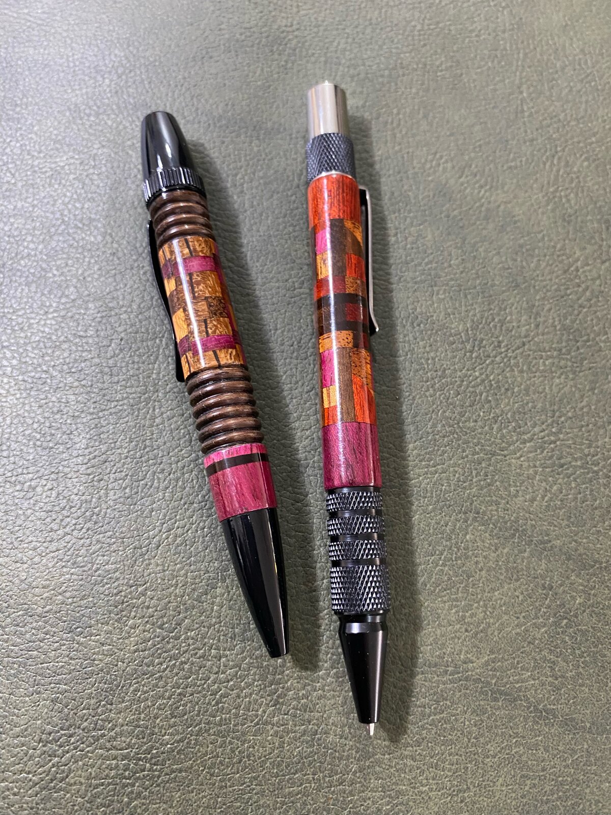

I'm starting doing segmented pens and I find it so fun. I've prepared some segmented blanks exploring different possibilities and used titebond 2 for all my blanks.
Once I used epoxy but for filling olive wood cracks.
greetings

Yes I have used Gabon ebony and Holy before in a pen. Nice combination. Here is an example of one I did.

I stopped using metal altogether for that reason. I've seen very few people have consistent success with it especially using it with angled cuts. Good luck with that one. I'm sure you know this but some others may not. To help reduce the risk of blowouts when's drilling a pen blank with scallops, drill thru the scallop end first.
