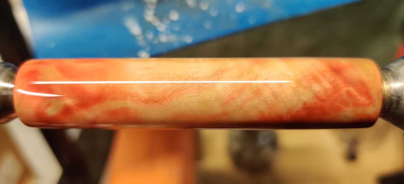

Ok, finally delving into my exploration of GluBoost. This has been coming for a while...I have a hard time moving onto new things, while I still have remaining old finishes. I'm just about out of Mercury Flex, and my Pens Plus seems to have gone bad. So the time has come, and I'm exploring GluBoost now.
I'm liking what I've been seeing so far. Ironically, I started with a GB+Oil combination, which was interesting, not entirely successfull, but managed to salvage it and the final finish is brilliant! Loving it. Pens Plus can get VERY crystal clear if you apply it right, and the chatoyance of the final result is incredible. None of my CA finishes have quite done that. I think in part, its the oil in the wood fibers, that do it... Anyway, I think GluBoost meets my bar, and the chatoyance with this first trial was sublime.
I've done a couple with just pure GB, and its great, clear, but I'm not quite sure the chatoyance is at the same level. I need to do a bit more polishing first, so I'm not drawing any final conclusions yet. I plan to try GB+BLO (used walnut oil before, and it didn't crosslink properly with the CA, remained wet even after more than 12 hours drying), and am even going to give GB+Danish a try (that includes varnish, so, I guess we'll see what happens...its mostly just an experiment, but I'm quite curious, as Danish Natural adds less yellowing than BLO.)
The one thing I have been having trouble with, is how much to over-turn the blank before applying the GluBoost finish. So far, I seem to be overturning far too much. I'm used to StickFast and Mercury, which seem to build up a lot faster than I am seeing with GluBoost. I haven't actually done a CA finish in about a year or so, so maybe I've forgotten my technique? Or does GluBoost just not build up the same as other CA glues?
Anyway, main question is: How much do you overturn to allow for GB coat buildup? How many coats are necessary to get a good result (after sanding and polishing as well) with GB? How thick should a GB finish end up being?
Thickness wise, I've been trying to gauge that, and even after a couple coats of thin to penetrate the wood fibers, and then 5-7 coats of the normal GB finish (is that "medium"?), it still seems to be paper thin? Is that normal? This definitely seems different than other CA finishes. It seems to be fluid and spreadable right up to the point where it suddenly is not, and the moment it hardens seems to happen suddenly (with Mercury it seems to progress more slowly), so maybe I'm just not getting enough CA actually on my blanks?

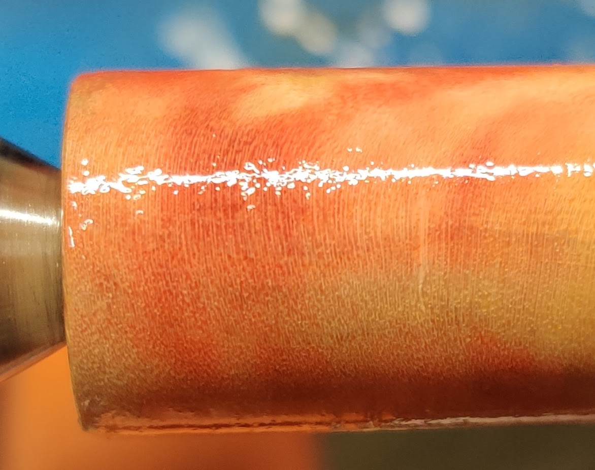

Thanks for the video, Mark. I do use the accelerator. Reading the GluBoost site and docs, they say to use it, so I have been.
One thing I have noted...the accelerator says it is non blushing, and so far, I have not seen any blush. HOWEVER...I do seem to be getting, as best I can tell, a bit of "wrinkle"? When I first apply a thin layer of the glue on top of another layer, its super clear, very slight ripple usually that you can see subtly in the shine line. Then I'll hit it with a very minimal amount of GB accelerator, just a momentary blast while the blank is turning. A few moments later...a fine wrinkle occurs in the glue surface. From a distance, the shine line goes from super sharp and slightly rippled, to fat and dull. Very close inspection indicates the glue surface has wrinkled. Its fine, and it all sands out just fine, and I'm getting crystal clear results in the end...
Still, is wrinkling like that normal? The bottle says it maintains a crystal clear finish.

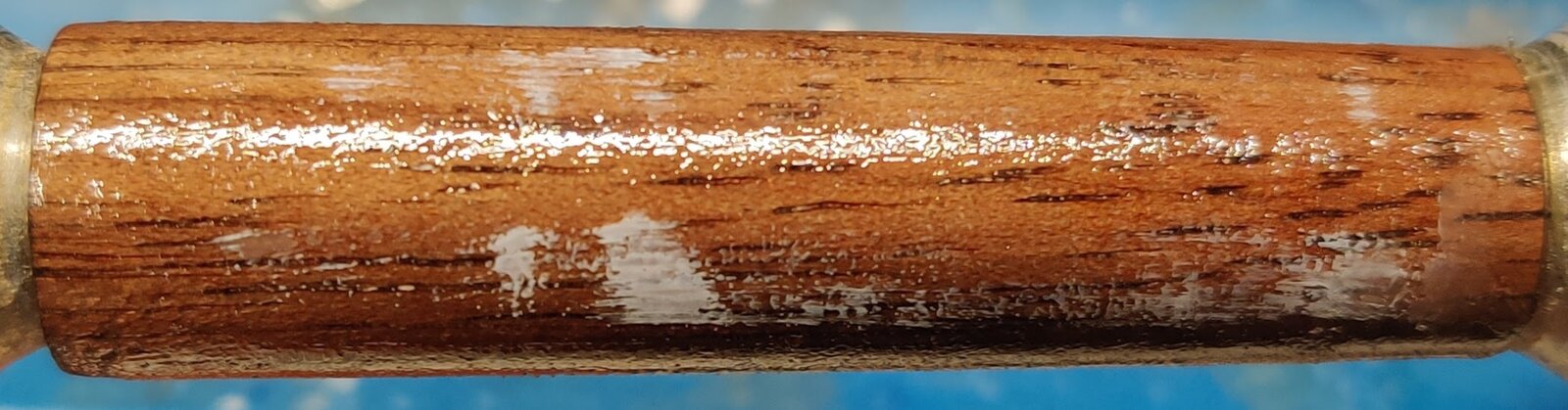

Well, color me baffled. And loss for loss.
In lieu of craft foam, which...I am not entirely sure I know what it is, and the local walmart (just a few minutes away, and the only place still open that might have had any) did not seem to have what I presumed it was (some kind of solid foam core, with a veneer of some kind of plastic or maybe cardstock surface?)...I contact-cemented a strip of wax paper to one of these fat popsicle sticks I have.

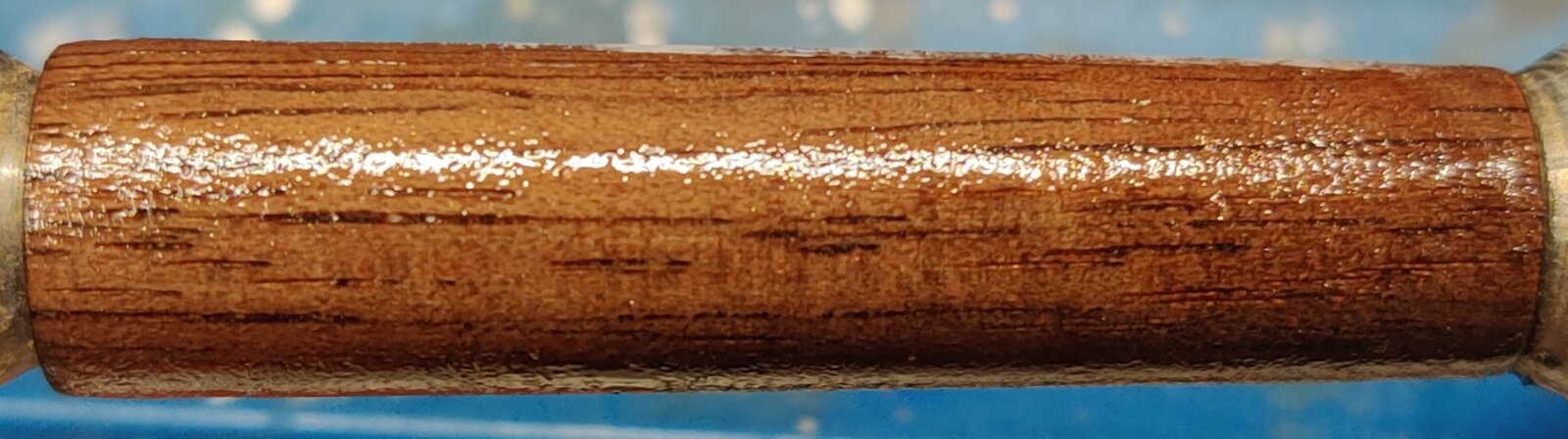

Well, that worked like a charm. Well, almost...had a bit of trouble getting glue to contact around the curvature of the blank, probably because the popsicle stick was too wide, but it all went on clean, clear, with a pretty sharp shine line with just a couple of little ripples. I thought "Boom! Todd's a winner! That did it!"....
So, true to the instructions, after letting the blank spin for about a minute as I admired it... I gave it a quick blast of gluboost accelerator aaaaaand....a few seconds later, in about an instant, my real nice shine line and clear coat of finish, turned into this:
The Wrinkle. The finish was fine for a minute or so. I suspect it may well have hardened already before I applied the accelerator. Took about 2, 3 seconds after applying, to very quickly, probably as the accelerator finished evaporating, less than a second to go from real nice sharp shine line, to this. I maybe blasted the accelerator for about a second (not even, half a second), a quick swipe down the length of the blank while the lathe was on (and it was not spinning fast, it was fairly slow.)
Either...I am a baffoon and I am missing something obvious and making some dumb mistake here...
Or...there is some environmental factor, too much moisture in the air? I think my humidity is still over 70% (it just rained about a half hour ago)...
Or...maybe the batch of accelerator, or the glue itself, is bad?
Baffled.

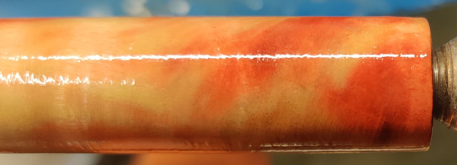

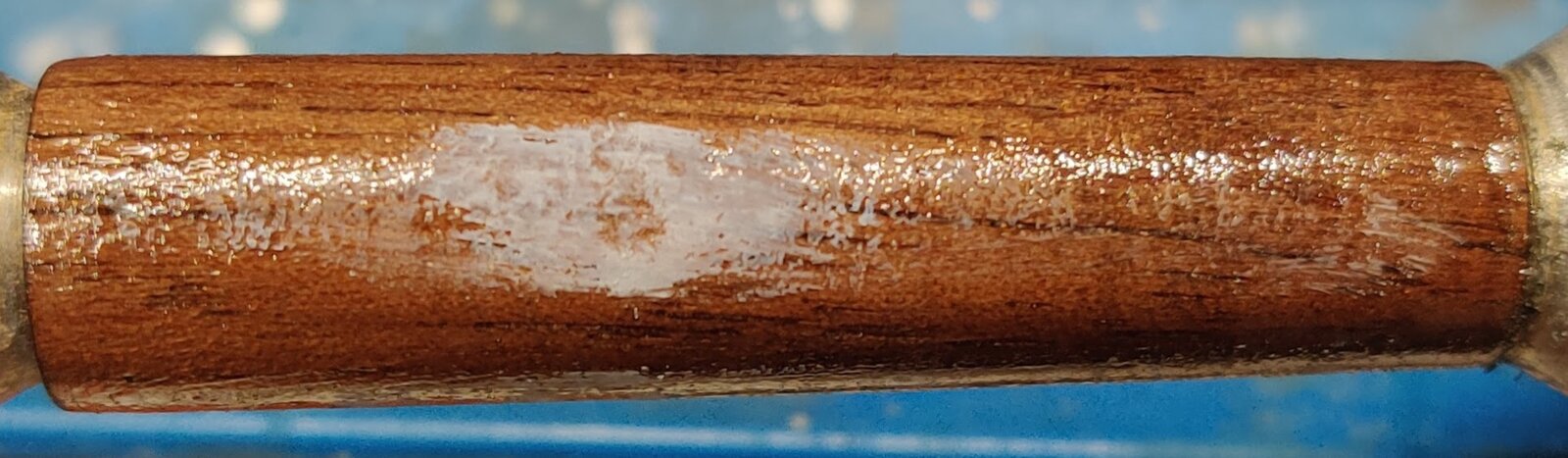

Well, I definitely have a very, very serious problem. It took minutes for this coat of GluBoost (blue) to dry without accelerator. It is both wrinkled, and demonstrates blushing.
I thought GB was supposed to be immune to this! Humidity right now is middle ground, not particularly high (sun finally came out and the storm from yesterday finally seems to be moving on), but not low either. I thought GB was supposed to never blush!!
I am honestly wondering what this is.. Is that blush? Or...is that something else? It looks almost like some kind of crystalline formation in the CA... ON, rather... Humidity right now is 43%...

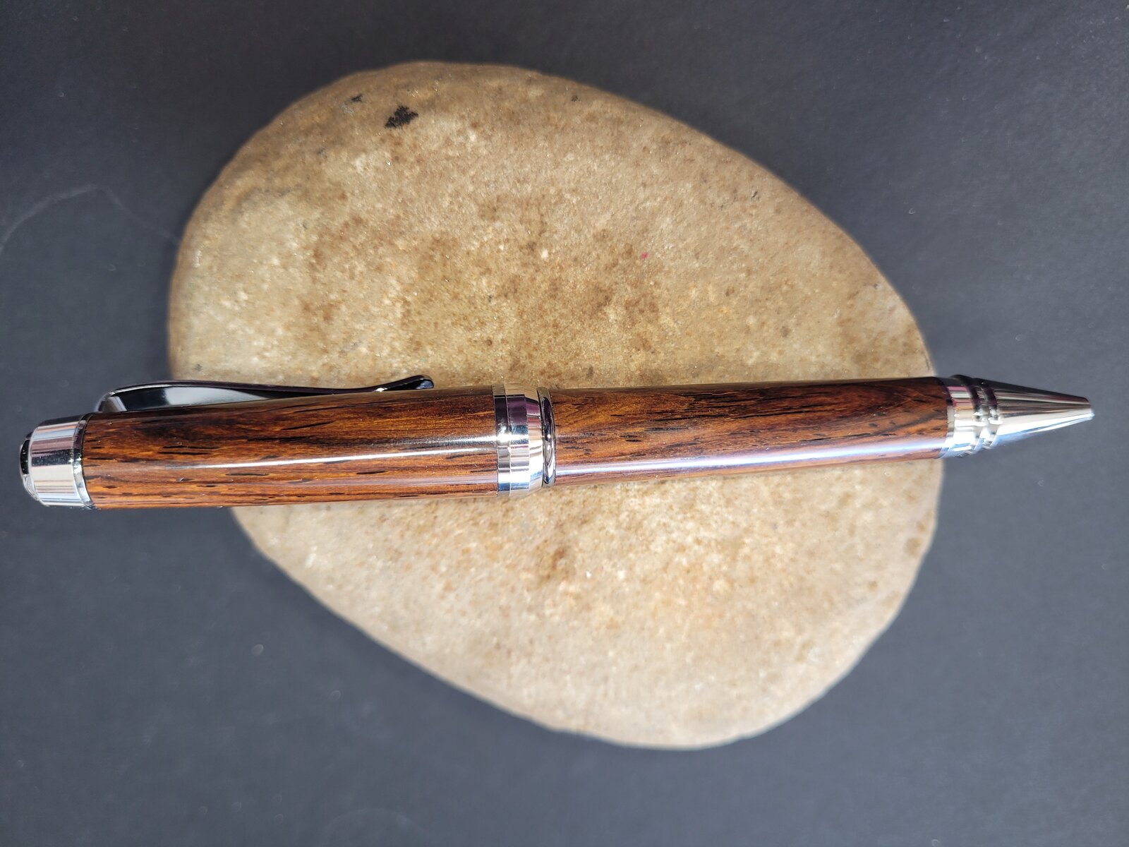

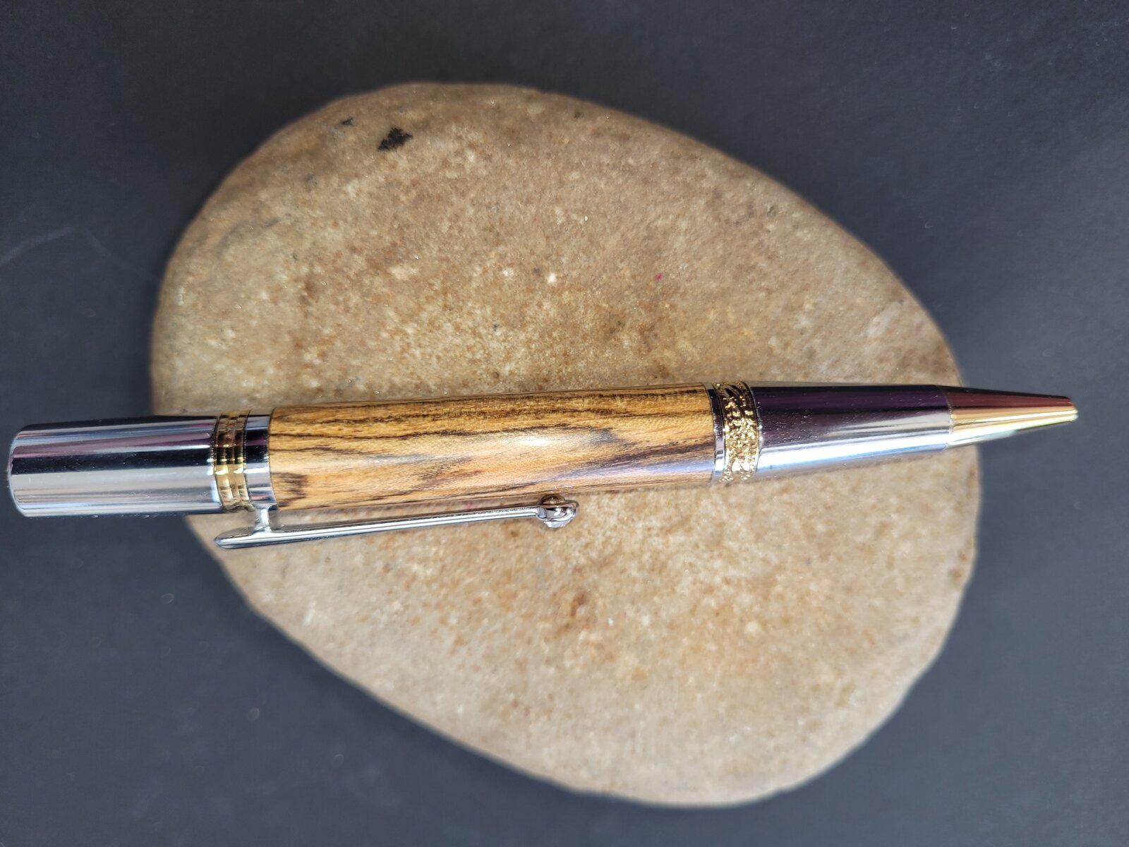

Here are a couple of finished pens.
Photography is terrible, used my phone in the shop. Lighting is nice for working out there, but a little harsh for pics.
I did not buff them with a cloth or anything, just took them out of the tube I store them in and took pics.
Hope this helps.

So, throughout these trials, I've used many different application techniques. Tried putting a drop of GB on a folded paper towel applicator. Tried using a folded paper towel applicator and putting GB directly on the blank (thin little stream as I move along the blank). I've tried putting a drop of glue on a foam applicator. I've tried a thin line of glue on a foam applicator. I've tried a foam applicator while putting a thin stream of glue on the blank while its turning, same as with the paper towel.
The only time I received these white streaks, was with the foam. So, this foam, which I think is the wrong stuff anyway (it seems to very rapidly absorb the glue, so must be open cell foam), is out. Not going to use it again. I'm currently back to a folded paper towel, putting the glue on the blank.

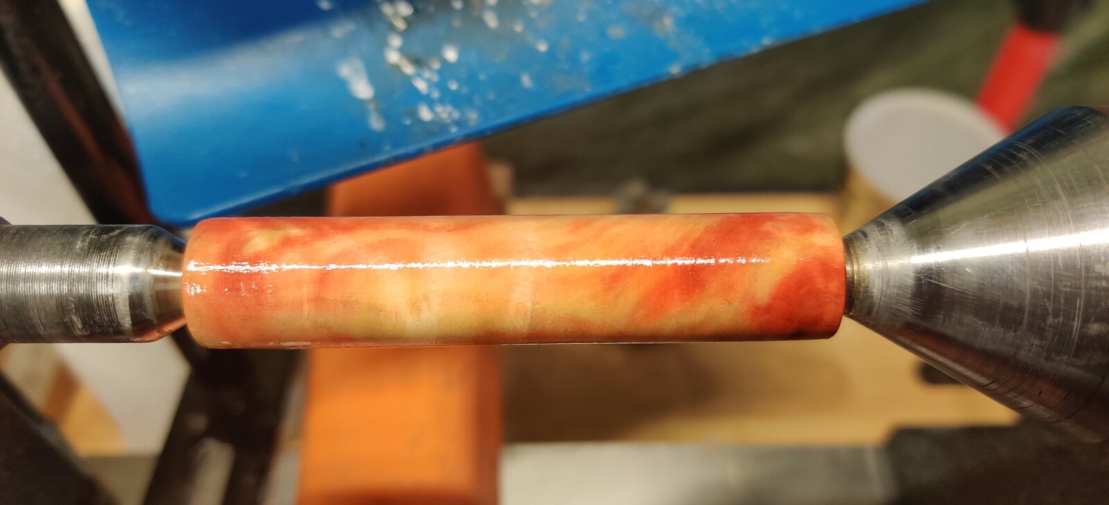

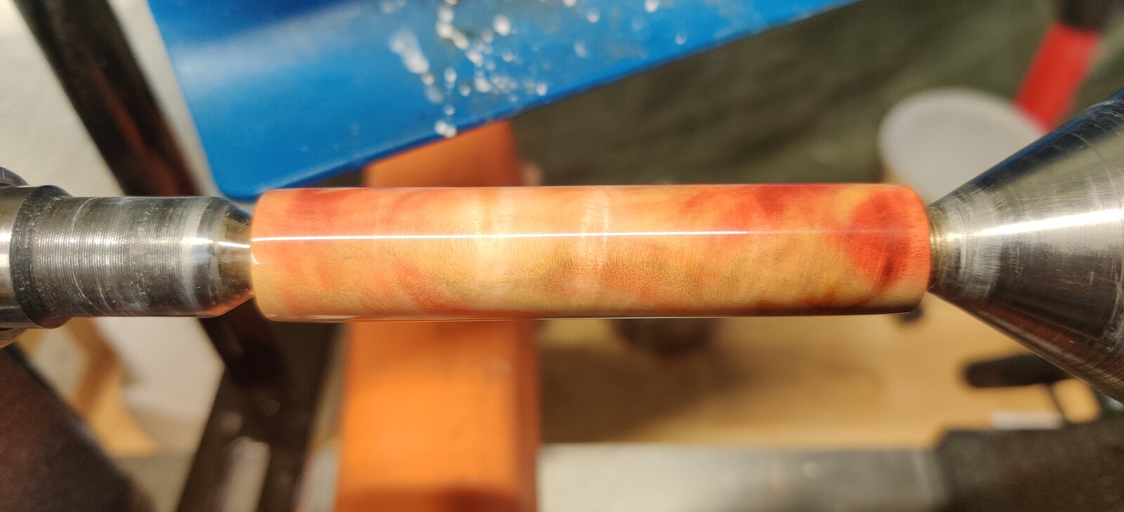

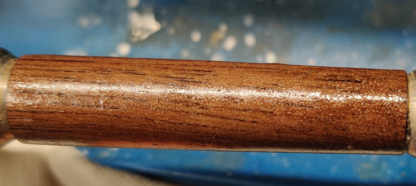

Well, so far, better with the flame boxelder, than with the perivian walnut... That said, its not perfect. Still seem to have only 3-4 seconds to spread the glue out before it gums up and sticks. I used paper towel again...afraid to use the foam, I think its got some kind of residue on it, or maybe its outgassing something, that runed the last coat on the peruvian blank.
This is several coats of thin, with a very small blast of GluDry on the second thin coat. Then a few of the thicker stuff, with a very short blast of gludry on the last one. I am going to try putting on a few coats of thin on top of this...but, it wasn't entirely dry (touching the side edge on the left side, it was still tacky), so letting it dry more.
Its shinier, but, the left side shows problems as that was about 2-3 seconds in when it started to gum up. It has some wrinkle, but not as bad as I was getting with the peruvian walnut blanks. All of the blanks were cleaned with acetone, then turned on the lathe and let it spin with the dust collection going for a while to make sure they dried out as thoroughly as possible (I know the common DNA and Acetone you buy in metal cans are often softened a bit with some water).
Still hard to apply. I just don't have any working time. Moving as fast as my 40 year old hands can move, I get about two passes and then its gumming up (and if I don't take the applicator away right then, then it starts sticking and pulling fibers out in another second or two). It seems the thick, is more problematic than the thin. Thick really gums up. The thin seemed easier to apply... It certainy doesn't build up much, but it doesnt seem to go sticky as fast. I guess I have 5 seconds or maybe a little more. It does seem to wrinkle, but not quite to the same degree as the blue.
Anyway....back to the...journey...

After putting on a couple of coats of thin, and a distant blast of gludry, and a couple of sequences of sanding and polishing, I ended up with this on the flame boxelder:
Sanding took a while, due to that bump on the left end where things kept sticking. Process was roughly as follows with times spent sanding for each grit:
Dry:
400: light, 1m (mostly in the bumpy left side)
600: 2m (+1m lighter around the left edge to really even out that bumpy area)
Wet:
600: 1m
800: 30s
1200: 10s
1500: 10s
2000: 30s
3000: 2m
After this, things looked pretty good, but satin, not shiny. I then used the last few grits of Zona paper, maybe 40 seconds on the lowest grit, then ~20 seconds each on the rest, and ended up with this:
Zona Paper is by far the best finishing sandpaper I've ever used... This stuff is magical.
Then finally, after some polishing (probably 3-4 minutes) with Meguiar's:
There are still some fine radial scratches that catch the right kind of light. So I will probably buff with blue rouge a bit later. But, this is a pretty good result. Just not quite happy with the application process, and how quickly sticky the darn glue gets when applying, and how it dries...I seem to get wrinkle every coat.
The imperfections of each layer may show through in the end. I'll have to see if I can get some photos, but, there are a smattering of tiny defects in this, that I thought were on the surface, but I simply cannot feel anything at surface level. On closer inspection, it looks like something a few layers in, and as such, unfixable. (At least, not without stripping and restarting.) I think its these little globs that form when the glue gets sticky and grabby. I don't think there are any fibers in there, just...janky globs of glue. Hopefully GluBoost Team will help me figure this out. I'm getting skeptical that its a humidity issue, unless this glue is particularly sensitive to humidity. I've been sitting around 40% most of the day...
Anyway, I don't know of the sheer mindblowing level of chatoyance is showing through in these photos or not, but...wow.... I'm definitely hooked on that! Box elder in general, and particularly this flam stuff, has great chatoyance in general, and man GB BRINGS IT OUT!
Hope this helps.
Gave these instructions a try, Mike.
Sadly, no luck... The BLO and GB don't seem to be mixing, same experience as I had with the walnut oil and GB. The oil seems to stay wet, no matter how long I wait. The finish in the end is very satin, not shiny, basically no chatoyance to be seen. My humidity is around 35-38%, so not very high, about the same as it was yesterday. I don't know what to think...GluBoost is the most raved about CA I've seen on these forums. I don't know if I just got a bad batch of bottles, or if somehow my humidity is too high, or if I am just doing something wrong...
In any case. It may be a bust for me, which is really quite depressing... The finish is incredible when it is finally flat and clear. If I could just get decent coats to apply, without burning through an entire bottle in 10 pens, it would be ideal.

Aye, lathe is on and pinning when I apply. Its 1000 rpm, which with the small diameters of pens is not all that fast...but, if necessary, I could make it even slower by adjusting the belt to the next gear ratio. I applied BLO first, and used some pressure to get it into the wood and dryish. Couple drops of GB, and about 2-3 seconds in before I could even spread it out enough, it was sticky and streaking. I kept spreading, just to get it done, put a couple more drops of BLO on the applicator and spread that out. That smoothed out the streaking that was in the GB, and for a moment I ended up with a nice shine line, but then that dulled as I dried it out...the next coat of GB did the same thing, sticky and streaky. Put on a few coats, BLO then GB, spread it out. I left it to dry for a while. In the end, it was more of a satin finish, with a few spots that were shiny. I left it for a while, checked it maybe an hour later, and it was still wet, and totally dull with a satin sheen. Left it for a good while, couple of hours or so, still wet. I tried to buff it up and see if it would get shiny...stayed very dull and satin. If I wanted a satin finish, it seems like a very good way to get one, but, it really flattened out the wood, and it was pretty uninteresting, lacking any chatoyance at all that I could see. I put on a very thin coat of BLO, and I ended up with a really nice shine line while the lathe was spinning. But when I turned it off, I could tell that it was a broke finish, with spots of shine and spots of dull satin and a certain streakiness to a lot of it.
Either something is wrong with my GluBoost, or something is wrong with my hygrometer and my humidity is way higher than I think it is...
I ended up trying to coat the BLO+GB, after drying the blank as best I could with numerous passes with clean paper towel, and then with just some pure GB layers of thin, then a few more of thick. That seemed to work, although still got the heavily wrinkled look in each layer once it was dry. I built up what I thought was a decent amount of layering, but when trying to sand the wrinkles out, I ended up sanding through the solid GB layers into the BLO+GB layers at the peak of the curvature of the pen blank (had a very slight bulge). That was it for that blank (at least it was a test blank from a botched batch of pens!)
So, I'm going to be sticking to just pure GB for now, here... I don't know why it wrinkles, but this stuff must be EXCEPTIONALLY sensitive to humidity. It was not that humid today, my meter was reading 35-38% most of the day, then it jumped up to 42% when a thunderstorm rolled in a couple hours ago. The great irony is, Colorado is not a humid place! :p For a good decade, its usually been 10-20% humidity during this time of the year...which may well have been ideal for GluBoost? 🤷‍♂️
The one thing that actually HAS been consistent, is the temperature. Its been high 70s to low 80s the entire time I've been playing with GluBoost. I'm wondering if the high temperature has something to do with my experience here... I am also wondering if there is just something about the environment of my garage that is causing problems, so I've opened up the garage door and back door, to try and just exchange the entire mass of air... I'm grasping at straws now...don't know what else to think. Would be real nice to have the ~10 seconds or so working time I've been seeing in people's youtube videos to spread this stuff around. I think it could be a highly efficient finish. The GluBoost team themselves said I should use less, but when I use less, it seems to gum up even faster, in some cases the instant I apply the applicator to the blank. It also seems particularly thick...even the thin, doesnt' feel very thin. It feels sticky even from the moment I apply it, and it doesn't move like the thin of other CA glues I've used... The thicker blue bottle of GB feels more like goo, than anything. I originally thought that was just the difference on CA formulas as GB is definitely different stuff, given its intentional design as a finish...but now that I've worked with it for a few days here...I'm beginning to wonder...
I may just pick up a couple of other bottles here, from a different source, and see if I have the same problems. This stuff feels so sticky, and very...rubbery when dry? Even when I really load on the GluDry, it still seems very rubbery, rather than hard. The last couple of blanks did not sand well, didn't feel normal. So, I am really starting to think something is wrong. Maybe something in my environment ruined the glue in these two bottles. Maybe the heat was too much. In any case, hopefully some new bottles will work better.

I'm quite convinced that you've got a bad bottle. Did you order it recently? Or is it old? Maybe if you ordered it recently it sat in a truck in the sun for three days at 140 degrees? I don't know if that's bad for Gluboost, but I know that's very bad for alumilite.
I have found Gluboost to be very easy to work with. You've done your homework reading and watching the how-to's. If it's not working like the videos, I'd blame the bottle.

I got a call from Ed @ Exotic Blanks earlier. I ordered some new bottles from him.
He mentioned that over 70% humidity, you'll likely have problems, over 75% and it won't work: Wait till the next day. Under 70% and you have a very good chance it will give you that crystal clear finish. He mentioned he works with it all from 40% to 70% humidity.
@leehljp FWIW, I HAVE an evaporative cooler in the garage, its the only cooler I have out there...I have not actually been running it, though. I was just saying above, I knew that using the evaporative cooler would cause issues. It hadn't been run in a while though...there was no need, with the high humidity thunderstorms rolling through one after another.
Day 1, we had a big thunderstorm roll through, and humidity got up to 80% for a while. That was maybe an hour or thereabouts. However, outside of that period of time, its been between 35% and 60%...usually somewhere between 35% and 45%. It is pretty dry here normally, so when storms blow out, humidity will usually plummet. We had a storm last night, humidity hit 60%. I wasn't doing anything with GluBoost at the time. It was 50% this morning when I took the trash out.
If what Ed says is correct, then, 35%, 45%, 50%, should be ok for GluBoost (and he got his information from some kind of webcast I think, where the GluBoost guys themselves presented).
I guess I'll see in a few days here, if the bottles I ordered from Ed work any better. If they do, then it was likely the bottles I picked up a week ago... If not...well.... 🤷‍♂️
