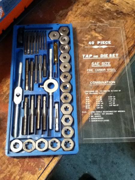

SCORE!!! My grandpa had this set of tap/dies he never uses anymore. Now all I need is the acrylic rod and a way to hold the dies on the lathe.
Right on Joe! Just need a die holder and tap guide. I would bet one of our members has them and NOT using them.:wink:
Tap guide...? Won't a drill chuck work?
Yes, it will work. Although I've never tried tapping that way myself. I've read that others have done it this way. But, for the money I chose the guide. It was worth it to me.

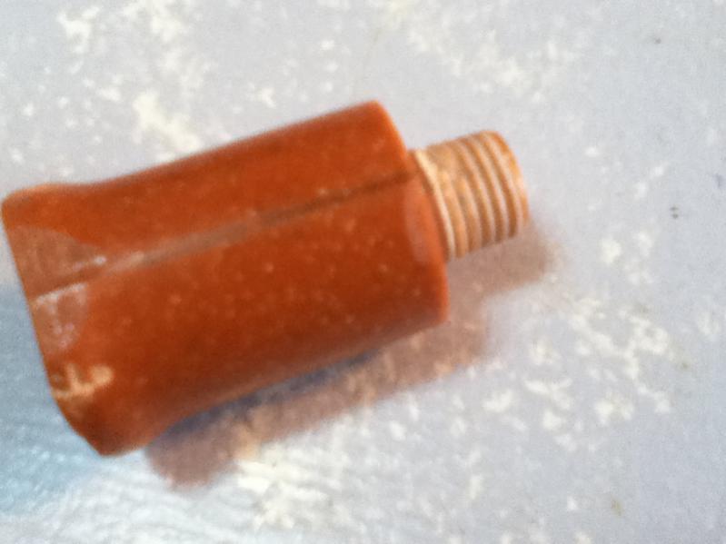

No acrylic rod yet, but I had a leftover bit of corian to try a die on. Worked nice but I think the threads would look a little better with a bit of mineral oil on them. Next step is using a tap to make something to screw onto it.
PS: hard maple didn't work too well... I might try again when I have more experience.

Played around again a little earlier, tapping is pretty easy for me, but getting the right size tennon for a die is still a challenge. The mineral oil made the first piece look better.
Take a few moments and scroll back through past threads in the advanced pen making forum. There are lots of threads about sizing tenons for dies and hole sizes for taps. Probably every size used on pens has been mentioned over the past few years. That forum is a good source of information.
Joe, here's a formula another member gave me:
Tenon size for threading with the die is always about .2mm subtracted from the nominal die size.
Example -- For a 14 x 1 die, the tenon should be 13.8

The main reason 'standard' sets won't work is they are too coarse for some of the threading.
For metric, 0.75mm pitch (distance from thread to thread) is commonly used; this works out to ±34 TPI (teeth per inch, the way standard threads are measured).
For the cap/body connection 1/2" (12.7mm) would be the closest match to the commonly used 12mm. 1/2" fine threads are 20 TPI or 42% coarser than what is commonly used. This isn't saying that won't work, but it may
cause issues.
