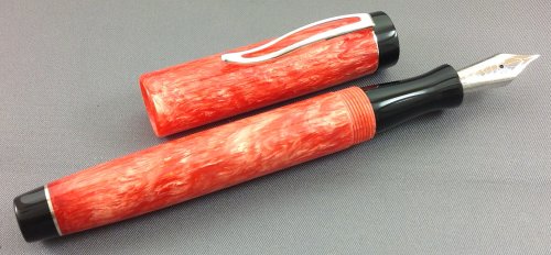

Joe, As an aid in helping you get started, here is a list of every drill and tap I use to make one particular pen. With this pen you have five pieces to make and the order you make them in isn't really important but just relax, sit back and think about how the pieces fit together and before you know it, you have a mockup of your pen. Remember.... you are NOT trying to make a functional pen the first few go rounds, just practicing making the parts then seeing how they will fit together.
As you make the pieces, keep in mind the clip you want to use as it will determine the thread sizes used for the finial and the overall diameter of the pen.
The pen shown below was made by using these drills, taps and dies and nothing else. I use a lot of metric drills but if you don't have them, don't worry, just use something similar in size and it might work. If my counting is accurate, you will use 10 different drill bits, 3 taps and two dies.
Sources I used for the tools:
Center drill, general taps and dies - Victor tools www.victornet.com/index.html
14mm multi-start tap and die set - Mike Redburn www.silverpenparts.com/
For the clips, Bock taps and Bock nibs and feeds I use both Mike Kennedy www.indy-pen-dance.com/ and Roy Robaldo CLASSIC NIB - FEEDS
So, here ya go, the tools and basically where they are used.......... HAVE FUN!
[FONT=Tahoma, sans-serif]Upper Finial[/FONT]
[FONT=Tahoma, sans-serif]Turn rod to .630" dia then turn a .395" tenon then cut 10mm x 1mm threads with a die
[/FONT]
[FONT=Tahoma, sans-serif]Lower Finial –[/FONT]
[FONT=Tahoma, sans-serif]Turn rod to .520"[/FONT][FONT=Tahoma, sans-serif] dia then turn tenon .250" wide x .375" dia to fit snugly into a 9.5mm hole, part off leaving exposed finial .300" long, with a total finial .550" long.[/FONT]
[FONT=Tahoma, sans-serif]Body – [/FONT]
[FONT=Tahoma, sans-serif]Turn rod to .5[/FONT][FONT=Tahoma, sans-serif]75" dia[/FONT][FONT=Tahoma, sans-serif]at [/FONT][FONT=Tahoma, sans-serif]least 3.1"long [/FONT][FONT=Tahoma, sans-serif]then c[/FONT][FONT=Tahoma, sans-serif]enter drill and square up one edge[/FONT]
[FONT=Tahoma, sans-serif]Drill 9.5mm hole then glue in silver ring and finial [/FONT]
[FONT=Tahoma, sans-serif]Cut 14mm M/S threads with die[/FONT]
[FONT=Tahoma, sans-serif]Drill 6.4mm to 3.00" depth for converter clearance[/FONT]
[FONT=Tahoma, sans-serif]Drill 8mm to 2.4" depth for converter clearance[/FONT]
[FONT=Tahoma, sans-serif]Drill 9mm to .500" depth[/FONT]
[FONT=Tahoma, sans-serif]Tap 10mm x 1mm threads [/FONT]
[FONT=Tahoma, sans-serif]Cap – [/FONT]
[FONT=Tahoma, sans-serif]Turn rod to .640" dia at least 2.4" long then center drill and square up one edge[/FONT]
[FONT=Tahoma, sans-serif]Drill 9.7mm to 1.9" depth[/FONT]
[FONT=Tahoma, sans-serif]Drill 1/2" to 1.25" depth[/FONT]
[FONT=Tahoma, sans-serif]Drill 33/64" to 1.0" [/FONT]
[FONT=Tahoma, sans-serif]Tap to cut 14mm M/S threads [/FONT]
[FONT=Tahoma, sans-serif]Flip blank, then square edge and center drill[/FONT]
[FONT=Tahoma, sans-serif]Drill 9mm hole to .5" depth[/FONT]
[FONT=Tahoma, sans-serif]Section for #6 Bock feed [/FONT]
[FONT=Tahoma, sans-serif]Turn blank to .490" diameter[/FONT]
[FONT=Tahoma, sans-serif]Drill 6.4mm hole 1.3" deep[/FONT]
[FONT=Tahoma, sans-serif]Turn a .210" wide tenon to .390" diameter, thread with 10mm x 1mm die[/FONT]
[FONT=Tahoma, sans-serif]Drill 7.0mm hole to .100" depth for converter lip clearance [/FONT]
[FONT=Tahoma, sans-serif]Part off to 1.185" long then flip around in chuck[/FONT]
[FONT=Tahoma, sans-serif]Drill 7.3mm hole to .820" depth for tapping [/FONT]
[FONT=Tahoma, sans-serif]Drill 8.2mm to .550" for feed housing then tap with Bock large tap (for 6mm nib/feed) [/FONT]

1. take a 6.4mm bit and drill a hole 3.1" deep in the lower body for the converter clearance.
2. take a 8mm drill and drill the lower body 2.35" for the converter body clearance
3. take a 9mm drill and drill a hole for the 10mm x 1mm threads which will......
And I just don't think that's going to happen. Even the tutorials are deliberately left vague to spur the imagination of the readers.
My post above is not intended to be a step by step set of instructions, it is simply a list of particular drill bits, taps and dies used to make the pen in the photo.
I'm thinking if one were to look at the photo then look at the list which has the tools used on each part of the pen they could probably figure out how to make that part where it will line up with the other parts.
As an example, the [FONT=Tahoma, sans-serif]Upper Finial[/FONT] says....
[FONT=Tahoma, sans-serif]"Turn rod to .630" dia then turn a .395" tenon then cut 10mm x 1mm threads with a die[/FONT]"
With that information, one would chuck up a blank, turn it down to .630" Dia then turn a tenon to .395" dia then run the die up to the tenon and cut the male threads which will eventually thread into the top of the pen cap. I'm leaving little things like tenon length, finial length of the finial and parting off the finished finial to the imagination of the pen maker, after all, they have to have some fun with this just like I did when I started doing these.
I may be wrong but I think several members are willing to help out, just not hand out step by step worksheets to things they themselves spent months figuring out with a lot of trial and error.
