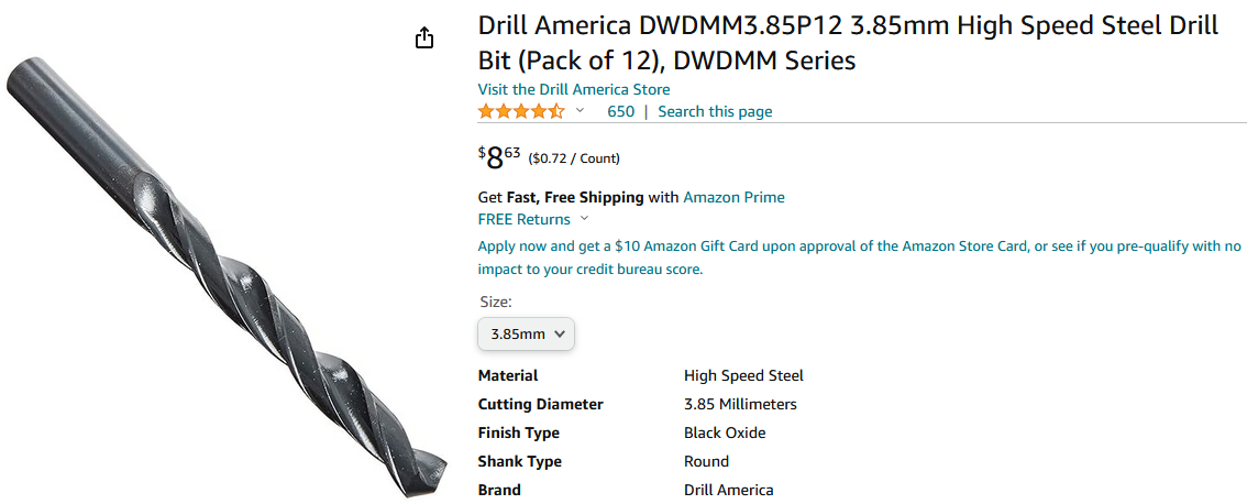

I can ask the tap company what drill bit they recommend and if they might sell it as well.
I assume it would be something like: 4.2mm - 0.35mm = 3.85mm... which is apparently sold on Amazon here in the US and for about $0.75 each!...
Instead of a die, I might be able to add matching drill bits to the order form if there is interest.
If I'm wrong on the drill size methodology, someone please let me know!

I added a 3.8mm and 3.9mm to my order to try both sizes from Victor Machinery for $0.85 each.
I use a number 25 drill bit which is 3.80MM --.145 and it works good for 75% threads.
