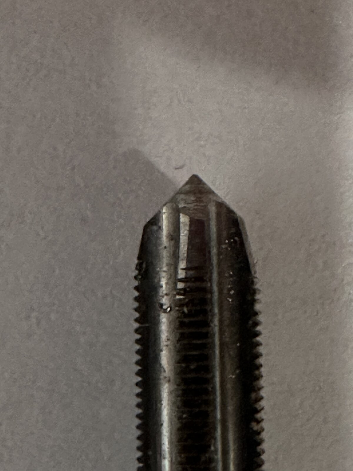

Here is what my tap says and have been using it for several years building pen with the SKM192
Got tap from a IAP group purchase several years ago tap M4.2x0.35 6H-HSS part number 8221 which may be job or invoice number. tap is NOT plug tap
. Works great on alum, Brass and plastic.
Got tap from a IAP group purchase several years ago tap mM4.2x0.35 6H-HSS part number 8221 which may be job or invoice number. Not tap is NOT pul tap but bottom tap. Works great on alum, Brass and plastic.
