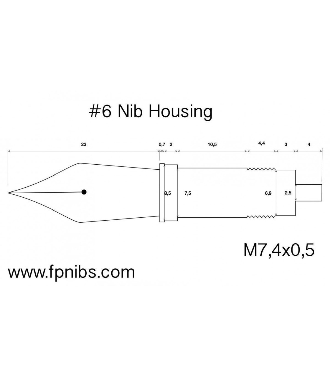

If you contact Beaufort Ink they will send you the drawings for the Bock housings and sections. I had asked them for permission to add them to the library and they said that they would prefer each individual to contact them instead.

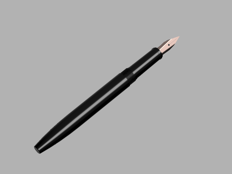

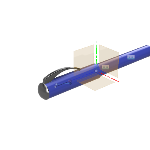

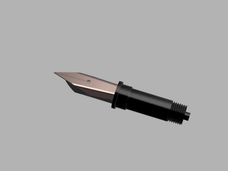

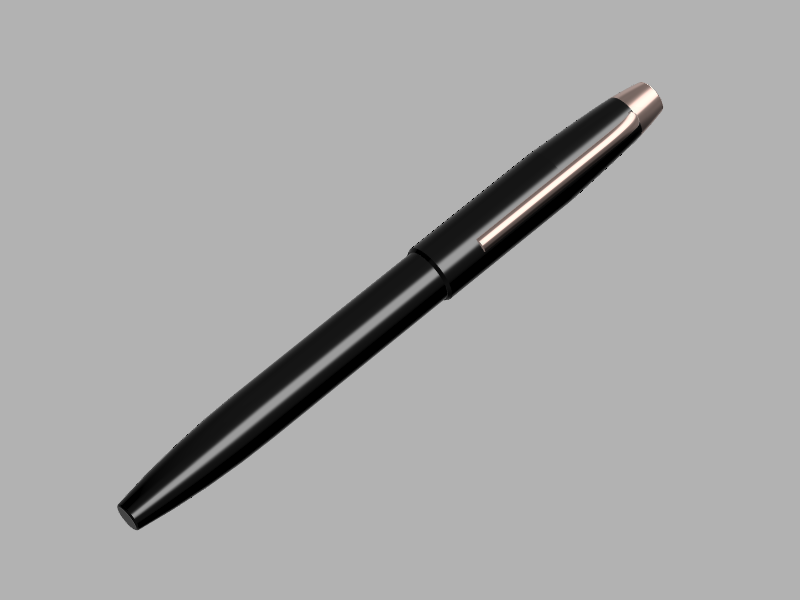

Hi
Here is a rendering of my Bash submission. sorry for the axis artifacts can't figure out how to turn this one off. And, I cut off the end. I tried to attach my number 5 Schmidt nib as an .STL but can't attach a file.

Hi
VERY NICE! It looks like the sketches are still turned on, could be the issue with the planes showing. They should turn off in the Render section. Click on the "DESIGN" button in upper left corner and go down to RENDER.
In Render there is an option under the "IN-CANVAS RENDER" option to Capture an image to export the picture.
