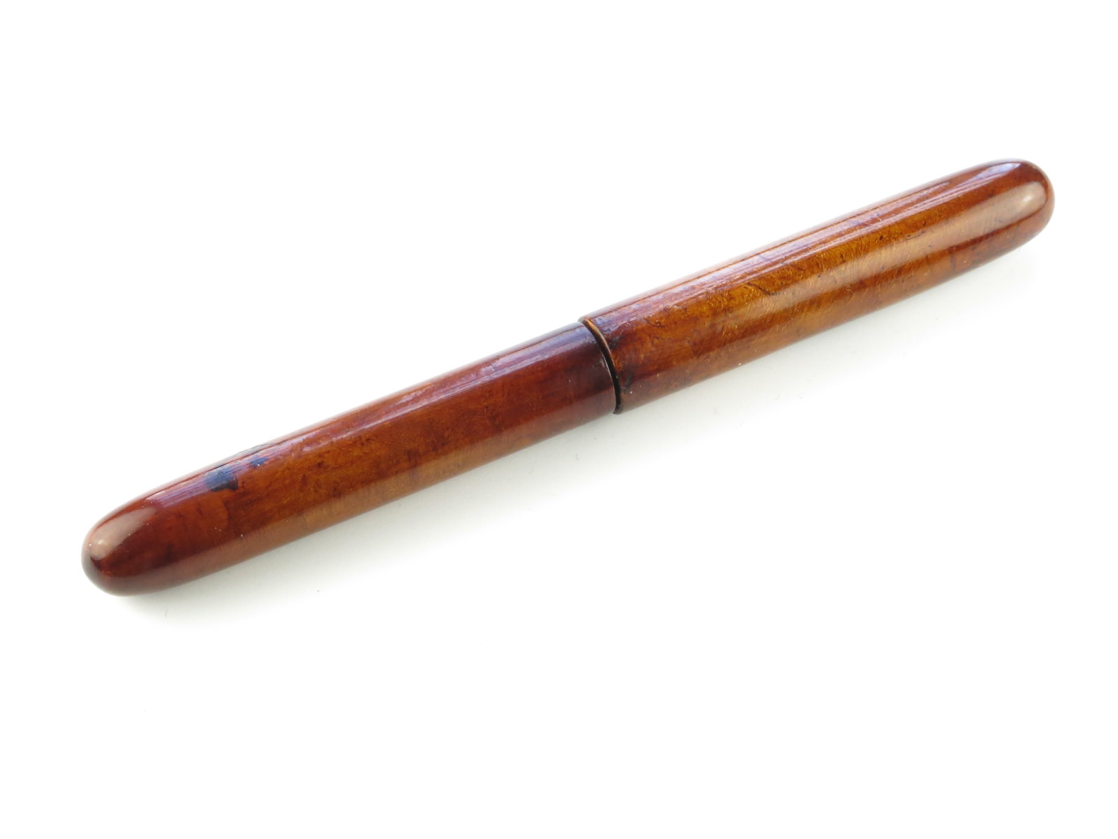

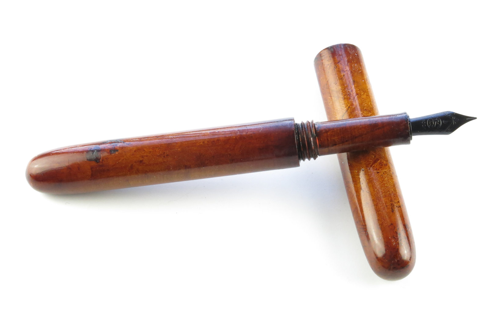

Cherry burl FP, fuki urushi finish, Bock #5 black nib

Wow great job. I like the shape. The timber is outstanding. The Urushi finish really makes it pop. How many layers is it? How long did it take. Threads are clean as well. Did you use a metal lathe or Die? Awesome!

Thanks! I used 9 layers of transparent urushi. I started the work on Jan 6 so from start to finish about 6-7 weeks. The urushi is actually still curing, so it will stay in the furo for a couple more weeks I'm guessing. Lots of problems working with the burl; had to completely restart when I got to the threading because there were some punky areas in the threading area that blew out; altogether I made 5 complete sections before I got one where the section threading didn't blow out. I did the initial turning to size and final shaping on the wood lathe but pretty much everything else on the metal lathe. Threading was done using a high speed threadmill attached to the metal lathe (part to be threaded held in place at the headstock and the thread mill mounted on the cross-slide).

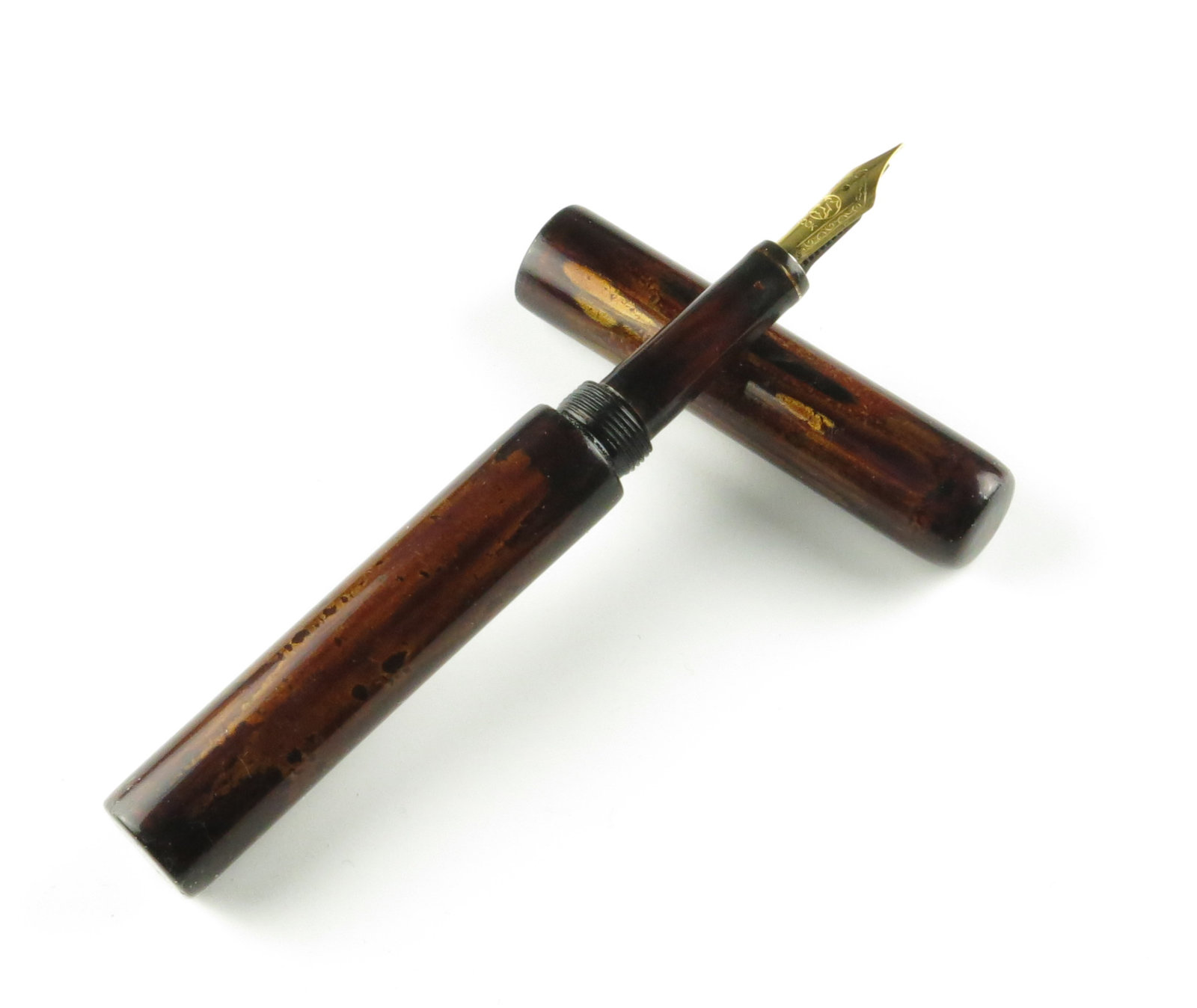

One of the fun (but occaisionally frustrating) things about urushi is that it does require a good deal of trial and error and experimentation, but you can keep going with the same pen stock and keep adding layers and keep learning with each layer. The first pen I did with a urushi finish started last October and I just finished it, largely because I was never satisfied with it. It has over 30 layers, each requiring at least 24 hours in the furo, some sanding or polishing before the next layer, etc. That pen even spent 2 weeks in a jewelry tumbler because I got disgusted and threw it in just to see what would happen. Here's a picture of it after all my trials and errors. The form of the pen is admittedly a bit funky, but the finish turned out pretty interesting and has a beautiful depth to it. This pen started out as an attempt at maki-e, and you can see some of the sprinkled gold peeking through in places.

Nice second pen too. Is that a gold band on the section, or an optical illusion?

Good question about the section. I made the pen as I was learning how to do kitless and I had not learned how to make a section yet, so the one on the 2nd pen is a Bock section that I purchased. When I threw all the parts in the jewelry tumbler, some of the finish on the section came off revealing metal underneath, which I basically left alone.
