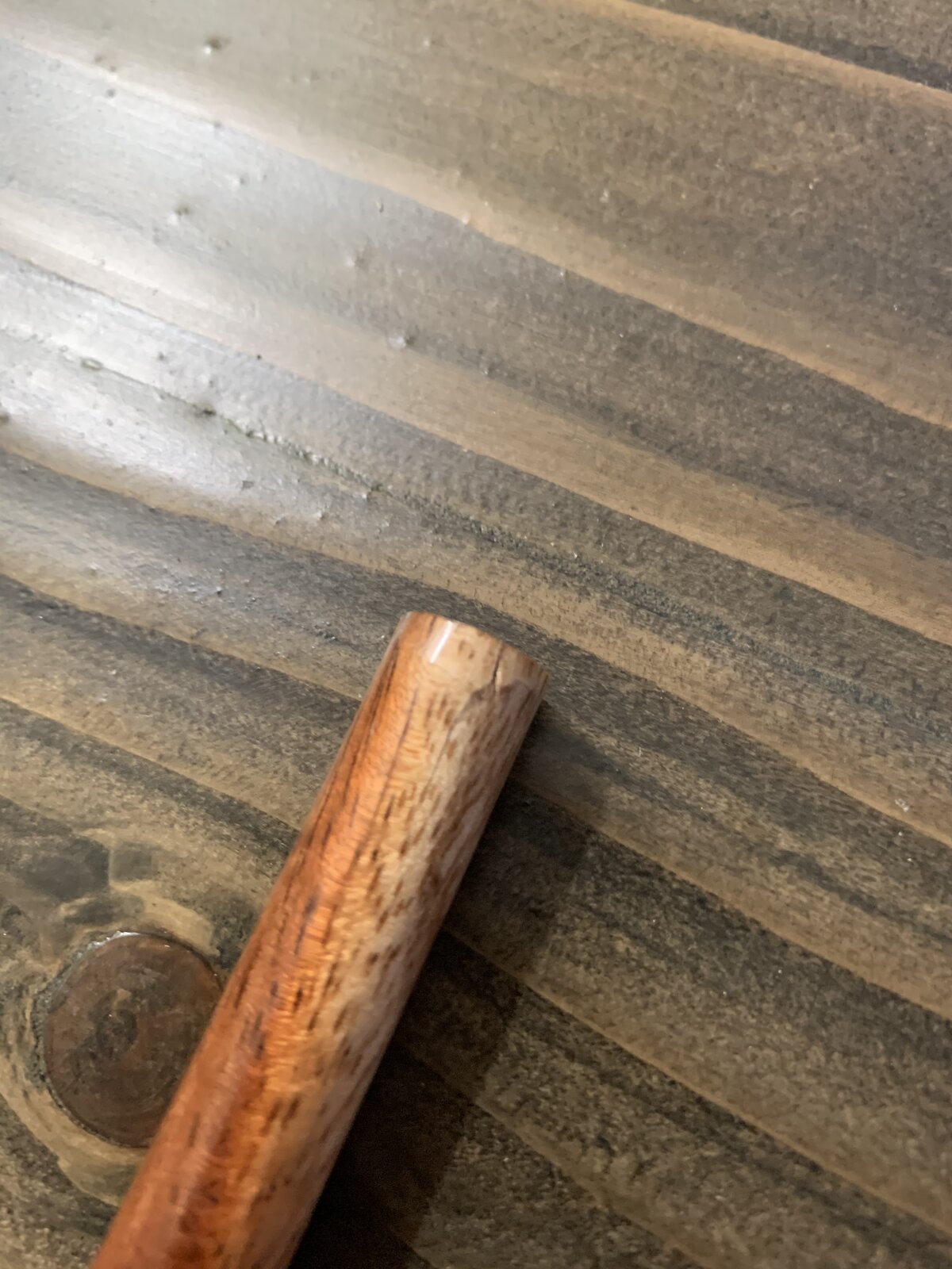

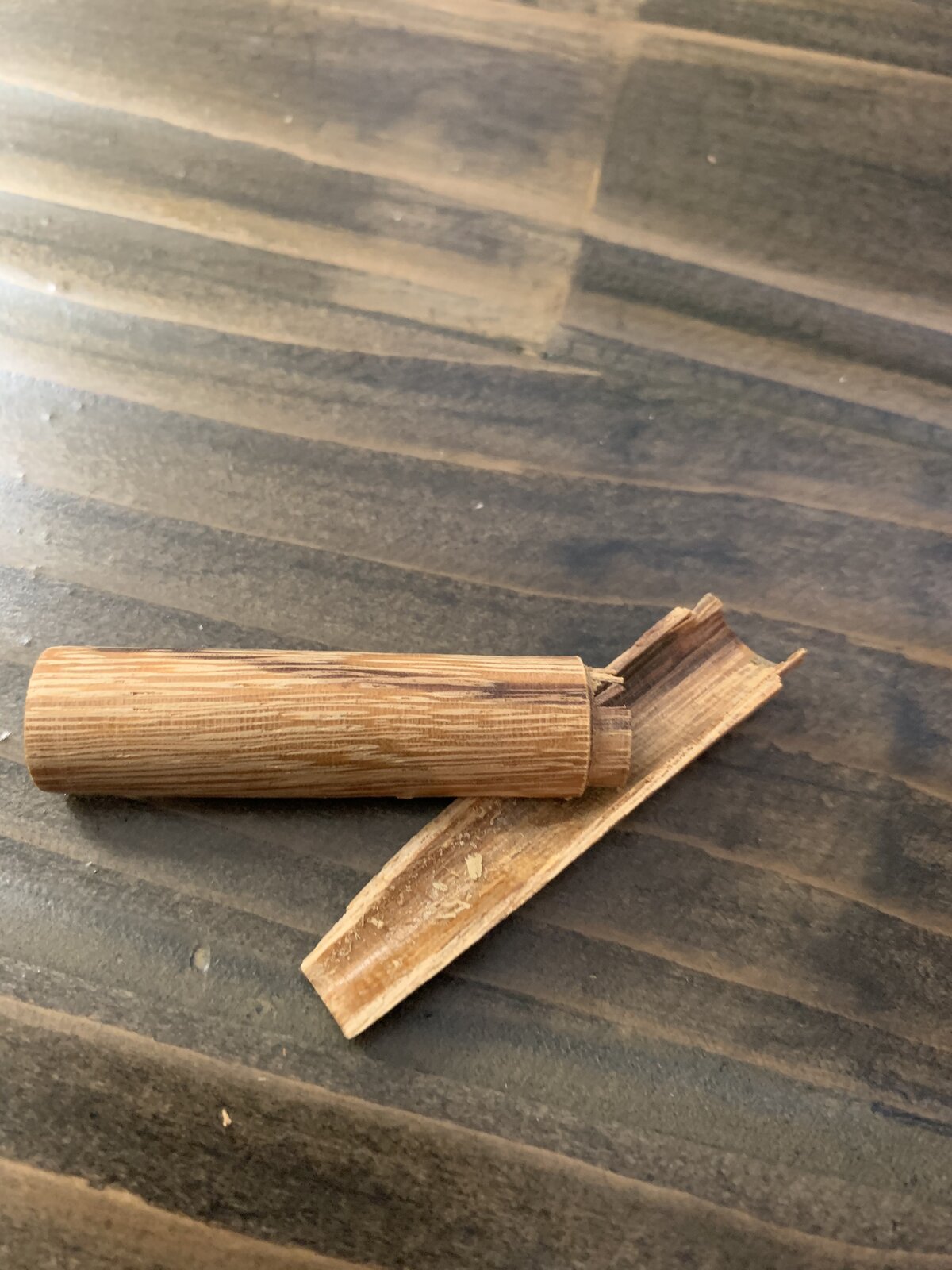

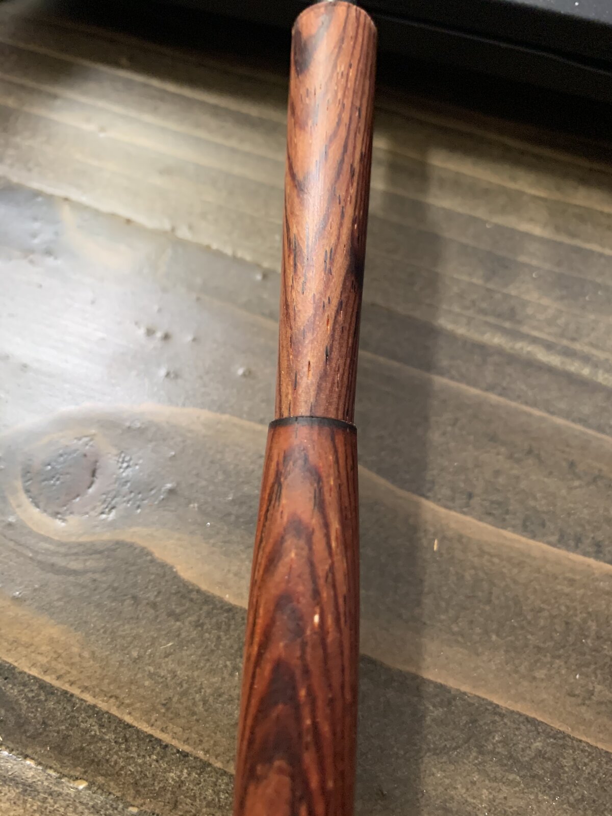

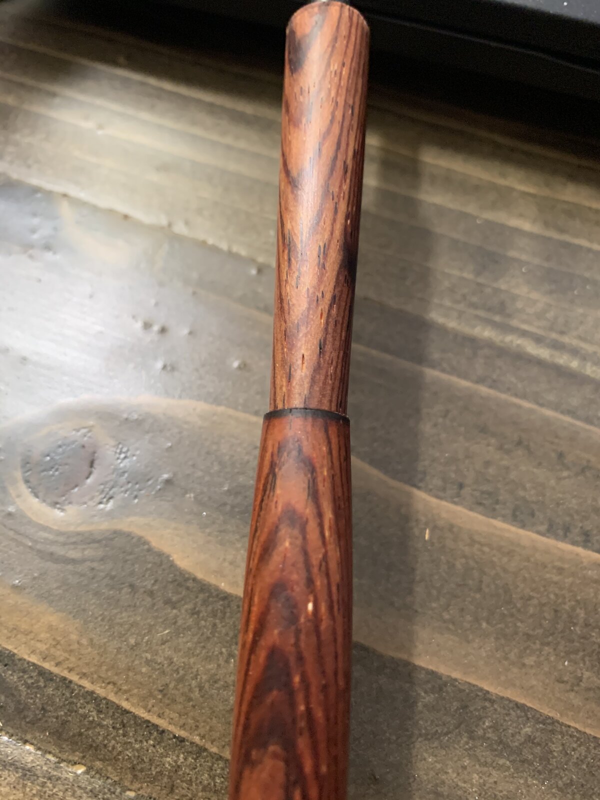

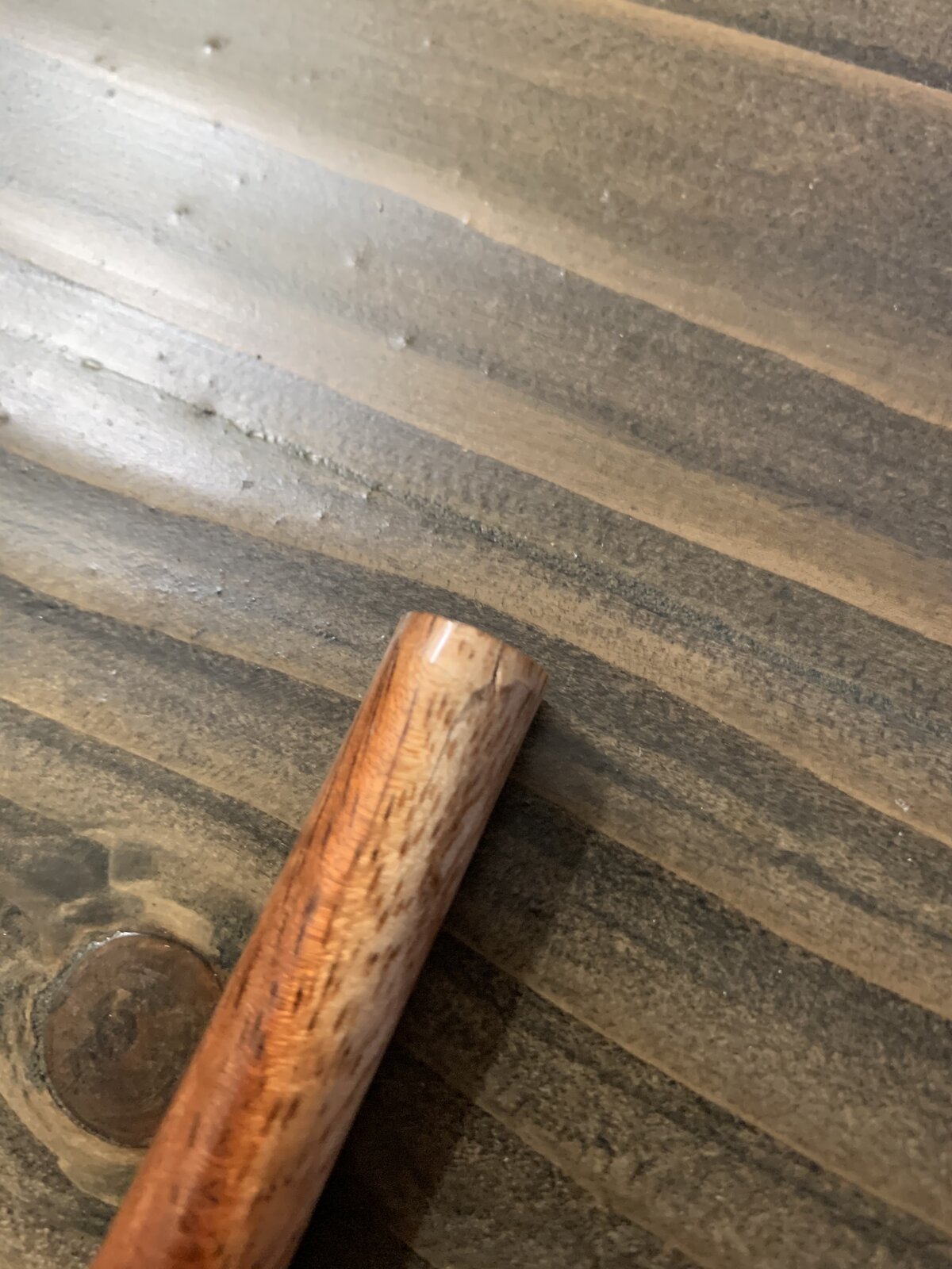

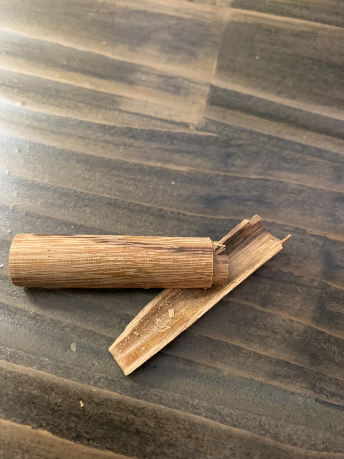

Just posting here to vent. Hit max frustration levels last night as I blew out a blank I was a couple turns away from finishing, cracked a blank I had completed with a nice finish when trying to assemble, and turned a blank to find capillaries, really don't like the look, and will prob scrap.
Can't win em all. Only my second blow out so I'll chalk it up to me being overdue.
pictures included in case you want to join me in my sorrows

Sorry to see your turning failure. All of us know and share your pain.
Have you considered changing from CA glue to something else? CA can be brittle and lead to more failures. For my own pens, I use mostly polyurethane (original Gorilla Glue) or epoxy. I always let them cure overnight or longer.
What wood is it? The 2nd photo makes it look like marblewood or canarywood. Those woods can be challenging to turn. I have had similar failures with them just because of the way that the wood fails when turning it.

It was marble wood. It was pretty challenging to turn, even more challenging to drill to be honest.

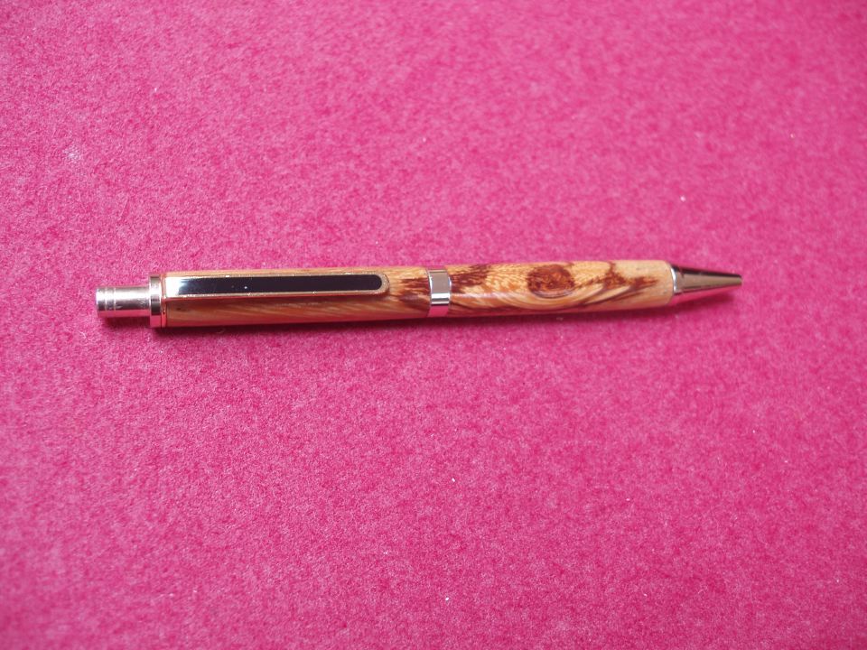

You are not alone with marblewood failures. I went back to my database and found various marblewood failures, too. They were some of my earliest pen making attempts:
Pen #2:
Wood: Marblewood - Kit: Slimline Gold - Insert Glue: CA Medium with Activator - Notes: Wood blew out.
Pen #5:
Wood: Marblewood - Kit: Slimline Gold - Insert Glue: Polyurethane - Notes: Wood blew out.
Pen #6:
Wood: Marblewood - Kit: Slimline Pro Gel Click Gold 24k - Insert Glue: Polyurethane - Notes: Forgot clip during assembly. Pen damaged by bad repair.
Pen #38:
Wood: Marblewood - Kit: Slimline Pro Gel Click Gold 24k - Insert Glue: Polyurethane. - Notes: (blank)
... and no, I don't keep photos of everything. I lucked out. I searched for "marblewood" and happened to find the record for #2 amongst other photos about my pen making process. Pen #38 happened to be nearby. After 3 failed attempts at marblewood, I kept that pen.
Photos: (1) Pen Making Record for Pen #2, above. (2) Pen #38 from marblewood.

I noticed that too. I used thick CA and made sure to twist it around when I put it in. That's what I do for all my blanks and haven't had this issue so I don't know what happened here.
Twisting, pushing straight in, it does not really matter, thick pulls in air and bubbles that form weak spots. Thin doesn't, but then thin does not fill in gaps. It is a dang if I do, dang if I don't.
It is a technique problem and I personally got tired of taking chances. I don't make a lot of pens, and most are simply one of a kind. I don't trust taking chances with glues and air bubbles on one of a kind blanks. The ONLY glue that will 99.99% avoid "void" spots is expanding polyurethane glues. Gorilla is the most common, but Gorilla makes other kinds of glues also, so don't confuse the other kinds with expanding polyurethane glues. Gorilla Clear is NOT expanding Poly glue.
There are Other Problems that can lead to this:
1. If your tool of choice is not sharp enough, the extra pressure in turning can lead to fractures;
2. If your feed rate is just a tad too much, the same thing can happen.
3. Combined with a glue void spot, either of 1 or 2 above, or both - with the void spot, can cause the blowout.

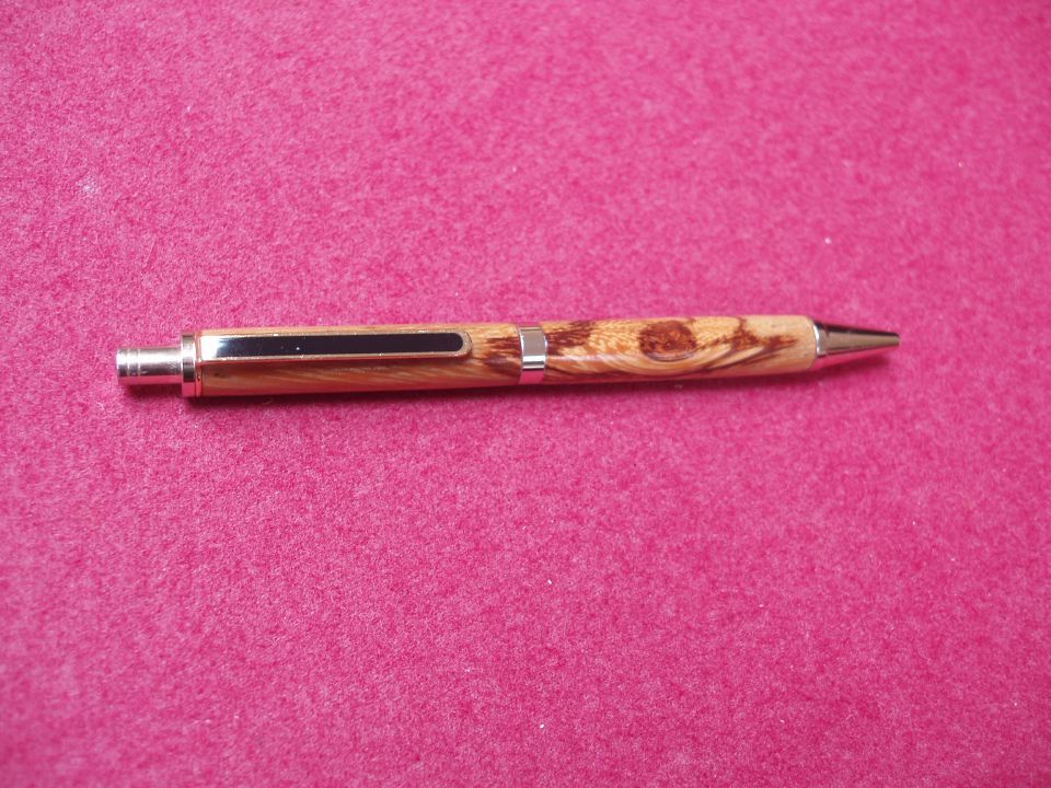

Pen #2:
Pen #5:
Pen #6:
Pen #38:
That pen looks great. I wasn't sure I'd even like the finished product but now I'm inspired. Luckily I bought a decent sized board of marble wood so have plenty of blanks left to cut if I want.

Thanks for the tips. Haven't had many problems with my current process but if it continues I'll have to explore switching it up
